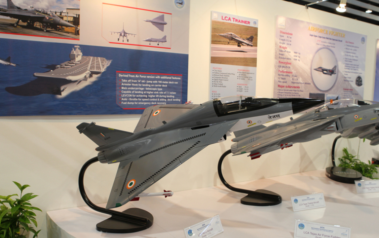

I am serious! Tejas at Singapore has tremednous export potential,in model form.There are zillions of aircraft enthusiasts around the globe who collect aircraft models amd collecting an authentic numbered Tejas models,"signed" by HAL,would become collector's items.The same can be mass produced in plastic/composites for the mases,"Airfix" style kits too.I'm sure that Hamley's would be interested as one sees so many Yindian shoppers in its flagship London establishment.I"m sure this can help cut down the hotel/travel bills for HAL's worthies, and the cost of the stall at the Sing air show!
As they say one must first walk before we can run.Let's export Tejas models first and then the bird when it evetually arrives!
