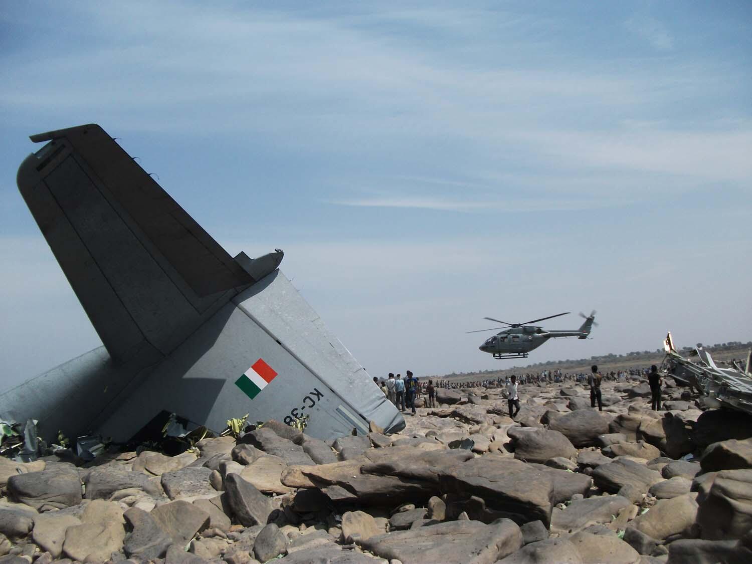

The saddest photos i've ever posted & hope it stays that way.
RIP Air Warriors
Source: https://twitter.com/ANI_news

As per my source(s) KC-3803 is the downed bird.
FYI:
KC-3802 (the 1st Hercules to be Officially Handed-Over to the IAF during a Ceremony at Marietta on December 16th 2010) was the static a/c at Aero India 2011
KC-3806 was the static bird at Aero India 2013

From pictures it looks like it landed turtle and tail breaking off as it touched down. Rest of the body skidded some distance before burning to charcoal.
Some time back US also saw spate of C-130 accidents involved in firefighting. Reason was weak link at the center body where wings are attached. Due to fatigue that part gave away.
US was said to have fixed that after C-130 were grounded for some time. We are exhaustively using these planes since they were inducted, who knows which part gave away.

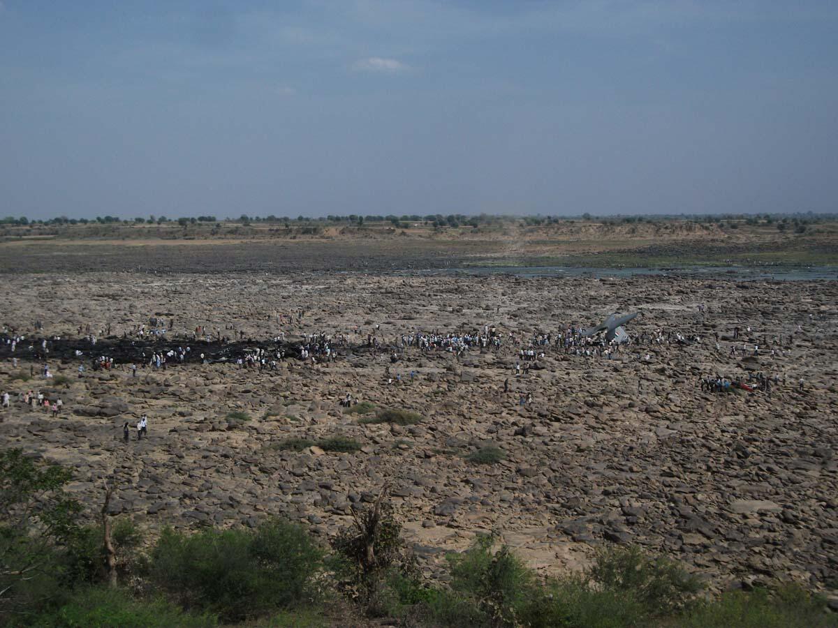

Some news reported the plane hitting a small hill while doing a low level tactical flying excercise.
Posts: 2583
Re: Military Flight Safety
Given that these C-130Js were for special ops primarily, they probably were conducting low-level ingress exercise and may have hit or tried to avoid a power transmission line or some obstacle that wasn't on the maps.
Posts: 34852
Sid wrote:From pictures it looks like it landed turtle and tail breaking off as it touched down. Rest of the body skidded some distance before burning to charcoal.
I gather that this part is being replaced after a fixed number of hours and also the same may be made in India by the OEM
srin wrote:Given that these C-130Js were for special ops primarily, they probably were conducting low-level ingress exercise and may have hit or tried to avoid a power transmission line or some obstacle that wasn't on the maps.
Low-level does not mean that transmission-line-low-level.

^^^indranil - it could be high tension wires which are at considerable height from the ground. But you're right - that would too low for a transport aircraft. Though, fighters like Jaguar practice at that level.
Posts: 19329
It would be a travesty if there were *any* such wires in the area where they practice.

This area is flat and underdeveloped.
Wires or hills seems unlikely cause.

Actually, given the flat terrain all around (as visible in the picture) I would not be surprised if it was a low level ingress/egress exercise. And any development at that altitude would have proved fatal with too little time to react. And it seems the plane when nose down first at a relatively shallow angle.
Actually, without knowing the speed of impact, it is difficult to say whether it was a shallow rate of descent. Actually going by the pictures, I think it was quite the opposite.
This is a very concentrated debri-field in terms of aviation accidents. Whats more I don't see any major structural parts left (except for the empennage). This is characteristic of a near perfect nose dive. The empennage is completely intact. In fact, its trailing edge shows no damage at all. I see light damage at the tip of the starboard horizontal stabilizer which probably was where the empennage made a singular contact with the ground making it turn turtle and coming to rest. This means that the tail did not have a large horizontal component.
So I believe that the last few moments of the plane was a complete nose dive.
