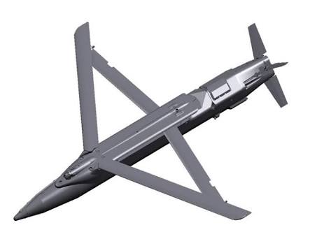

They are actually mentioning SDB-II, not SDB-I. Two companies mentioned are Boeing and Raytheon and there were failures during testing phase.Chinmay wrote:SDB analog has been tested. The claims of the SDB not being in service sound incorrect though. I assume the guidance is using IRNSS/GPS/GLONASS?India has actually taken a lead in the development and testing of its 'First Fully Indigenised' Smart Anti-Airfield Weapon (SAAW). Highly placed sources in the Union ministry of defence shared exclusively that the SAAW was successfully test launched from a Jaguar aircraft towards the fag end of first quarter of May by the Aircraft & Systems Testing Establishment (ASTE) in Bangalore.
Official sources revealed that the team comprising officials from the Indian Air Force and Defence Research and Development Organisation (DRDO) had come to Jaisalmer for testing SAAW twice in the beginning of this month but had to abort the mission due to technical reasons. SAAW has been developed by DRDO for the IAF.
It is to be mentioned that with the development of this weapon, India has reached a platform higher than any other country since even the United States of America, the only other country in the process of developing these kind of precision-guided glide bombs has failed to successfully test the same.
These Small Diameter Bombs (SDB) with a weight of 110 kgs being developed by US were though scheduled to enter production about two years back, could not be kicked off despite two different companies being entrusted with the development in two different phases.
Israel being yet another country as per the sources, which intends to sell these smart bombs and is already into marketing the same, interestingly is also yet to taste success in these weapons.

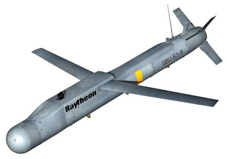

So per sources, SPICE (SDB)-250 which was offered to Indian forces is yet to taste success in bagging any contract.“That 28-launch programme will take us probably at least nine months, so we’re looking at third quarter of 2016 before operational testing will begin,” says SDB II program director Jim Sweetman in an interview with Flightglobal.
Albeit, it is very interesting to note that they are comparing SAAW to SDB-II and SPICE variety. SDB-II and SPICE are noted for attacking moving targets. Or, it could be a family of such small diameter glide weapon.
I don't think SAAW and the Small Desi Bomb are related anyhow. An anti airfield weapon would require sub munitions to take out runways and hangars, the Small Desi Bomb seen above seems like a monolith warhead and body, unless they have adopted the Matra Durandal approach with SAAW. I think SAAW, considering it's weight and range, is more like a smaller unpowered MBDA Apache. I would expect the SAAW to have GPS/INS guidance but no seeker, as the airfields don't move.indranilroy wrote:Thakur_B, great find! I don't think I had read about SAAW before. These certainly look related. Basically it is India's Spice-250 equivalent.
Probably SAAW is an anti-runway munition like Matra Durandal ... but with a stand-off range when delivered from an aircraft (or delivered from inside a warhead like shown on Prithvi). It would need a booster at the end to penetrate concrete runways to certain depth. Maybe the Prithvi version wouldn't need a booster since the terminal velocity would already be supersonic.
Other types of warheads, like fragmentation, incendiary, bomblets, penetration, etc, would better suit general purpose un-powered Small Desi Bomb (SDB) either with MMW/IIR seekers or not. It doesn't need to be a specialized weapon like SAAW.

The reason to keep the requirements separate (despite efforts form Lockheed and Raytheon to merge requirements) was to build up inventory and have an affordable weapon, mass produced in the 2000's. Boeing is likely to produce close to 50,000 SDB I's by the time they shut shop (vs an original requirement of 22-24,000 (that was met by around the turn of the decade) the US will probably end up acquiring > 30,000 with the remaining going to FMS).
Overall the buff can be configured to carry over 100 SDB's, and the number is around 140 for the B-1.From memory, B-52 can carry 30 SDB in internal weapon bay, while single Su-30 can carry such load
The preferred load out with the heavy SDB presence is the F-15E (first platform to be cleared for it with a hypothetical max load being around 36 weapons) and SDBI combination that they can use for airfield stuff.
Given the missions in discussion (anti-airfield) the SDBI scope as defined in the program is:

Well it can be said this way, afterall these are requirements of US.brar_w wrote:Then there were also delivery deadlines that defined capability. SDBI was to complete delivery to the US programs (aprox. 24,000 weapons) before the first SDB II production batch contract was awarded (which it did) so the dev. and fielding timeline also played a role in what sort of capability went into the design.
But point is , these two products, SDB-I and SDB-II offer different set of capabilities. And if there is a product that combines the capabilities of these two is going to be much more capable. Judging by what is said about Smart Anti-Airfield Weapon so far, combines the smartness of SDB-II and the deep penetrating capabilities of SDB-I.
SDB-I
SDB-II
SAAW would probably be more like SDB-1 without seeker while the other SDesiB would be more like SDB-II with a seeker.
SDB-II
