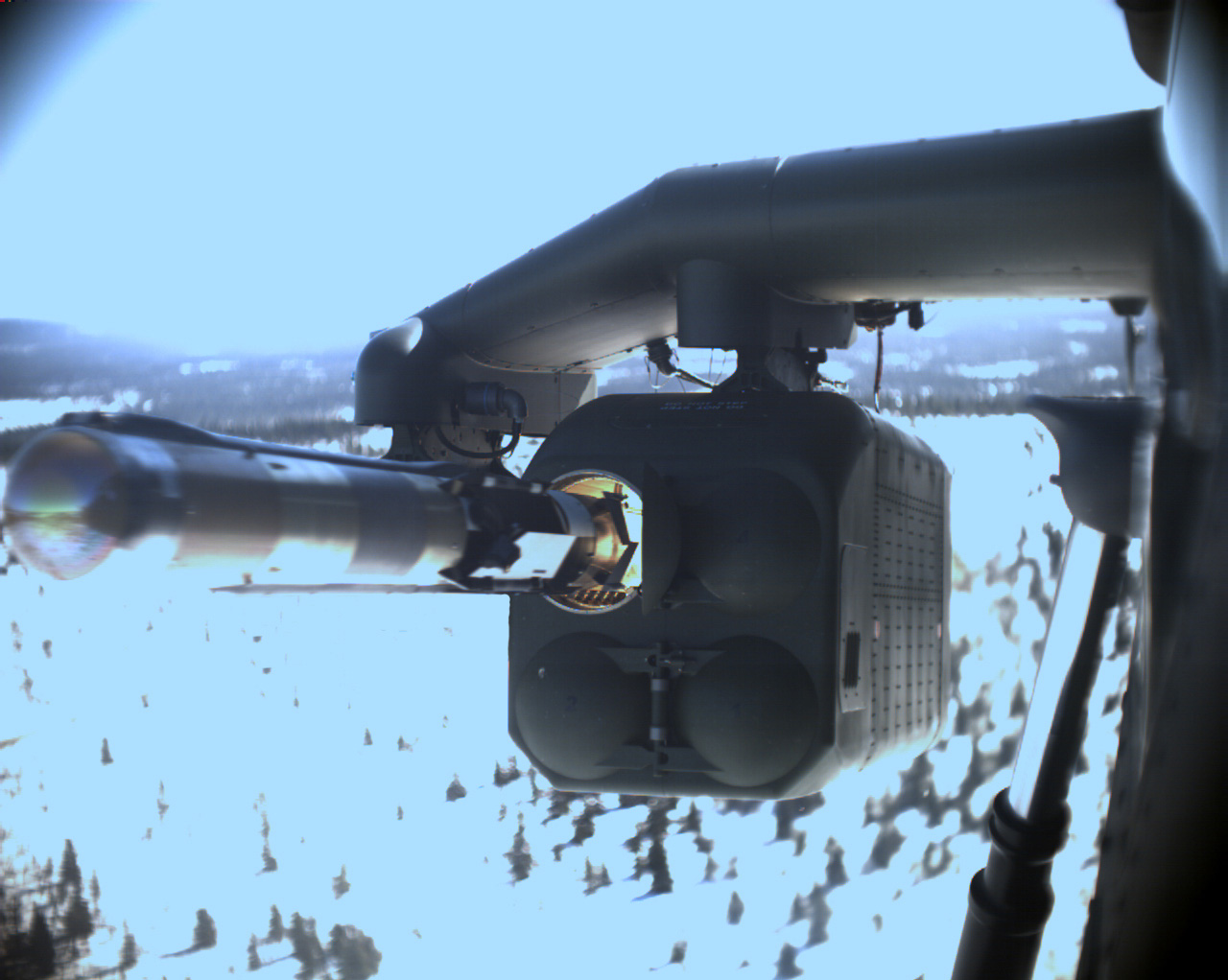

That picture is going to be my wallpaper for some time.Sancho wrote:

Sorry my mistake, it can carry 8 in total (4 x 2), while LCH can carry quad launchers at the inner hardpoint and at leas twin launchers at the outer, so a total of 12, possibly 16.indranilroy wrote:Also, I don't understand, why the booms on Rudra can carry only 4 Hellfire in total? It should be able to carry same amount as LCH can carry, i.e. 4X2
LCH can carry more, since it has different payload and weight limitations, especially with the new stubwings. The light stubwings of Rudra can't take such loads, that's why I asked if LAHAT wouldn't be the better choice?

Thanks to the inactivity of MoD, IAF and IA has evaluated ATGMs separately, although the possible options are the same:indranilroy wrote: Very interesting. Can you please substantiate this part. I would love to know the quad launcher part.
Pars 3 by Germanys Diehl BGT
http://4.bp.blogspot.com/-mGQi4LQz-C0/T ... S-3-LR.jpg
Spike ER by Israels Rafale
http://www.flightglobal.com/assets/getA ... emID=13269
http://img144.imageshack.us/img144/3599/dscn0952v.jpg
And for the long shot our own HELINA
http://livefist.blogspot.de/2012/03/def ... elina.html
Some reports suggested Hellfire is on offer for our combat helicopters as well, however it's not clear if they were evaluated as well.
No matter which missile will be chosen the can be configured with 4 or just 2 missiles on the launchers, the limitation here is the weight that the hardpoint can carry. That's why I said, depending on what the weight limit for the outer hardpoint of LCH is, it might carry 2 or even 4 more missiles on each stubwing.
LAHAT missiles on the other side are available with quad launchers as well, but weigh much less compared to the above mentioned ATGMs, that's why Rudra could carry twice the number of LAHAT and why I would prefer these in the fire support role.
Rudra then would be a more cost-effective hi low mix, next to LCH / Apaches with dedicated ATGMs.
http://upload.wikimedia.org/wikipedia/c ... -LAHAT.jpg
Of course LCH was designed to carry more, but how much more remains dependent on the weight limits of each hardpoint. The stubwings of Rudra doesn't seems to be very strong from a structural point, not very aerodynamic either.indranilroy wrote: I don't think the right way of thinking is that LCH can carry more because it's stub wings can carry more. The right way of thinking would be that the stub wings of LCH were designed to carry more because LCH can carry more (because of lower empty weight).
