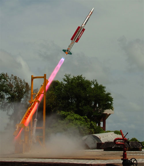

Prasan wrote:Some info of Astra BVRAAM
http://trishul-trident.blogspot.in/2013 ... a.html?m=1
Significant differences in aerodynamic configuration. see the poster and the model. Seems like a redesigned nose and fin arrangement. which is newer? the model or the poster?

Re: Indian Missiles and Munitions Discussion
I feel the new astra is like the model, has lost its huge midbody fins and general clone of 530d look.
the photo of astra test floating around in various crop sizes and even mirror rotated is different versions of a single photo which might be of the old model in 2011
http://3.bp.blogspot.com/-haeIz3PWWEg/T ... sile_1.jpg
apart from better solid fuel , smaller warhead, lighter sensor and electronics, lighter 787 aerospace certified Li-Ion battery from Yuasa corp :twisted: , the airframe might be nearly fully composite now...
