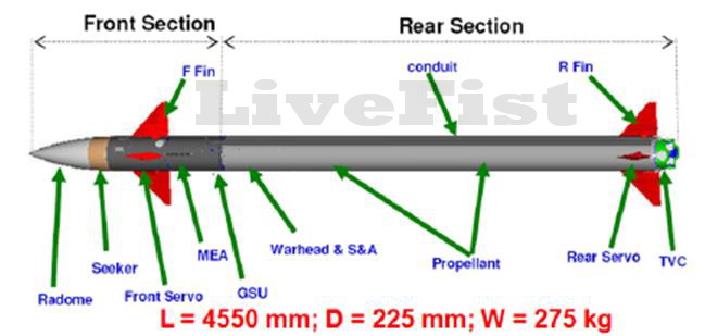

LRSAM http://1.bp.blogspot.com/_o_no4M2xEPY/T ... 783236.jpg
The fins are small enough for it to be a large missile like P-II. Hence could be in the category of Lakshya, Banshee or AAM/SAM. Lakshya and Banshee do have tail which are longer and only one. While this got multiple fins of similar sizes. Also the tail of those target drones, don't end like this one. Not Astra because tail fin is different. perfectly matches with the LRSAM's tail fin.
Alzo Barak not that small mijjile.. http://www.bharat-rakshak.com/media/413 ... jjiles.jpg

The dead giveaway of a Prithvi is the braided metal hose used to carry propellant and the small multiple liquid propellant motors both apparent in ANI Twitter photos. Only Prithvi has multiple liquid propellant motors. Refer image posted by Shiv here http://www.indiastrategic.in/image/Prithvi_missile.jpguddu wrote:LRSAM http://1.bp.blogspot.com/_o_no4M2xEPY/T ... 783236.jpg
Solid fuelled missile dont have thick braided metal hose - check the LRSAM cutaway posted by you.
The smaller fins are rear fins at base of Prithvi, also apparent at in Shiv's photo.
