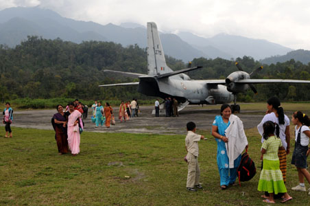

This is Vijayanagar ALG for you -
3. The troop level in DBO sector is very low - not more than a battalion strength worth IMO. These troops are maintained out of Leh and Thoise by helicopters like ALH and Mi-17.
4. The use of ALG is in the period short of war - when it is used to bring in troops and equipment and ammunition. As was the case of Chusul ALG in 1962. It was used to build-up troops and attendant supplies in the area. The troops of AMX-13 tanks were carried to Chusul by AN-12 from Chandigarh.
5. Having said that, the ALG needs to be prepared for the intended role. Vivek_Ahuja us bang on the money about even couple of flights damaging the runway and making it non-operational. Here is an extract about Chusual airstrip in 1962 (from history of Corps of Engineer):
Prior to hostilities, the airstrip at Chushul was used at the leisurely pace of one aircraft a day. During the hostilities it was subjected to six An-12s and about eight packets daily and became unserviceable frequently. Its daily maintenance need rose to 4 tons of RC3 bitumen an item then it acute shortage… By November 13, 95 An-12s and 57 Packets had landed at Chushul airstrip, the PSP Sheets of which, protesting under the strain, kept disintegrating. At the same time, the siting of Avantipur and Chushul airstrips were undertaken, while the Thoise airstrip became operational when two Packets, carrying plant and machines landed successfully.
6. I feel the ALGs in relative hinterland at Nyoma and Fukche will be developed first into something which can take load of sustained operations. DBO will follow when GOI is ready to show some balls to the Chinese.
