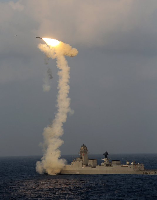

Livefist ‏@livefist 1h1 hour ago
You beauty. BrahMos fired from @IndianNavy P15A destroyer INS Chennai at #TropEx2017.
11:38 AM - 6 Feb 2017
