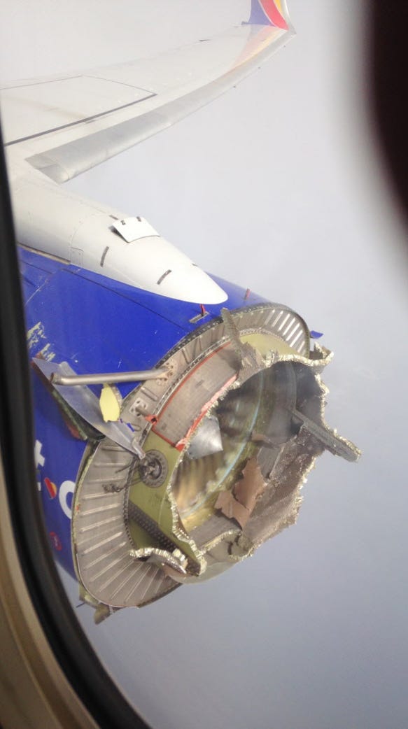

‘Uncontained’ CFM56-7 Failures: Southwest B737-700s 27 August 2016 & 17 April 2018
The US National Transportation Safety Board (NTSB) has issued a press release, in advance of a preliminary report, on a occurrence to Boeing 737-700 N766SW operating Southwest Airlines Flight 3472, from New Orleans, Louisiana to Orlando, Florida on 27 August 2016.
A second, seemingly very similar event occurred to N772SW operating Flight 1380 from New York-La Guardia, NY to Dallas-Love Field, Texas on 17 April 2018. In that case debris penetrated a cabin window aft of the wing and one passenger is confirmed to have died (early reports suggest they had been partly sucked through the window). This was Southwest’s first passenger fatality ever and the first Part 121 fatality since February 2009.
The First Accident Flight 27 August 2016
One fan blade of the left hand CFM56-7B engine separated from the fan disc during the cruise. The root of that blade remained in the fan disc hub but the blade was not recovered.
The Second Accident Flight 17 April 2018
The aircraft departed at 09:43 and by 10:04 was passing 32,500ft when the no 1 engine failed. Debris impacted the side of the fuselage shattering a passenger window resulting in a loss of cabin pressure. The crew initiated an emergency descent, shut the engine down and diverted to Philadelphia, PA, landing at 10:19. It is reported that:
Consequently the entire left engine inlet separated from the engine, with debris damaged the fuselage, wing and empennage. A 5 x 16 inch hole was made in the fuselage just above the left wing and the cabin depressurised (though no engine debris penetrated the cabin).
The aircraft diverted to Pensacola, Florida and made a safe landing, 18 minutes later. None of the 99 passengers and 5 crew onboard were injured
The NTSB call this an uncontained failure, though it is not clear if the fan blade exited radially (the true definition of uncontained) or axially (i.e. forward). Either way, the out of balance forces resulted in an unexpected failure of the inlet structure.
Investigation Findings
The CFM56 fan blades are manufactured of titanium alloy and are coated with a copper-nickel-indium alloy at the root contact face.
Initial findings from the NTSB Materials Laboratory metallurgical examination include:
The fracture surface of the missing blade showed curving crack arrest lines consistent with fatigue crack growth. The fatigue crack region was 1.14-inches long and 0.217-inch deep, and
The center of the fatigue origin area was about 2.1 inches aft of the forward face of the blade root. No surface or material anomalies were noted during an examination of the fatigue crack origin using scanning electron microscopy and energy-dispersive x-ray spectroscopy.
The NTSB subsequently confirmed that the woman, seated in seat 14A, had died. Seven others were treated for minor injuries. There were 5 crew and 143 passengers on board.
Engine nacelle damage was very similar to the earlier incident with a released fan blade and loss of the nacelle intake. Additionally the outer fan cowl door separated and the inner door was badly damaged and open. Leading edge damage was also evident on the left wing.
The engine “had 40,000 cycles on it, a quarter of those since it was overhauled” said Southwest CEO Gary Kelley.
The CFM56 family has achieved more than 350 million engine hours and powers around 6,700 aircraft worldwide.
UPDATE 18 April 2018: Video of on scene NTSB press conference 17 April 2018 by NTSB chairman Roger Sumwalt.
The CVR and FDR have been returned to Washington and the CVR has already been downloaded.
Cowling debris has been located at Bernville, Pennsylvania, about 60-70 miles west of Philadelphia.
The crew elected to land with the flaps at 5 degrees (rather than 30 or 40) at a higher approach speed due to concerns of potential controllability issues.
The NTSB have started that blade 13 (of 24) failed “at the hub” and there was evidence of fatigue.
The NTSB say Southwest plan an accelerated ultrasonic inspection programme.
Sumwalt praised the crew. The Captain is reported to be a former US Navy aviator.
UPDATE 19 April 2018: The NTSB say blade broke in two places: “near where the blade meets the engine hub” and halfway along its length. An “internal crack likely caused the break near the hub, which then caused the mid-blade facture”. The NTSB say the FDR showed that as left hand engine ran down, vibration increased significantly and the cabin altitude alert sounded shortly afterwards indicating the cabin pressure had exceeded a pressure equal to 13,500-14,000ft altitude. The aircraft also made a rapid uncommanded roll to 41.3º left bank. The NTSB released pictures of the nacelle debris.
The damaged engine and the aircraft
The Ex navy fast jet pilot Tammie Jo Shults captained Flight 1380 to a Philadelphia airport in Tuesday's emergency
The damaged engine a CFM56-7B

jaan nikal gaya engine ka....way more damage than the tests prescribe.
and one blade did this...what if 3 had come off.
Posts: 34854
Singha wrote:jaan nikal gaya engine ka....way more damage than the tests prescribe.
In both cases, the damage is eerily similar. Is there some issue that is causing such specific damage that has not been caught or not accounted for during engine tests, maybe some parameter being missed, perhaps??
Southwest Airlines Flight 1380 suffered an uncontained failure of its left engine on Tuesday.
In August 2016, Southwest Airlines Flight 3472 also suffered an uncontained failure of its left engine.
Both engines are CFM56 turbofans and failed when one of its fan blades snapped off mid-flight.
The Southwest Airlines engine that failed last month allowed debris to puncture the Boeing 737-700's engine casing and fuselage, according to federal ... hole was found in the left fuselage just above the wing of Flight 3472, (Southwest Airlines Flight 3472)
This Saturday, Aug. 27, 2016, (Southwest Airlines Flight 3472), photo shows an engine through a window of a Southwest Airlines flight. The flight from New Orleans bound for Orlando, Fla., diverted to Pensacola, Fla., after the pilot detected something had gone wrong with an engine, according to a Southwest statement.
in 2010 a qantas flight suffered this devastating damage due to a rotor failure on A380
the australian govt found the rc to be some oil pipes not made to spec
https://www.atsb.gov.au/publications/in ... 0-089.aspx
I am supposed to fly next friday *dhoti shiver*
china eastern airlines, outbound from australia
so the front cowl of the engine needs to be way stronger to contain these singularities .... planes are being made to work hard with short breaks , people are always trying to shave weight and make things thinner ..... not a great combo

Looking at the pictures above (B737), though the events started by FBO, the fan containment case itself is not the culprit, its the Nacelle which fails to contain the damage. This is typically Aircraft OEM's component rather than the Engine OEM.
Interestingly FAA was working on issuing AD to enforce extra checks for fan blade root crack last year for all aircrafts with >15000cycles. Even before the AD became official one FBO happened with SW Airline, which had done only 10000cycles until then. Clearly the problem has been known and was not fully understood. FAA and CFM will have to do better. Also Boeing, I suppose.

^^AFAIK, current nacelle (including cowling I think) & Thrust reverser systems are supplied by separate OEM and are not from Aircraft OEM. Current commercial aviation nacelle systems are dominated by UTC Aerospace (Formerly Goodrich Aerospace Systems) & Safran Nacelles (formerly known as Aircelle). Again, AFAIK, FBO condition needs to be shown compliant...don't know the details about how many simultaneous blade out events are allowed and under what conditions etc.

Singha wrote:so the front cowl of the engine needs to be way stronger to contain these singularities .... planes are being made to work hard with short breaks , people are always trying to shave weight and make things thinner ..... not a great combo
were such events common in the 80s and 90s ... i dont recall these kind of incidents ....
The wiki page about uncontained engine failures seems to support your hypothesis that these are more common now.
https://en.wikipedia.org/wiki/Turbine_e ... _incidents
The United 232 crash in 89 is very famous. But there seem to be too many such incidents since 2010 onward. Of course that may be simply because of a large increase in commercial aircraft traffic since then.
This one in particular is scary: American Airlines Flight 383 (2016)
The right engine suffered a sudden rupture of the stage 2 disk operating at takeoff power. The disk separated into two pieces, the smaller of which pierced the wing's fuel tank and then flew 2,935 feet (895 m), falling through the roof of a United Parcel Service (UPS) facility and coming to rest on the building's floor. No UPS employees were injured.
The right hand side of the fuselage suffered considerable fire damage, and the right wing collapsed about midway along its length. American subsequently declared the hull a loss.
The only reason the passengers survived was because it happened during takeoff and the pilots could abort it successfully. If this happened in flight the aircraft would have probably banked uncontrollably to the right and nose-dived to the ground with no hope of recovery.

Zynda wrote:^^AFAIK, current nacelle (including cowling I think) & Thrust reverser systems are supplied by separate OEM and are not from Aircraft OEM. Current commercial aviation nacelle systems are dominated by UTC Aerospace (Formerly Goodrich Aerospace Systems) & Safran Nacelles (formerly known as Aircelle). Again, AFAIK, FBO condition needs to be shown compliant...don't know the details about how many simultaneous blade out events are allowed and under what conditions etc.
Of coarse its made by some supplier and even designed perhaps. When I say OEM, its the org which is considered OEM from regulatory perspective and responsible for the part for Certification.
We make engine parts, we own the design completely, but we are not OEM. HAL makes Su30 from raw materials but not cobsidered OEM for Su30. And so on....

Results of investigation of recent 737-300 and CFM-56 engine accident are given in news below. Its confirmed that it was fan blade fatigue failure (no surprises there)
NTSB finds fatigue cracking on Southwest CFM56-7B failed blade
https://www.flightglobal.com/news/artic ... fa-448321/
Investigators released pictures of the engine, the Boeing 737-700 involved in the incident and the failed blade, which they say shows metal fatigue near the leading edge of the blade's convex side.
The fatigue area is about 5.7cm (2.2in) long and 1.2cm deep, running "through the thickness" of the fan dovetail, says the NTSB in a 3 May investigation update.
"The number 13 fan blade had separated at the root; the dovetail remained installed in the fan disk," the update says. "Examination of the number 13 fan blade dovetail exhibited features consistent with metal fatigue initiating at the convex side near the leading edge."
"Fatigue fracture features emanated from multiple origins at the convex side," it adds.
In addition to the fan blade failure, the engine inlet and cowling separated and struck the wing and fuselage, causing rapid depressurisation, the NTSB says.
Engine pieces significantly damaged the leading edge of the left wing, fuselage and horizontal stabilizer. The incident killed one passenger – the first passenger fatality on a US airline since 2009.
The failed engine's fan blades had been overhauled 10,712 cycles prior to the incident, in November 2012, the NTSB says, citing maintenance records. At that time, maintainers inspected the blades visually and using "fluorescent penetrant", says the NTSB.
The engine's blades had logged 32,000 cycles since new, and inspections conducted after the incident revealed no cracks on other blades, the NTSB says.
The design method failed to predict the fatigue crack growth to failure, correct inspection interval and proper inspection methodology. I am sure the design methods today are already much more advanced. This blade must be designed in late 80s-early 90s.
