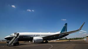

Note the new high bypass repositioned engines on the 737 Max
737 Max.
737 Classic
737 was made to fly with Turbojet engine for its time but as soon as it started moving to high bypass turbofan engine with larger fan diameter they had issue with ground clearance and had to work with all sort of tricks to solve the issue.
The 737 Classic looks more to me like NG model
i guess that explains why A320 which is taller has a round engine cowl and 737 have flattened bottom of circle.
I used to think it was some hifi american "stealth" thing going on.
some engines have sine wave type trailing edge rim at the backside ...apparently to reduce noise.
