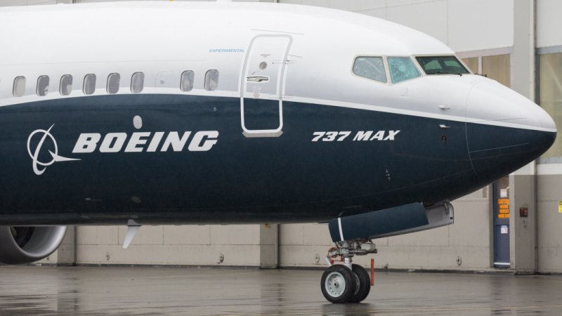

There are lot of issues that went wrong with max:
- A unstable design due to new engines that causes the nose to pitch up due to changes to its aerodynamics.
- MCAS software that implemented as a poor work around to fix this flaw and to receive a quick certification.
- MCAS relying on single sensor and airlines have to pay extra for indicators to show a AoA sensor conflict.
- MCAS being far more aggressive in combating the stall than documented to FAA ( this could be bad for FAA for failing to catch it and Boeing).
- Boeing not properly alerting pilots on it and insisting no additional training is requiring in order to compete against Airbus.
- Boeing failure to quickly ground all 737 max and ensure pilots are aware of this and know how to handle it after Lion air crash.
