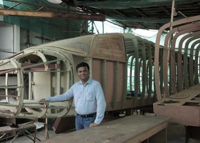

The continuing trials (of perseverance) of Cpt. Amol Yadav, to build his transport plane...
Sobering read...
Can you help this Indian make aviation history?
Sobering read...
'This project started with my mom mortgaging her mangalsutra.' 'I have been successfully keeping my dream alive by mortgaging my brother's house.'
If 15 million Indians decide to contribute just one rupee each, (yes you tread it right; just one rupee), Captain Amol Shivaji Yadav, who has built an indigenous six-seater airplane can finish the second mandatory test flight at 2,000 feet after which, in about six months, his company Thrust Aircraft Company can manufacture 100 airplanes in about an year.
If that wouldn't make aviation history in India by an Indian, what will?
"My dream of making airplanes in India, by an Indian, is at stake for me," says the 44-year-old ex-jet Airways pilot, who has built the TAC003 on the terrace of his house in Kandivali, north west Mumbai.
After spending more than 19 years to just get the permission to fly and about Rs 6 crore (Rs 60 million) of his and his family's hard-earned money, Captain Yadav is struggling to get another Rs 15 million to complete the 2,000 feet test flight by maneuvering the aircraft at that altitude as per Director General of Civil Aviation (DGCA) norms. "I just need about one-and-a-half crore rupees; if I have it, I will just go ahead and finish it off tomorrow," Captain Yadav tells Prasanna D Zore/Rediff.com when asked how prepared he is for this second test and the hurdle he needs to cross to do it.
How are you managing the funds? Is that a big challenge?
I have not been getting any funds. I have received nothing. I have received no help from nobody. As simple and straightforward as that!
How much have you spent on your first test flight?
We have spent about Rs 6 crore till today, together. It's all my money, my family, my friends.
No help from either the state government or the Union government?
Nobody has helped yet, except three gentlemen: one Mr Dinesh, Mr Kamlakar and Mr Lalit Kale.
If you want to contribute towards helping an Indian create aviation history, you can contact Captain Amol Shivaji Yadav at 9320032733.

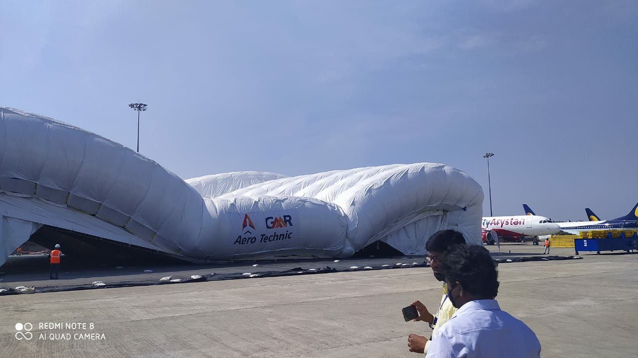

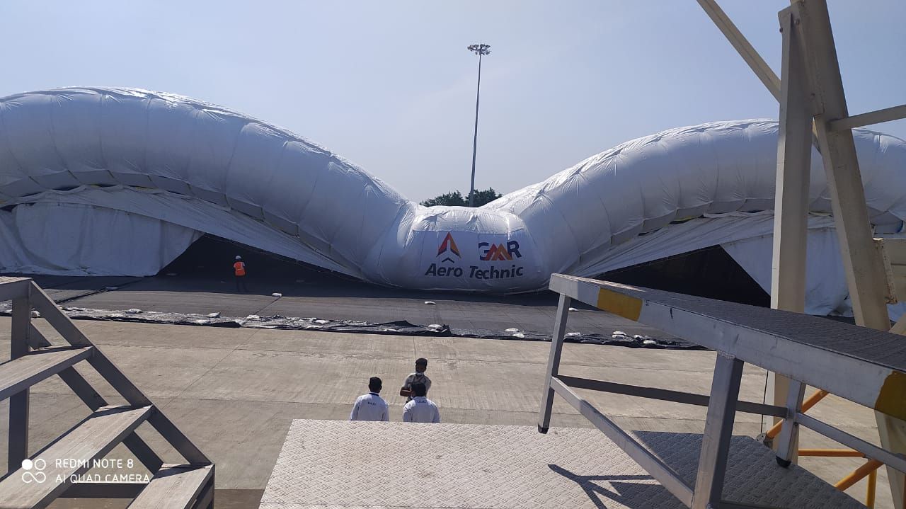

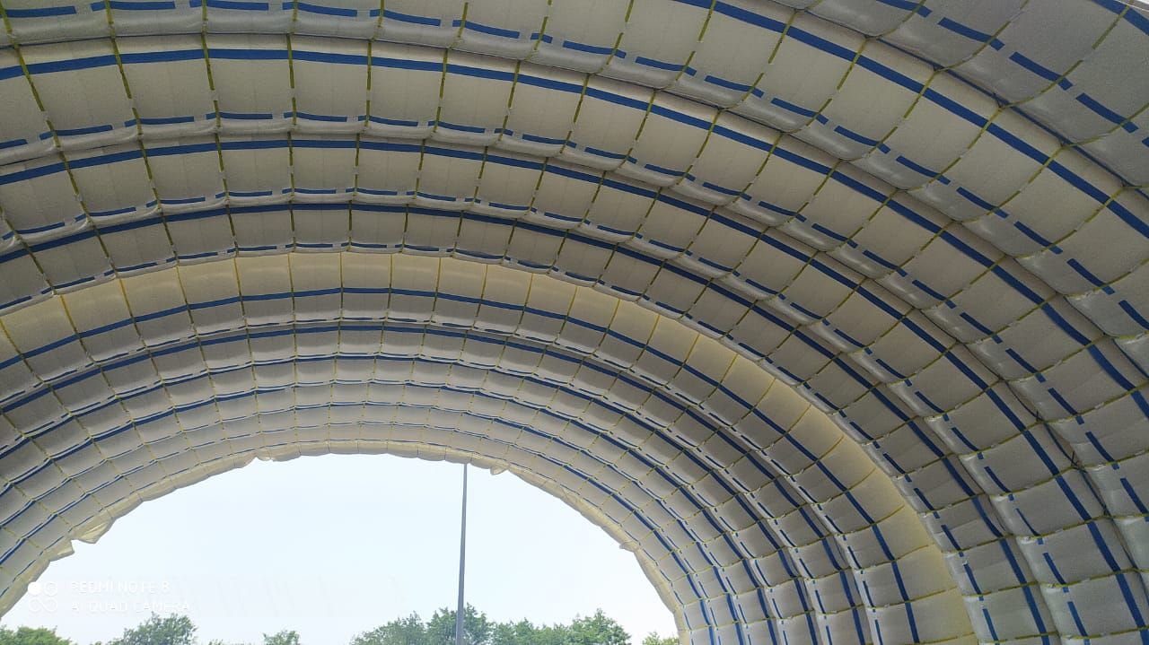

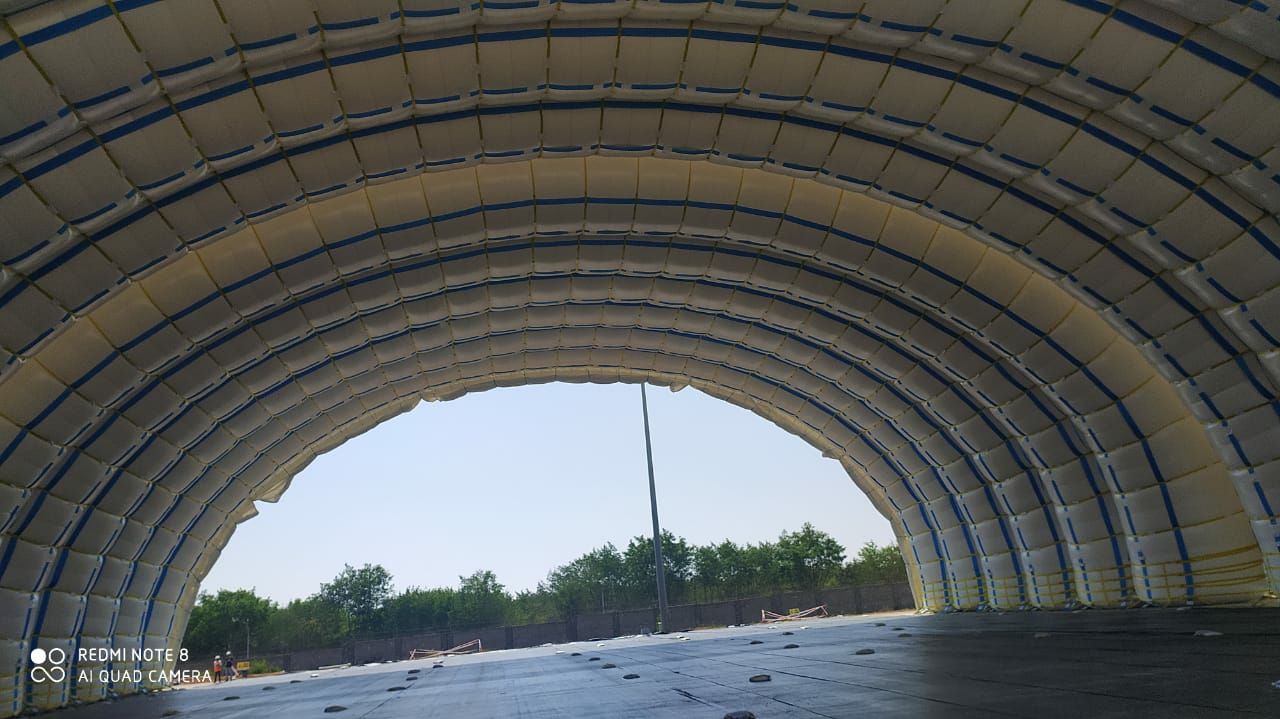

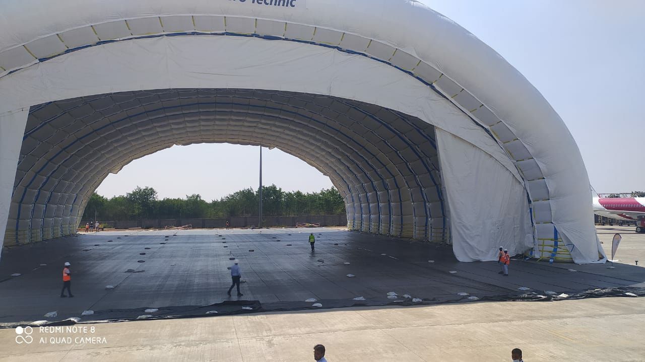

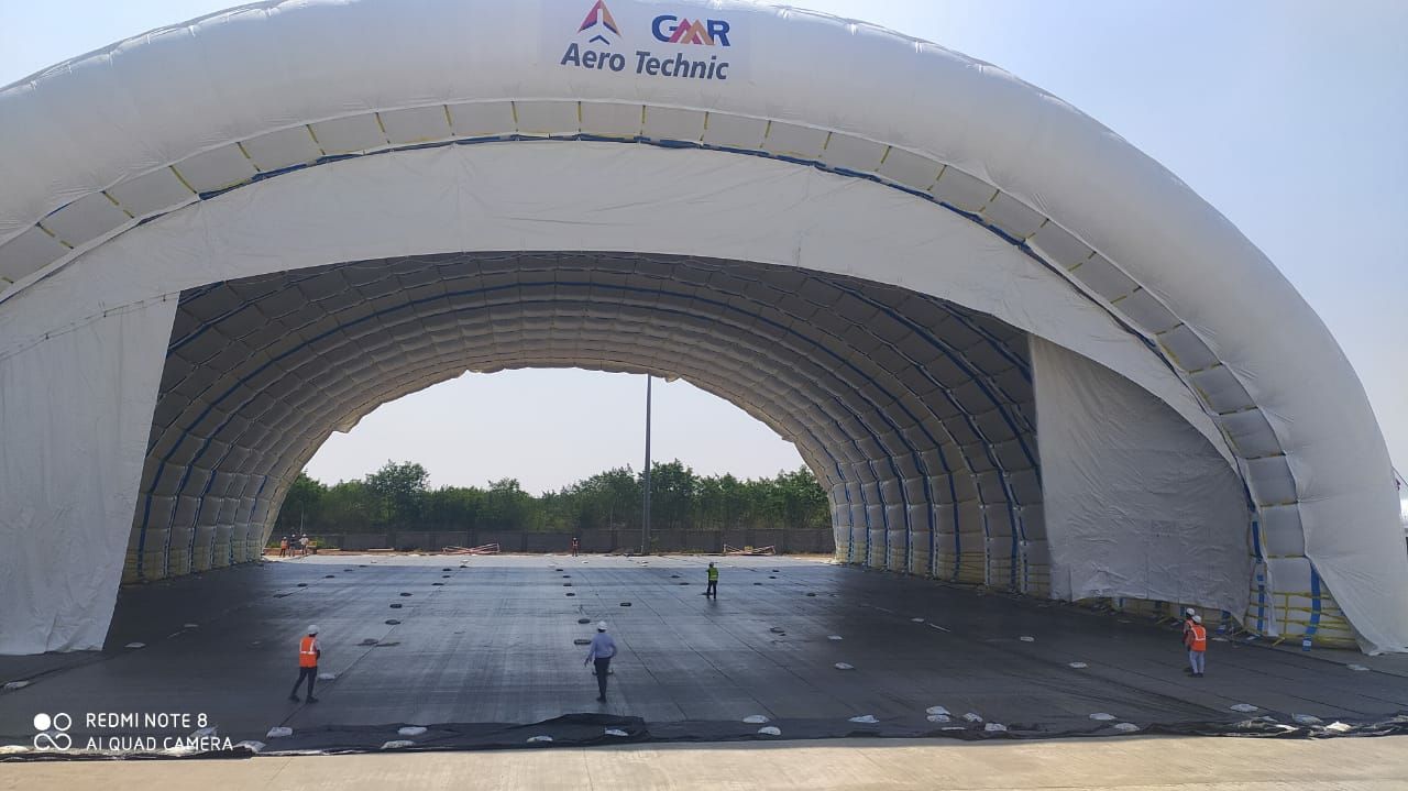

https://twitter.com/ReviewVayu/status/1 ... 15299?s=20 ---> WONDERFUL!! India gets first Inflatable Hangar.
The 1st of its kind in India was commissioned at GMR Aero Technik's MRO facility at Rajiv Gandhi International Airport on 12 Feb. The Hangar H-45 is suitable to store two narrow body aircraft such as one A320 NEO & one B737-900.
https://twitter.com/ReviewVayu/status/1 ... 28960?s=20 ---> The hangar has been manufactured by Buildair Inflatable Structural Solution of Spain. Buildair hangars come in five sizes - H-20 measuring 20 meters, H-35 measuring 35 meters, H-45 measuring 45 meters, H-54 measuring 54 meters and the largest H-75 measuring 75 meters.

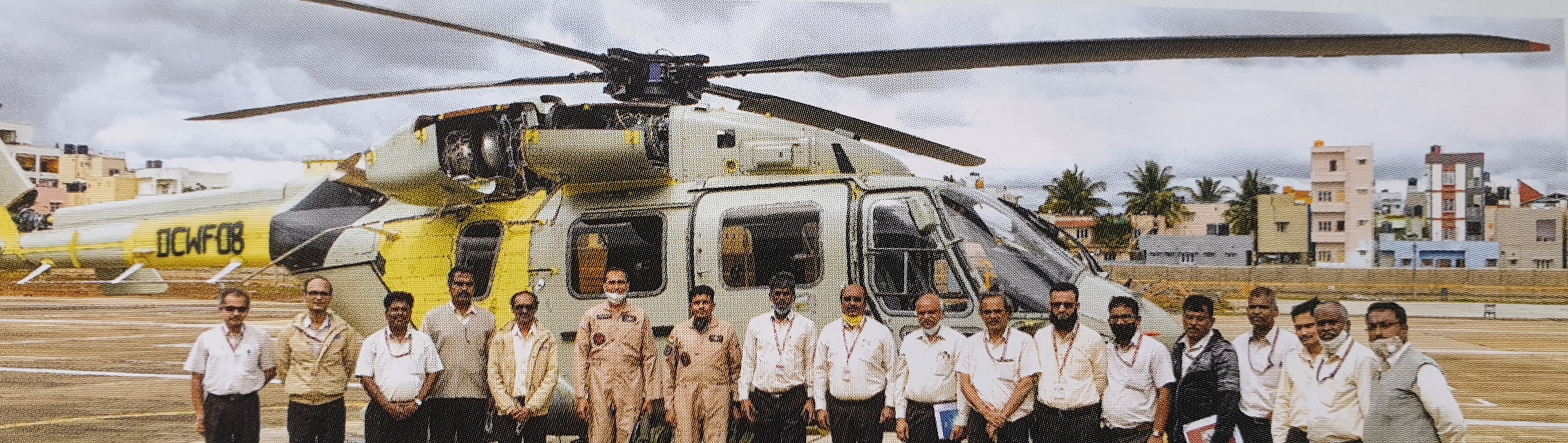

HAL should sell a civilian version of LUH...
WOW helicopers are super cheap already -- https://internationalaviationhq.com/202 ... licopters/ !! there are so many <$1million helicopters!!
an affordable twin-engined plane or a helicopter under 10 crores - indian private aviation will take off IMO...
