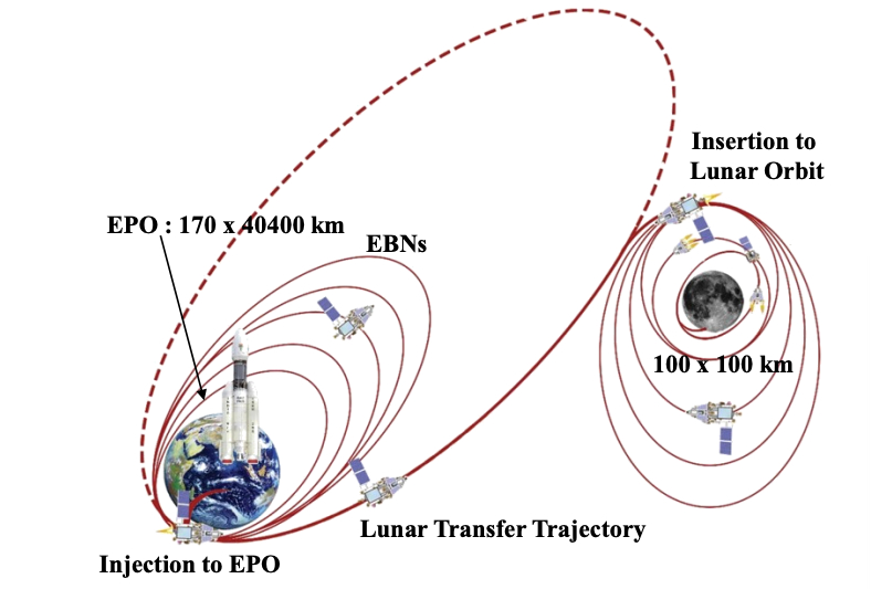

And good infographics, for example:this region of the moon hides a dense metallic mass estimated to be 4.8 quintillion pounds. Right, that’s 4,800,000,000,000,000,000 pounds — all zeros included.....
...Now comes the trickiest part of the mission. After the module arrives in the 100 km orbit, the lander will separate from the orbiter, which will continue to revolve around the moon. A separate entity now, the lander will de-boost with the firing of its four breaking engines. This manoeuvre will bring it to a periapsis of around 18 kilometres. When the lander reaches this point, that is at the height of 18 km, the onboard position detection camera and hazard avoidance sensor study the landing site for accuracy. Using the data obtained, the lander will autonomously determine the trajectory it will have to take to get to its pre-determined landing site, and steer itself to a location 100 metres above the site.
Here, the lander will hover and allow the hazard avoidance sensor to determine the safest landing point. Then, it will be guided to this point and at the height of 2 metres above this location, the thrust will be cut off and the lander will go into a free fall to the impact point with the landing legs attached to it absorbing the impact shock.
