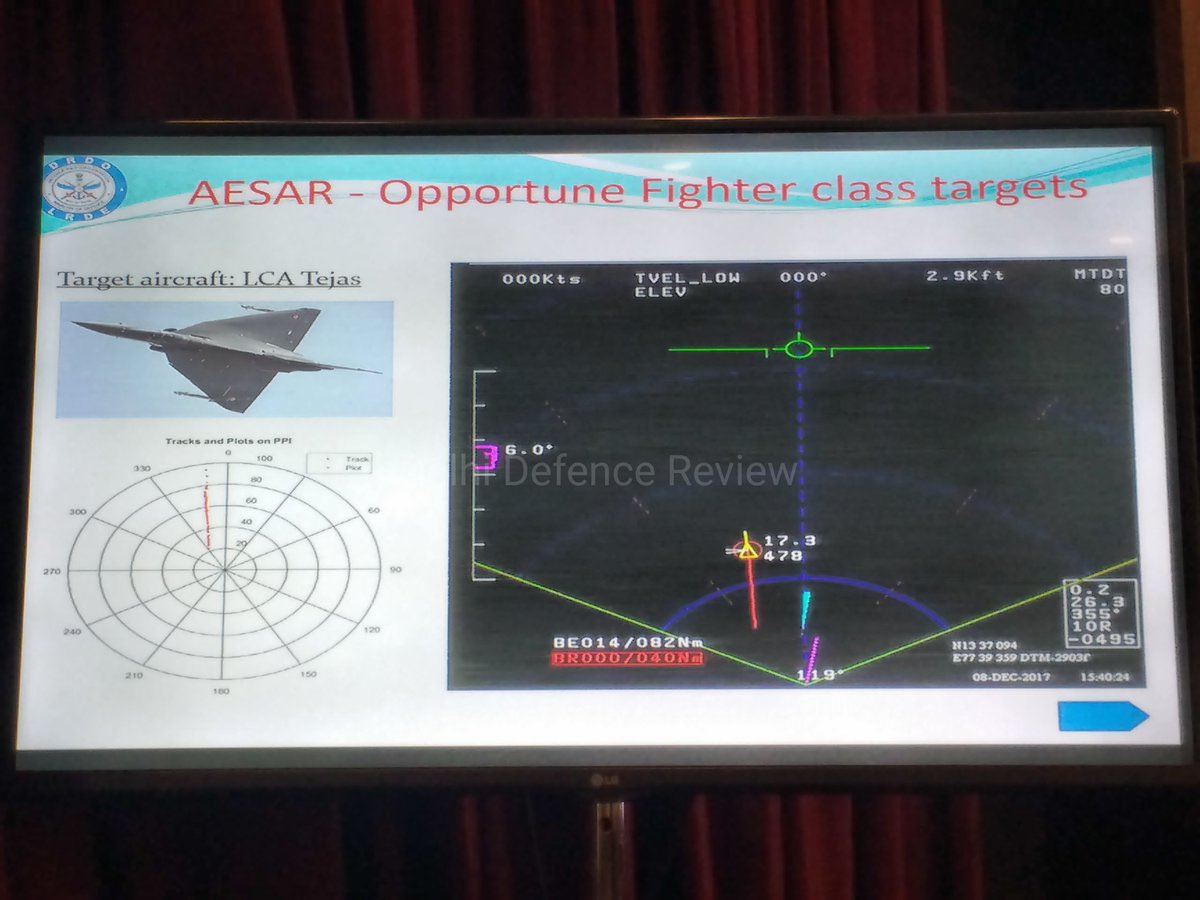

Re: Radar - Specs & Discussions
^^^Then it is very likely UTTAM is ready now. Need to have at least 200 orders of the LCA Tejas of ANY variety.
Oh is it ... then should match up with this interview from AI, which stated,Prasad wrote:The slides are from last AI, so two years old.
1) Half way thru AA modes - 30 more sorties required to complete testing the AA modes
2) Total 18 modes - 10 modes completed
etc etc.
A2g & A2sea are left, like I said in the video. Plus the ew test range testing. Will be ready by June.

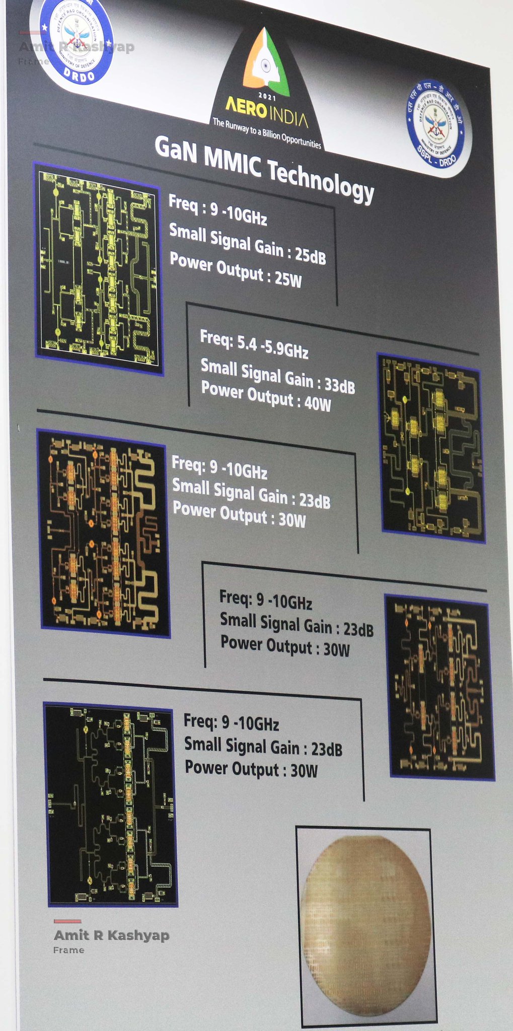

During the recent inauguration of the new Integrated weapons systems design center of the DRDO the Vice President was shown 2 new seekers developed indigenously which will be used on the AD1 and AD2 interceptors to be used in the Ballistic Missile Defence (BMD) 5000 Kms range Phase 2 program.
We seem to have 30W X band GaN MMIC. I feel due to the requirement of conformal radar on the truck, they have GaN radars, while ADTCR is GaAs to prevent cost escalation.Prasad wrote:
Interesting. Wonder if the BSR or the MFR is GaN based. C-band GaN was ready a while back. X-band isn't afaik.
It is very difficult to glean specific details from such poster. The things that are relevant to high performance defense programs are going to be performance, reliability, cost, yields, manufacturability and scale. If you look at the global state of the art GaN suppliers (military), it took them a fairly substantial learning curve (which still continues in many areas around GaN production) to get their high power density (you are really looking for XX Watts/mm as the yard stick) GaN technology from the lab out to a place it could be a part of large military acquisition projects (where the rubber meets the road as the saying goes). Back when the Iraq war was at its peak (early 2000s) the entire US GaN industrial base barely had enough capacity to supply the very small need to have some GaN tech in a low volume anti-IED jammers that were sent to the region. They couldn't even keep up with that at the time. This despite having decades of GaA's technology and production experience in military and/or commercial.
The Raytheon's, Qorvo/Triquent's, BAE's, NorthroP Grumman's and Cree's of the world spent 6-8 years jumping through multiple DARPA programs (starting mid 2000's) to eventually develop and demonstrate their ability to manufacture GaN MMIC's at scale, at cost, and then demonstrate system maturity to a point where acquisition programs could pick this technology without incurring additional risk over GaAs. This despite pumping out nearly 50% of the world's military GaAs production volumes during this timeframe. Even the dual (Mil+ Commercial) suppliers couldn't get past this stage without a dedicated stream of investment and demonstrations which should suggest that even with a very robust commercial process, business, and GaN tech development there are still things relevant to military application that requires a dedicated workstream, development and investments.
So the devil is very much in the details (Technology Readiness Level is just what the name implies it is one of 3-4 major barriers that you have to cross before you can use a said technology on an operational platform) and for that very important step of building scale (which is going to be the critical point where acquisition systems are going to begin using this technology) you need fairly substantial government investment to help suppliers design, build, refine, and eventually demonstrate their high MRL status and then enter into multi year programs to improve these things. Unless they are a huge commercial suppliers and have a steady cashflow from that business, no player interested in this field is going to have the pockets to self fund such an activity. All these high performance GaN Panel based and Conformal arrays that we see flying around of late are all a result of this push at tech development, at manufacturing process development, integration readiness demonstrations, and then eventually culminating in a prototype demonstration. You can't skip these steps unless you go to folks that have done this already and source from them (the SAAB and Lockheed model). But even then, commercial suppliers have benefited from military manufacturing and reliability improvements that they've back-fed some aspects of (commercial applications don't always pay a premium for such enhancements) into their commercial lines. For example, I know of at least one X-band 40+ W MMIC with a better than 30% PAE that has been commercially available for a number of years and is becoming popular in the commercial marine radar market and is even being used by a startup (led by a desi couple) in the commercial anti counter UAS role. A lot of the effort getting it out into the market involved leveraging investments made in the military sphere. Which is why this seedcorn GOI investment can act as a multiplier in terms of not only ushering in military capability but also allowing the said suppliers an entry path into commercial markets. That's a great ROI and side benefit.
Notice this part. And these were some of the world's leading designers/producers relevant to this aspect of military systems -

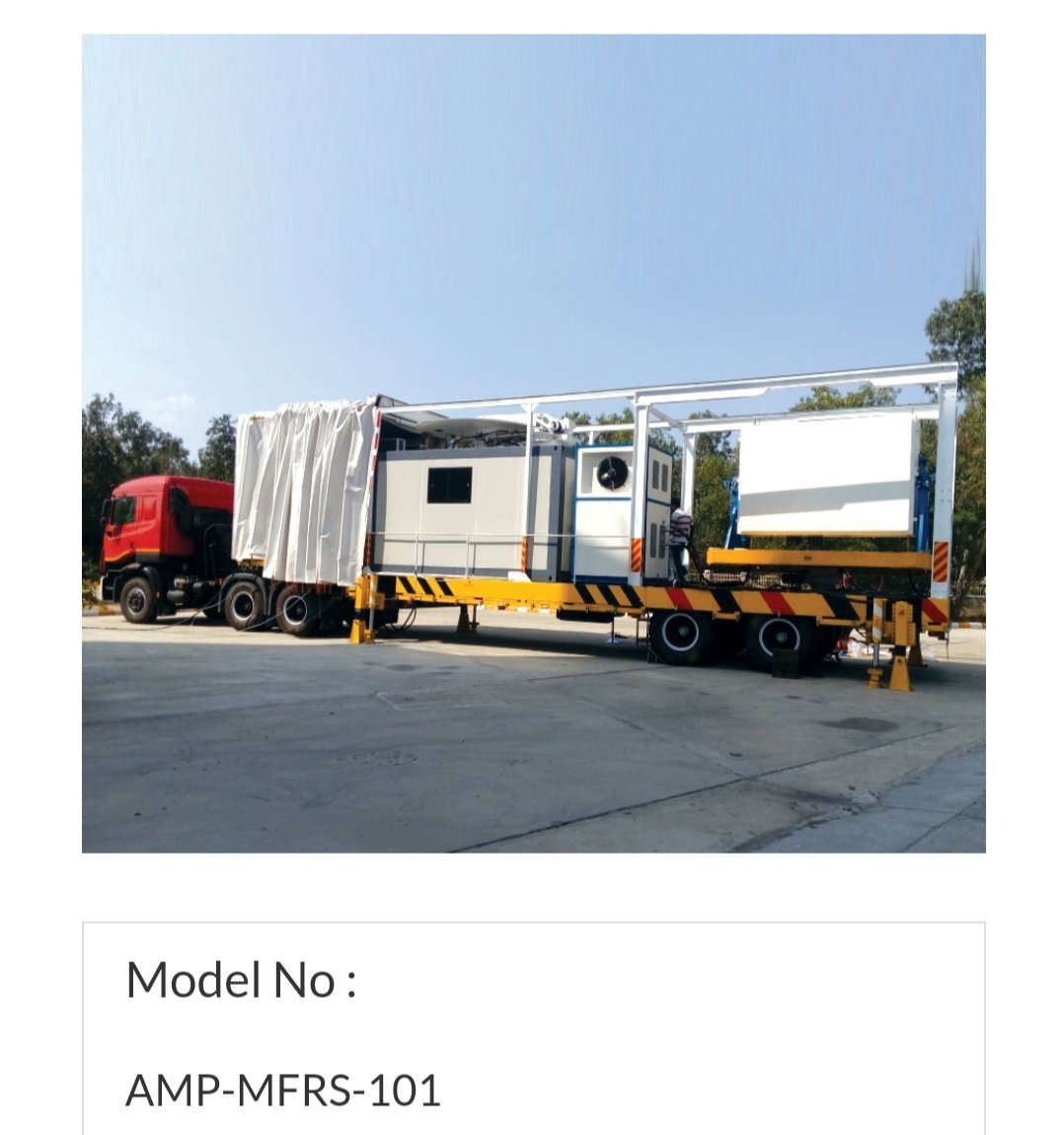

https://twitter.com/dfi_pk/status/13762 ... 12448?s=20 ---> Arudhra medium power radar.
https://twitter.com/Aryan_warlord/statu ... 01856?s=20 ---> Indianized ELTA EL/M-2084MMR. 400 km+ range.

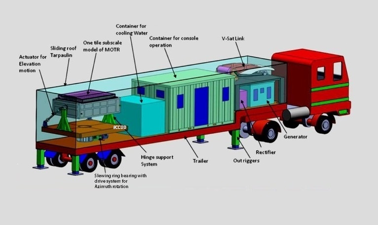

https://twitter.com/DefenceDecode/statu ... 96167?s=20 ---> Mobile Multi-Object Tracking Radar (MOTR):
- A scaled-down version of ISRO MOTR.
- Mobile MOTR is to be used for the Acquisition of short-range targets.
- All the subsystems in the Mobile MOTR facility including the Active phased array, DPS, DRS, Electrical and AC Chiller units.
https://twitter.com/DefenceDecode/statu ... 64130?s=20 --->
- Frequency of operation is fixed at 1.31GHz based on the Receive echo isolation between Main MOTR and Mobile MOTR.
Major Subsystems:
* Phased Array Antenna
* T/R Modules
* Feeder Network
* RF Systems
* Data Processing System
* Digital Receiver System
* Mechanical Structure
* Azimuth and Elevation Drive Electronics
* Cooling System
* Electrical System- Rectifier and DG
Major Subsystems:
* T/R Modules
* Feeder Network
* RF Systems
* Cooling System

The @DRDO_India's UTTAM AESA fire control radar tracking an LCA at 140KM
Considering the LCA has perhaps the lowest RCS in its class this is quite something and will make certain adversaries take notice
(Not clear if this is the first or second generation of UTTAM)
