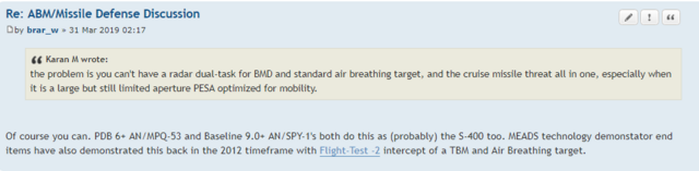

the problem is you can't have a radar dual-task for BMD and standard air breathing target, and the cruise missile threat all in one, especially when it is a large but still limited aperture PESA optimized for mobility.
and you noted:
Of course you can. PDB 6+ AN/MPQ-53 and Baseline 9.0+ AN/SPY-1's both do this as (probably) the S-400 too. MEADS technology demonstator end items have also demonstrated this back in the 2012 timeframe with Flight-Test -2 intercept of a TBM and Air Breathing target.
The issue is not whether a single battery can theoretically handle 3 different classes of threat in ideal conditions. Against the explosion of threats, volume, and mixes they can generate, a single battery will be overwhelmed pretty rapidly. I doubt it can handle them simultaneously either - the system architecture of a single panel AESA (check the elevation angles, and scan speeds horizontally) just doesn't support such multi-threat simultaneous coverage. The same radar can't track a steep dive IRBM and a cruise missile flying at 100 ft, simultaneously, not when one is coming at 9 o clock and the other at 12 o clock near vertical, and an AF strike package is at 4 o clock, each aircraft at different heights, all supported by EW (how much power can be allocated will itself move you beyond the standard battery control mobile radar).
whereas i was making the point:

The original discussion started because of this -
Karan M wrote:the problem is you can't have a radar dual-task for BMD and standard air breathing target, and the cruise missile threat all in one, especially when it is a large but still limited aperture PESA optimized for mobility.
All I said was that YES you can have a radar and Battle Management system dual tasked to handle a diverse set of threats. This was not possible for years because of physical hardware and software changes required on large PESA radars but it is possible now. There was nothing about *multi-vector threats* or anything to that end in your original post, only about a radar or a battery equipped with a PESA radar being able to handle BMD, ABT or CMD all at once. To this I responded by providing three systems that can do this NOW.

I have already said, now on multiple occasions, that no single GBAD system can accomplish your hypothetical scenario at the battery level. That scenario came later and I never objected to it. How much more clearer can I get? This was most definitly not the point I am or was disagreeing on. I am agreeing with you on this. My original post pointed to radar and C2 combinations that are more than capable of handing a diverse threat type within the sectors they are responsible for just as AEGIS does (but on a much broader and multi vector way).
Karan M wrote:y. Modes need to be changed for all ground based mobile radars, some need to be mast mounted, and have size restrictions. They lack the power footprint, the elevation coverage (to rapidly change between different classes of targets) and even the azimuth coverage (to rapidly track different targets). They cannot handle the practical threat profile i mentioned concurrently.
Of course they can't handle your hypothetical threat profile. You know what else they can't handle? 100 fighters coming straight at them. I am not arguing with you you on those points at all. All I am saying is that within the defended area and the sector they are looking into they are more than capable of defeating air-breathing, and ballistic missile targets. This is what modern systems are tasked and expected to do.

Karan M wrote:Can you show a single system with a single panel SPY-1 able to handle the threat profile I mentioned?
Again the same threat profile. I am not arguing on the ability of any one system or a single panel SPY-1. I am saying that a single panel SPY-1 will be able to handle that diverse threat set as long as the threats reside in the sector it is defending i.e. if there is a simultaneous ballistic and cruise missile attack within its field of view it can get interceptors on target there. Or in other words the Radar and C2 can handle it as long it is within its sector.
It will not be able to do this if the threats either originate outside of its sector or the engagement needs to happen outside of it but I never said it would be able to do that, I don't say that any GBAD system will be able to do that against all threats. Even the MEADS battle element that I cited is only required to be able to take on Ballistic Missiles in a 90-120 degree sector with concurrent AAW and CMD in 360 degrees. Or in other words defeat aircraft and cruise missiles in 360 degrees (area defense against Aircraft, point defense against cruise missiles) and ballistic missiles in the sectors it is designated. It was created and designed to be able to do this with sensor workload distribution much like the AEGIS system is.

brar_w wrote:Even the MEADS battle element that I cited is only required to be able to take on Ballistic Missiles in a 90-120 degree sector with concurrent AAW and CMD in 360 degrees. It was created and designed to be able to do this with sensor workload distribution much like the AEGIS system is.
90-120 degree sector, with what elevation coverage? That's 45 degrees side to side! Barely if any coverage to handle multiple classes of targets, since it can no longer turn or scan for more targets. Especially if any aircraft uses terrain masking or is able to get out of the primary zone and pop up closer, since as for TBM if as is essential, the elevation of the radar is locked into an upward tilt angle and a specific zone of "likely targets", good luck in taking on any non cooperative fighter which has a greater chance of coming in low or even around.
Re: ABM/Missile Defense Discussion
Karan M wrote:No, they can't because you haven't demonstrated this either. All you have is one test from MEADS against 1 fighter and 1 TBM.
The FT-2 demonstration was a proof of concept of the radar, the C2 and the integrated battle elements's ability to handle off axis threats with different characteristics i.e. a TBD threat originating from a different vector and an aircraft threat originating from a different vector. This was the concept and capability that it was demonstrating. I could be wrong, but prior to FT-2 no other Air Defense system had gone out and demonstrated that capability in an end to end test using live targets. They did not borrow your hypothetical scenario and said that they would take it in. It was carefully and specifically designed to show that the elements individually and collectively can distribute tasks, prioritize and execute engagements. This was the mandate. Now do they need to demonstrate it against 1 TBM and 2 aircraft for it to be able to do that role? NO. How many maximum targets has the S-400 shot down in one end to end test. Does it mean that it is unable to shoot down any more targets than that test?
MEADS FT-2 was not a raid scenario test but just a proof of concept test to validate the system's ability to defeat two different threats at different vectors.
