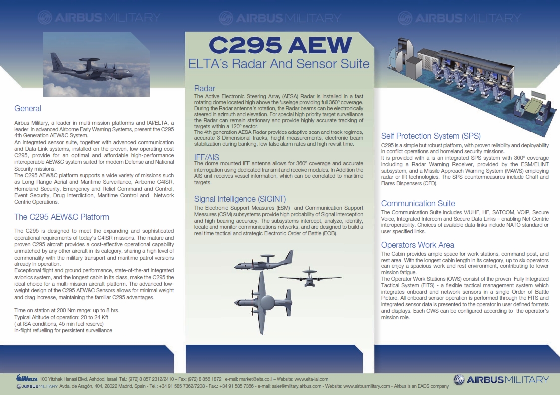

From Transport Aircraft for IAF
Kakarat wrote:
Cybaru wrote:It's possible we may see AEW off this platform as well for future if the deal is signed.
https://files.graphiq.com/1617/media/im ... 102_i0.jpg
Either we could get this fitted with our own radar or even ask Airbus to develop some thing similar to EMB-145 version, India definitely needs more AEWs
Both EMB-145 and C-295 are almost of the same size
Cybaru wrote:yeah. Hope they give the first few raw to DRDO first to get on with the CG and AEW conversions. If the chappati has undergone testing, we could use that config. Anyways for C295 AEW version, it was IAI that provided the radar.
Kakarat wrote:If DRDO takes up this project and if there is a potential confirmed order then Airbus might provide its current prototype for testing the radar and subsystems till the first purpose built aircraft is ready since there is no order for this type yet
Click to Enlarge
Posts: 10442
Re: AEW&C News & Discussion
^^^Looks like 6 situation displays with 60 degrees sector for each operator. And on the side a console for the communications officer. Interestingly there doesn't look like there is a separate console for the radar maintenance technician to ensure that any RF or signal processing systems are operating within tolerance. Or maybe one of the six SDs can be used for radar maintenance.

Post by Cybaru »
I doubt all six will be for radar screens. It will probably be less more like 1 or 2. Other screens will be devoted to other things.

^^^It will be too much info for two SD operators. For 360 coverage, 6 SDs means 60 degrees per operator. A max of 90 degrees per operator. Each operator is the ATC for his/her sector and will be communicating voice and data to the friendlies and keeping track of the hostiles.

Post by Cybaru »
Mort Walker wrote:^^^It will be too much info for two SD operators. For 360 coverage, 6 SDs means 60 degrees per operator. A max of 90 degrees per operator. Each operator is the ATC for his/her sector and will be communicating voice and data to the friendlies and keeping track of the hostiles.
So you are saying if the awacs flies a circular pattern and assume if I was a radar operator tracking something like a helicopter, then it gets handed over to the other guy sitting next to me as the target passes into his screen due to turning of the aircraft?? :rotfl: That will surely entertain all the six operators from their boring no blip flight because one side is always looking into India if it were flying on the border.

^^^I don't see why you find this so funny?
Once a scan is started the arenas are defined on the SDs and divided among the SDs so that there is full 360 degree coverage.
Radar returns are a complex waveform that consists of noise, clutter and target data. It comes out of the signal processor A/D as I&Q data along with azimuth and elevation information at some clock rate. This "raw" data is then sent to a radar processing computer which then combines aircraft position data, navigation data, and clutter maps to produce target range, velocity and position in 3-dimensions to produce a radar product which is then sent to the SD for the corresponding arena. It doesn't matter what the heading and position of the aircraft is as the data is always being sent to the particular arena designated at the start of the scan. If the target moves from one arena to another, then there is corresponding a hand off to the designated operator. The whole purpose of multiple SDs is to minimize the workload of the operator. The more SDs, the lower the workload and less chance of error in coordination.

Mort Walker wrote:^^^I don't see why you find this so funny?
It doesn't work that way buddy. Its not that you have 6 operators so each gets 60 degrees. Imagine the chaos when in a phalcon type awacs where you have 12 operators - each gets only 30 degrees. So, what you said is actually a little funny, no offense. :lol: :lol:

^^^Arenas do get defined one way or another and the radar computer hands off the data accordingly.
This is correct. You'd want to allocate your sectors to teams because AEW is a pretty intense job from an operators perspective. Not only do you have to manage traffic in an area you also have to work with the blue force and coordinate the fight. The computer automates the process and follows tracks as they transfer from one sector to the other but note that a radar that can see for hundreds of km in either direction for a target flying at a decent altitude you arent going to be really hopping from one sector to another at a given range. Same with the blue force.
