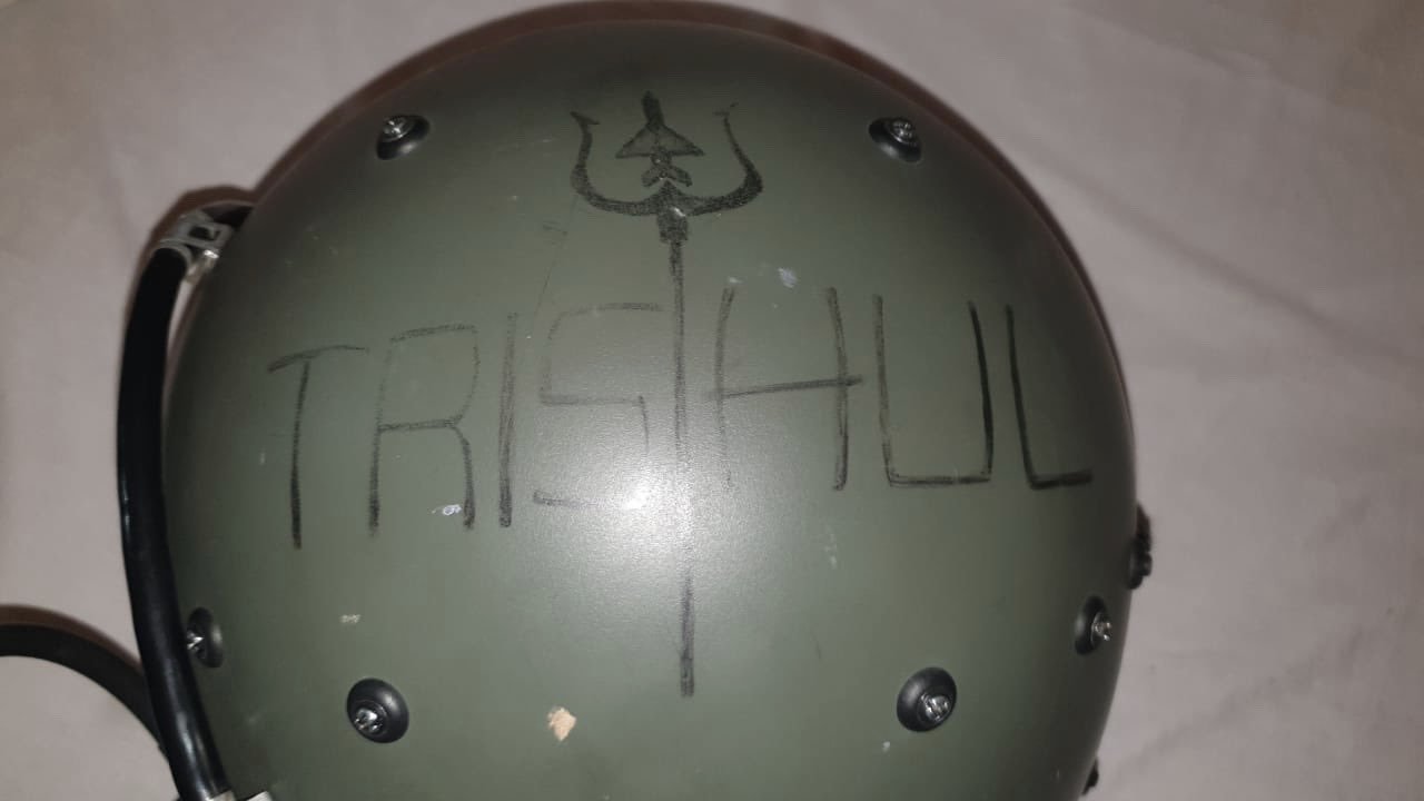

Rakesh wrote:https://twitter.com/hvtiaf/status/12910 ... 73889?s=20 ---> Night-Ops with HMDS. Very few aircraft in Asia flying with the quality of HMDS that LCA Tejas possesses. Perhaps, Mirage-2000 is the only aircraft that comes anywhere near.
https://twitter.com/KSingh_1469/status/ ... 74944?s=20 ---> And she’s had them them integrated for lever a decade now when they were still a relatively futuristic capability. Sir, do you know if IAF is ordering them in sufficient quantities? It seems to me like their line pilots aren’t flying with the HMDS in Sulur?
https://twitter.com/hvtiaf/status/12910 ... 93090?s=20 ---> In many 100s. Already. AFAIK.
The Elbit DASH is in service since 2000's on Mirage 2000 and Sea Harrier
https://www.ndtv.com/india-news/iafs-fr ... ad-2067318
https://dunsfoldairfield.org/harrier-part-2-of-3/
https://www.pressreader.com/india/vayu- ... 6664882884
They would possibly be part of the kit of Jaguar DARIN 3 and have been part of HAL Hawk-i
https://www.livefistdefence.com/2019/02 ... eapon.html
MiG-29K has the Thales Topsight E HMDS since 2006
http://www.defense-aerospace.com/articl ... tests.html
Su-30MKI, MiG-29UPG and MiG-21 Bison have their own sights. The Pakistani's have displayed Abhinandan's helmet
https://www.facebook.com/developingPak/ ... n__=EEHH-R
https://pbs.twimg.com/media/D1E66qPWoAA ... name=large
BTW Trishul is the Indian name of MiG-21 Type 77 variant.
So HMDS is there among most IAF and ALL IN front line fighters in last two decades. The HAL test pilot clarifies that in his next post. Not sure why a spin is given of HMDS being a unique capability on the Tejas.
Also Rakesh, help me understand why do you keep posting very inane and uninformed twitter posts of KSingh_1469 on this forum?
KSingh_1469's posts are very uninformed and lacking/overlooking/obfuscating facts. I do plan to respond to them when I have more time.
HMDS was never a "relatively futuristic capability" as he claims since IAF & IN engineers were integrating the same HMDS on Mirage 2000 and Sea Harriers respectively.
He can either post himself or people can read on his twitter handle. If we start posting every inane twitter post like KSingh_1469, then the whole forum will become very cluttered.
