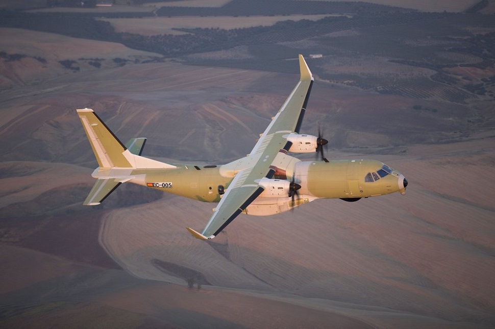

Funnily enough, the raked wingtips on the C-295 model displayed at AI-'19 don't seem to match with the wingtips on the latest C-295W that was flown in July for the RCAF. It might just be an inaccurate model on display.
RCAF C-295, first flow in July 2019
