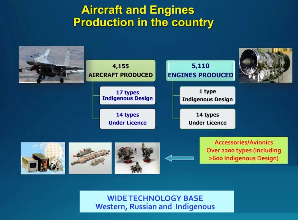

Next time when HAL says that they are building the AL-31FP from raw materials in India, please think about this....
https://twitter.com/DefenceDecode/statu ... 96994?s=20 ---> More than 5,000 jet engines has been produced in the country and most of them are under licensed production. The engine is still something that needs to be produced in the country and I think that dream of making our own engine and flying in an aircraft should be soon a reality: DRDO Chief
