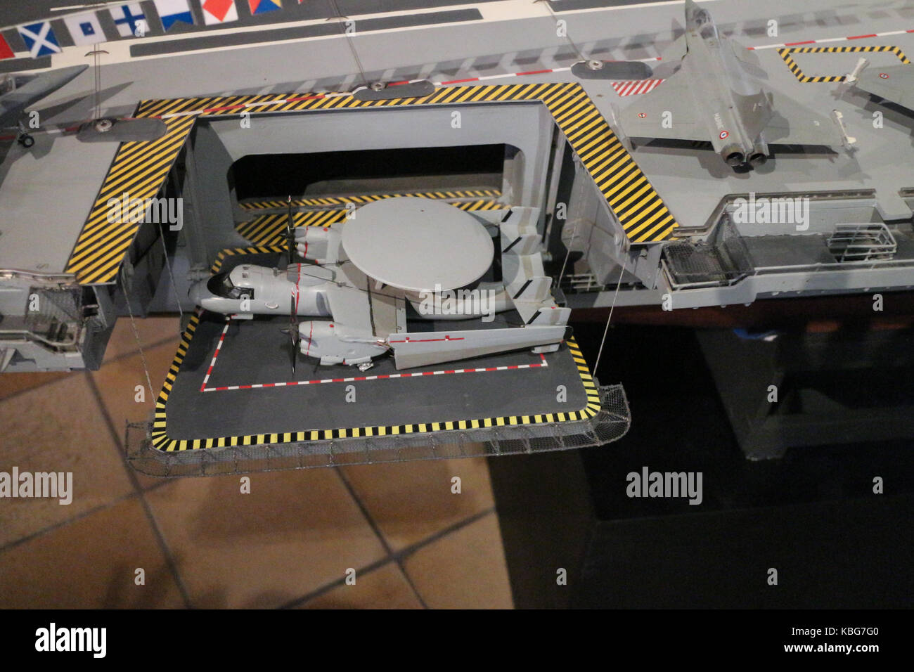

Regarding the lifts on IAC-1. looking at the photo, if the lift cannot be wider, can they not be longer? Extending further out.
You could technically remove the nose cone while on the lift and put it back on the deck?

Aiyoo! No way nam! Opening up the nose cone could likely expose the radar to the salty sea environment. I do not think that idea - of opening the nose cone - will work.

Rakesh wrote:Aiyoo! No way nam! Opening up the nose cone could likely expose the radar to the salty sea environment. I do not think that idea - of opening the nose cone - will work.
It will also be bad for sortie generation when you have to do that much work to move an aircraft (ability to move aircraft around the flight deck and below deck in addition to the ability to move ammo around from storage and up to the deck and on the aircraft has a major influence on your ability to generate sorties).

How would it be different from jets in the hangar with the lift door open most of the time while transporting jets? compare to 5 minutes of transporting on the lift?
I believe nose cones on today's jets are like windows with hinges, which allows you to open and close it quite easily, like this:
https://i.stack.imgur.com/eNF4r.jpg
There could be effect on sortie generation, however I am no convinced that even during peak times, a jet transported from lifts would be send to flying within minutes of arriving on the deck.
Not saying it is a perfect idea, however better than modifying a entire plane.

Obviously this could work as a desperate measure but there is good reason why you don't really want to be opening up nose cones or otherwise exposing sensitive electronic equipment to the elements like that as a routine procedure just in order to make something work. The effect on the ability to generate sorties is real. In sustained deployment and ops tempo you will need to cycle your aircraft back and forth for a whole host of repairs and you need to be able to do this quickly and efficiently. In carrier designs how effectively you can move the aircraft and weapons back and forth is considered quite important as this has a huge impact on your ability to sustain high tempo ops.

this pic shows clearly the diff between a through deck "ASW cruiser" of the invincible/vikky mould and a proper ground up design like QE2.
and even the QE2 has a flaw imo in only 2 huge deck edge lifts on the starboard side. if that area takes a damage in war, the ship will have to retreat.
"proper" warfighters like the khan carriers have no less than 4 deck edge lifts - 3 on startboard, 1 on port...... and 4 catapults....damage and mechanical issues at crucial times (like Karnas chariot wheel getting stuck in the mud as he trading arrows with Arjun) are sure to occur .... he who handles such mishaps best and keeps on fighting is the survivor..... for peacetime flag waving all are heroes.

QE2 lifts are sized for 2 JSF coming up side by side. (as are the american cvns)
Re: INS Vikrant News and Discussion
QE2 can be excused as its 50% larger than IAC-1.
but charles de gaulle is the same size
here it comfortably fits a rafale
:shock:
IMHO Designing the Lift will not be an after thought , The design would have been frozen around the time IAC design was frozen by NDB
The team would not have the data on how say Rafale or other type would perform with different payload from IAC much less any intent to buy by IN .....I mean we dont know even today if we will buy a Rafale or F-18 or JSF for our next carrier much less for IAC whose design would have been frozen.
CDG designer would have well in know about the AC they would have and they would have all the data for Rafale when designing CDG much like we have for Tejas so every one designs around what they know and have and its not an after thought based on unknown parameters.
IAC designers would have data for 29K and Tejas so they built the Lift and other supportting system around these two types

nam wrote:How would it be different from jets in the hangar with the lift door open most of the time while transporting jets? compare to 5 minutes of transporting on the lift?
See this picture (from your own post) and consider what will occur to the radar, when the vessel in this sea state (below this picture). Think what could happen to the sensitive radar - exposed to the salty sea environment - in five minutes of transporting on the lift because the nose cone was open? That radar will be FUBAR.
nam wrote:There could be effect on sortie generation, however I am no convinced that even during peak times, a jet transported from lifts would be send to flying within minutes of arriving on the deck.
Once on deck, an aircraft needs to be launched into the air. No time for closing nose cones or attaching wings ---> Dassault's idea for the Rafale M to operate off the Vikramaditya and the Vikrant. Once on deck, you go into the air. That's it. An aircraft carrier's greatest offensive weapon is her aircraft. You need a high sortie rate to get the maximum utility value.
It doesn’t make a lot of sense to build only for MiG-29K sized planes and below for a ship intended to serve up to five decades.
The Western philosophy had been for oversized lifts on modern carriers. The IN comes from a Western tradition to be perfectly honest. I find it almost impossible we woukdn’t have gone for the same oversized lifts on de Gualle and QE2 if it had been our own designers controlling that aspect of the carrier. I suspect we gave that up to the Russians when we brought them in to design and build the “aviation complex.”

probably the hangar deck, flight deck, nav aids, island was under russian design and rest of decks and machinery spaces under fincantieri the overall consultant who upsized the cavour knowledge.
the cunning russis took their chance well.
the CDG planned for and sized itself to accomodate the E2.
No one stopped the Indian navy to take consulting from US or French counterpart to design the iac for a larger fighter like Rafale , it was their decision to build iac around for mig and Tejas atleast for now , who knows after a decade from now they if they get Rafale or other types they may redesign to accommodate them

if an aviation cruiser can be sliced and diced into a full fledged CV, then wider sidelifts can be retrofitted to the Vikrant.
IIRC Russians were not in charge of anything below decks. The design seem local (maybe Navantia/Barzan or someone might have provided inputs based on Juan Carlos). Fincantieri are the ones who did the consultancy for propulsion.
So, the lifts are kind of our own doing. The key question is if adding a wider lift later will cause structural issues. If not, we have time in 2035 or so when Vishaal is (hopefully) foaming at the bows

We should not blame the russians here.
Back in the mid-90s and early 2000s:
Sea Harriers - approaching end of service life with no projected replacements; plus high attrition rates
Yak-38 - even worse performance than the Sea Harrier
Yak-141 - not in production
Rafale - needs Catapult which no one would sell us
Super Etendard - needs Catapult, and very mediocre performance
Skyhawk - needs Catapult (I think) but not available for sale in any case
F-18 - needs Catapult and not available for sale
F-35 - not on offer to us even today
Back in the day when the VikAd purchase was conceived, there was no other available carrier and/or aircraft that could have been purchased and sustained over 30 years. The decision was made to lock in VikAd + MiG-29 and Tejas (if at all), and consequently the SBTF and IAC/INS Vikrant in its current form was conceived. If we hadn't gone that route there would be no INS Vikrant today approaching commissioning.
This is a 30 year decision made based on our radar horizon back then. Hindsight is always 20-20

the deck edge elevator has a hydraulic & chain mechanism and not much internal parts, unlike the ones that are inside. they do not have hidden machinery under the hangar floor which is needed in internal elevators. so much easier to throw away that pile of iron maybe 150tons, cut a bit more and install a bigger machinery conformal to the hull side.
seems to me this UK based co is the world monopoly on elevators - the old vikrant, IAC-1, hermes probably all use their systems
http://www.mactag.com/57_AboutMacTaggartScott.html
they build and test the lifts separately.
we can maybe ask them to build bigger lifts and fit them during the first refit of vikrant which may be in 3-5 years after induction.
massa learnt her deck edge lessons building 24 (!!!) essex class carriers early on. brilliant innovation.

One innovation in Essex was a portside deck-edge elevator in addition to two inboard elevators. The deck-edge elevator was adopted in the design after it proved successful on Wasp.[6] Experiments had also been made with hauling aircraft by crane up a ramp between the hangar and flight decks, but this method proved too slow. The Navy's Bureau of Ships and the Chief Engineer of A.B.C. Elevator Co. designed the engine for the side elevator. It was a standard elevator, 60 by 34 ft (18 by 10 m) in platform surface, which traveled vertically on the port side of the ship. There would be no large hole in the flight deck when the elevator was in the "down" position, a critical factor if the elevator ever became inoperable during combat operations. Its new position made it easier to continue normal operations on deck, irrespective of the position of the elevator. The elevator also increased the effective deck space when it was in the "up" position by providing additional parking room outside the normal contours of the flight deck, and increased the effective area on the hangar deck by the absence of elevator pits. In addition, its machinery was less complex than the two inboard elevators, requiring about 20% fewer man-hours of maintenance.
some will ask why I am so obsessed with what is a engineering change that can be done in MLU.
thats because I would like to see two naval tejas armed to the wingtips, come up side by side in the pre dawn light!

I think our carrier lift shortsightedness stems from the entire history of IAC-1.If you remember well, way back in time, a few decades ago, the CV was called only an " air defence ship", ADS initially. It was meant to be a replacement for the Vikrant/ Viraat Harrier carriers. A fudge to get a larger flat top approved because of IAF opposition to the IN's carrier ambitions.A modest ADS of around 30K t+ replacing the Viraat was expected to have arrived at least a decade ago. It was also being asked for during a lean period defence budget wise.The ADS was initially to have carried the SHs and NLCAs only, later the 29Ks.
As time went by, the design stretched and expanded into its present size, esp. after the Gorshkov conversion into the VikA was contracted which was around 45K t and 29Ks as principal naval strikd birds. A slightly smaller CV would not have been objected too operating the same aircraft. The lifts were found adequately sized to operate the planned 29Ks as well as NLCAs.
One must understand how difficult it is to get the MOD to pass anything and the difficulty in major modifications of major weapon systems after initial approval with corresponding budget increases.
Had the IAC/ ADS come with larger lifts and the requirement of operating frontline western carrier aircraft or even Ru naval Flankers, it may have looked too ambitious and the nod may never have been given.
Looking at IAC-1, the design appears easily stretchable both fore and aft with two modular sections which would increase the hangar and deck capacity for extra aircraft and helos.Such a stretched sister ship appears easily doable.A few years ago CSL had offered a sister ship in around 5+ years. If the IN does not insist on a new larger CV 65K design but stretches IAC-1 in similar fashion as how it turned the ADS into the IAC-1, it would be more acceptable to the MOD/ GOI being a "sister ship". An immediate decision of approval may be achieved in ghe light of the Chin CV ambitions and the IN can thus get its 3rd. CV faster.Two 65K t CVs could be planned for arrival post 2030 to "keep up with the Chins".

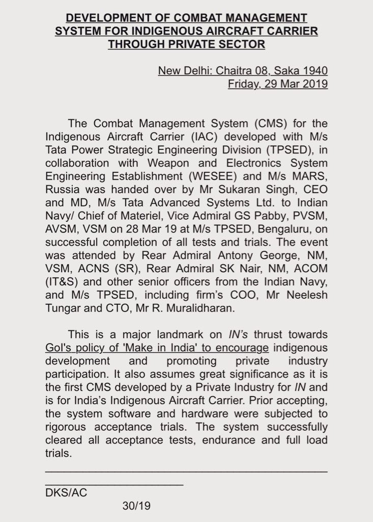

Livefist - Combat Management System (CMS) for India’s 1st indigenous aircraft carrier (New Vikrant-class) handed over to the @IndianNavy.
https://twitter.com/livefist/status/1111614416943022080
