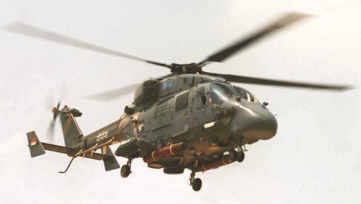

HAL offered for its NUH combat capabilities too.For the navy, the Chetaks provided a light deck-borne solution for many roles, stretching from basic training to urgent attack with torpedoes and depth charges.
Rs 21,738-crore is the cost of 111 helicopters.Hindustan Aeronautics Limited (HAL) has offered 111 Advanced Light Helicopters (ALH), the “Dhruv” for $3 billion (INR 21,738 Crore) to the Indian Navy’s Naval Utility Helicopter (NUH) procurement plan.
“The Company’s NUH is an Advanced Light Helicopter `Dhruv’ with customisation designed to meet all the operational requirements of India,” a top officer told Financial Express Online Thursday.
“The flying machine can be fitted with torpedoes, Depth Charges & Missiles, Self Protection System (SPS) & Flight Crew Data (FCD). Besides having Software-defined radio (SDR), Data Link & SATCOM, these helicopters will have the main rotor blade folding and tail boom folding to enable stowage in Navy’s ship hangars,” he added.

The basic requirement of NUH is SAR/utility with secondary anti submarine attack capability with ability to carry torpedoes/depth charges guided by other platforms. it will carry no dunking sonar/ sounboys for self submarine detection capability and no maritime radar but a wheather radar with secondary surface detection ability.
For Dhruv NUH the cost will be far less than $30m/NUH for naval Panther.

Interestingly, HAL has three potential NUH candidates
- Dhruv, twin engine but needs segmented blade and manual folding (assuming AUW limit will be relaxed)
- LUH, has segmented blade, is within AUW limits but single engine.
- Ka226t, twin-engine and within AUW limits but stillborn and remaining so for foreseeable future, and I don't know how navalized it is, blade folding etc. Best to ignore.
In hindsight, and it's probably too late now, I wish we had a twin-engined variant of LUH for the Navy. Sacrificing the engine commonality with Dhruv (ie, no Shakti) and using something that's around half the power (similar to the Arrius engine of ka-226).

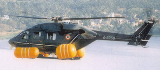

Naval Dhruv weapon trials over the years:
Depth charge
Torpedo
Dunking Sonar
Flotation
Plus, a cabin mounted machine gun for Coast Guard.
Weapons from IA/IAF Rudra variant like the rocket pods
Depth charge
Torpedo
Dunking Sonar
Flotation
