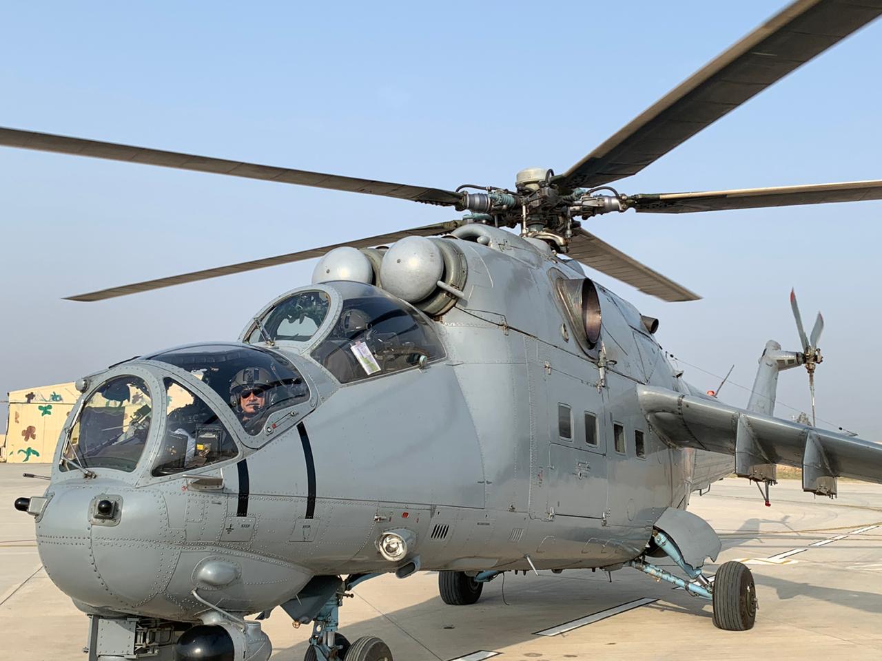

https://twitter.com/Aditya_G_Social/sta ... 11846?s=20 ---> 104 Helicopter Sqn still operates Akbars. Note the rare trainer version which does not have the chin mounted gun.
