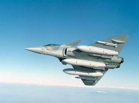

One thing about the French fighters is their ability to carry extra large external drop tanks: subsonic (1700ltr, 2000ltr) and supersonic (1300ltr).
Would be good to see larger drop tanks on an LCA as well beyond the 1200ltr. How much more range will two 2000ltr tanks provide?
They are not planned. By the way, the extension of range of a Rafale with two 2000 ltr tanks, and LCA with two 1200 ltr tanks will be similar. LCA could do with larger supersonic tanks though.

Some Paki Fizzile ya chief had lamented in the 90s that Light Combat Aircraft (LCA) has a heavy bomb load.
What is so great about carrying more loads. I will share something again that I had shared before. LCA's TO capabilities are amazing. It takes off so easily at Leh, that it has surprised all test pilots, and even the design team.
They don't want to load a light plane with a medium weight fighters load. They shouldn't. It makes sense for countries which don't have medium and heavy fighters. That is not the case with IAF. The light fighters shouldn't do what heavy fighters should do and vice-versa.
All I care for is subsonic and supersonic endurance. On the first, they have not done test sorties. But they have flown non-stop from Bangalore to Gwalior with operational loads and without inflight refueling. So, go figure. On the supersonic endurance though, the delay in the development of supersonic tank of different sizes has disappointed me badly.
