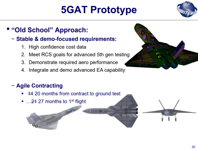

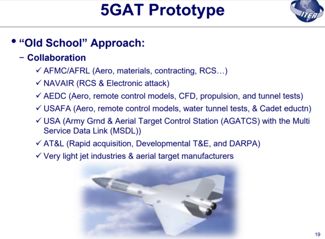

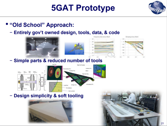

Some additional information on the 5th generation Aerial Target (LO design features (shape, materials and serpentine ducts), and internal EW/EA payloads) developed for Operational Testing of the F-35, Inc. 3.2B of F-22A, New Patriot Radar and Interceptor Missile programs..The final design iteration is expected to fly this summer and will be delivered to the testers in 2020..
Unique approach to designing - The DOT&E essentially hired a bunch of retired Skunk Works engineers and gave them access to government lab. infrastructure and let them come up with the design..Fabrication too is being done by a startup founded by a team consisting of ex prime retired engineers IIRC..
Posts: 66601
So they have modelled the j20 as a side benefit
Looks quite different from J-20 in profile though one aspect of doing this work, as opposed to simply flying a bunch of F-35's or F-22's against F-22's or F-35's for the purpose of testing and evaluation, is that an Aerial Target gives you the option of simulating designs and RCS and payload parameters based on your best assessment of your adversaries capabilities..so the RCS of this air-vehicle is likely to have been modeled on the current state of non-US LO aircraft, and the NAVAIR delivered EA payloads are likely simulating some of the capabilities expected to be employed by these aircraft in terms of offensive electronic attack and countermeasures. The 5GAT is expected to be betwen 35-40 ft. in length with a span > 20ft. and a total thrust of around 8000-10,000 lb (not bad for something that is expected to only stay airborne for only about 90-120 minutes).
Amazing how much in terms of sensors, RF data links, guidance and other electronics one can pack in very small munition class these days..
