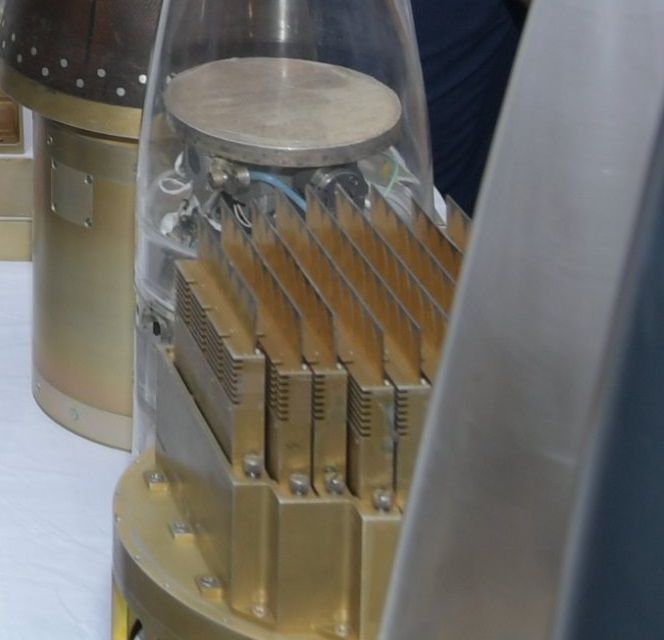

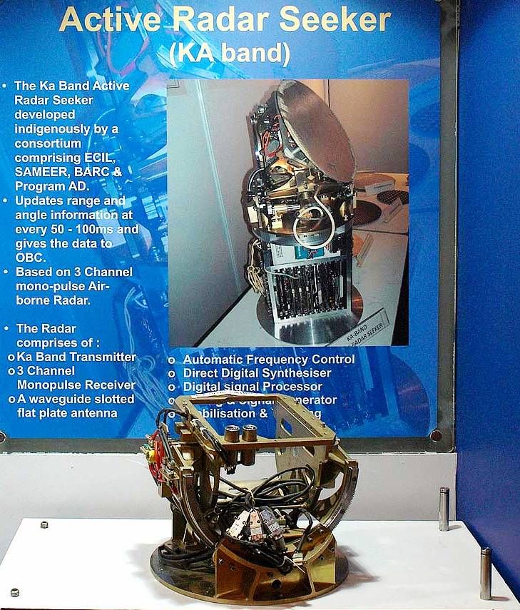

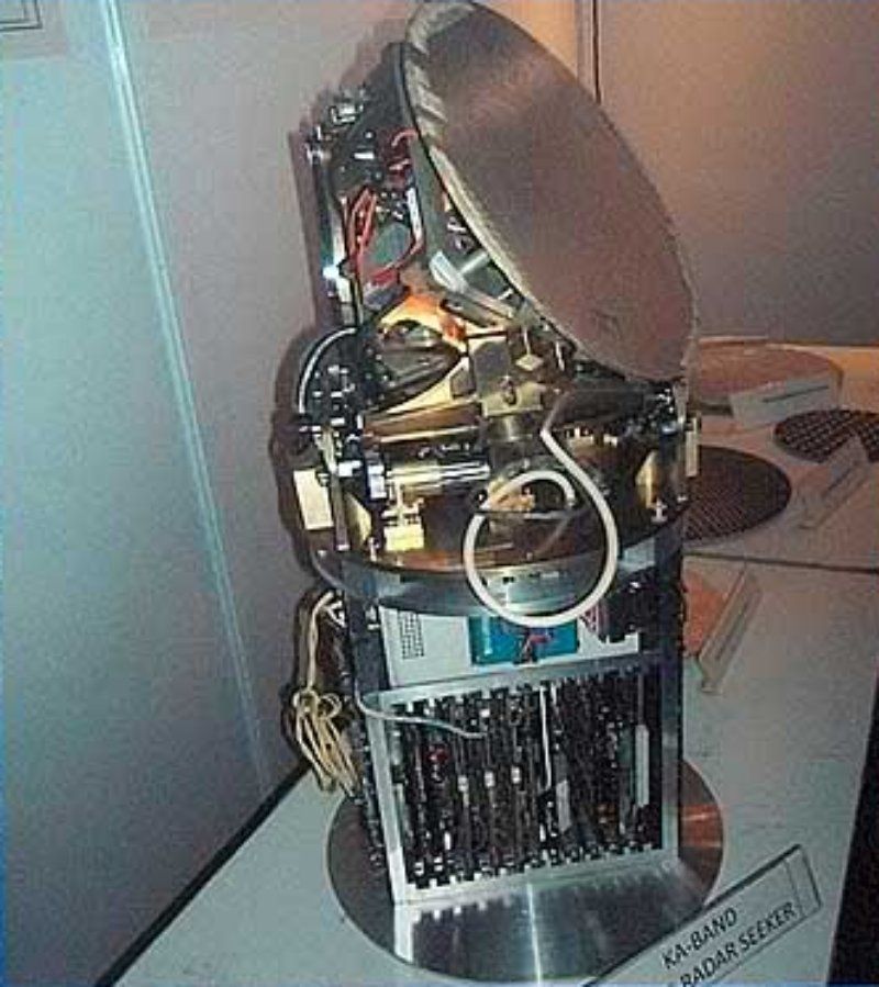

https://twitter.com/strategic_front/sta ... 05187?s=20 ---> In a recent exhibition, DRDO showcased an AESA seeker to VP Naidu. There are 2 AESA seekers with Vivaldi antenna currently being developed. They are meant to be used on long range AD/BMD & BVRAAM missiles. In 2020, AMPL said that the seekers were in advanced stages of development.
Posts: 4377
Postby nam » 30 Jan 2021 02:14
I think these examples are coming to Aero India.
The importance of that vivaldi X band seeker, is that you can have a fighter FCR using the same type of antenna.
Vivaldi antennas are used for wide band frequency ops, like in jammers. You operate in frequency ranges out of your adversary's RWR frequencies, you have LPI.
I think it is going to be difficult, but i really hope atleast the Uttam for Su30 come with a vivaldi design. Would make a cutting edge AESA radar. Probably khan already has it on F35/F15.

nam wrote:I think these examples are coming to Aero India.
Vivaldi is very appropriate/desirable for its
1. wide bandwidth,
2. end-fire pattern and
3. lesser sensitivity to nearby elements in high density array packaging.

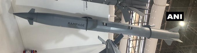

Israel’s Elbit Systems has put on display its Rampage air-to-ground missile at #AeroIndia show in Bengaluru
The missile is going to be inducted into the Indian Air Force
Posts: 55352
Postby ramana » 03 Feb 2021 13:11
What are it's specs?

Postby sajaym » 03 Feb 2021 16:34
ramana wrote:What are it's specs?
Check out page 3 of it's brochure -- there's an attack profile which looks exactly like the Balakot strike profile.
