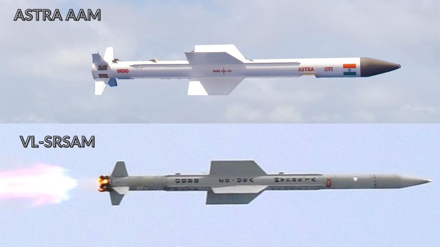

Looks very close to astra mk1. Looks like they are using Astra missile for family of missiles.
https://twitter.com/DefenceDecode/status/1363865592864796673
VL-SRSAM is actually longer than Astra. Astra 2?
If it has dual pulse, then it is for practical purpose Astra 2. Don't know if there is a requirement for dual pulse. Barak8 has it, Mica Naval is planned to have dual pulse, so it will not be out of ordinary..

nam wrote:VL-SRSAM is actually longer than Astra. Astra 2?
This is older Astra MK1. The newer Mk1 is very close to this SR SAM.

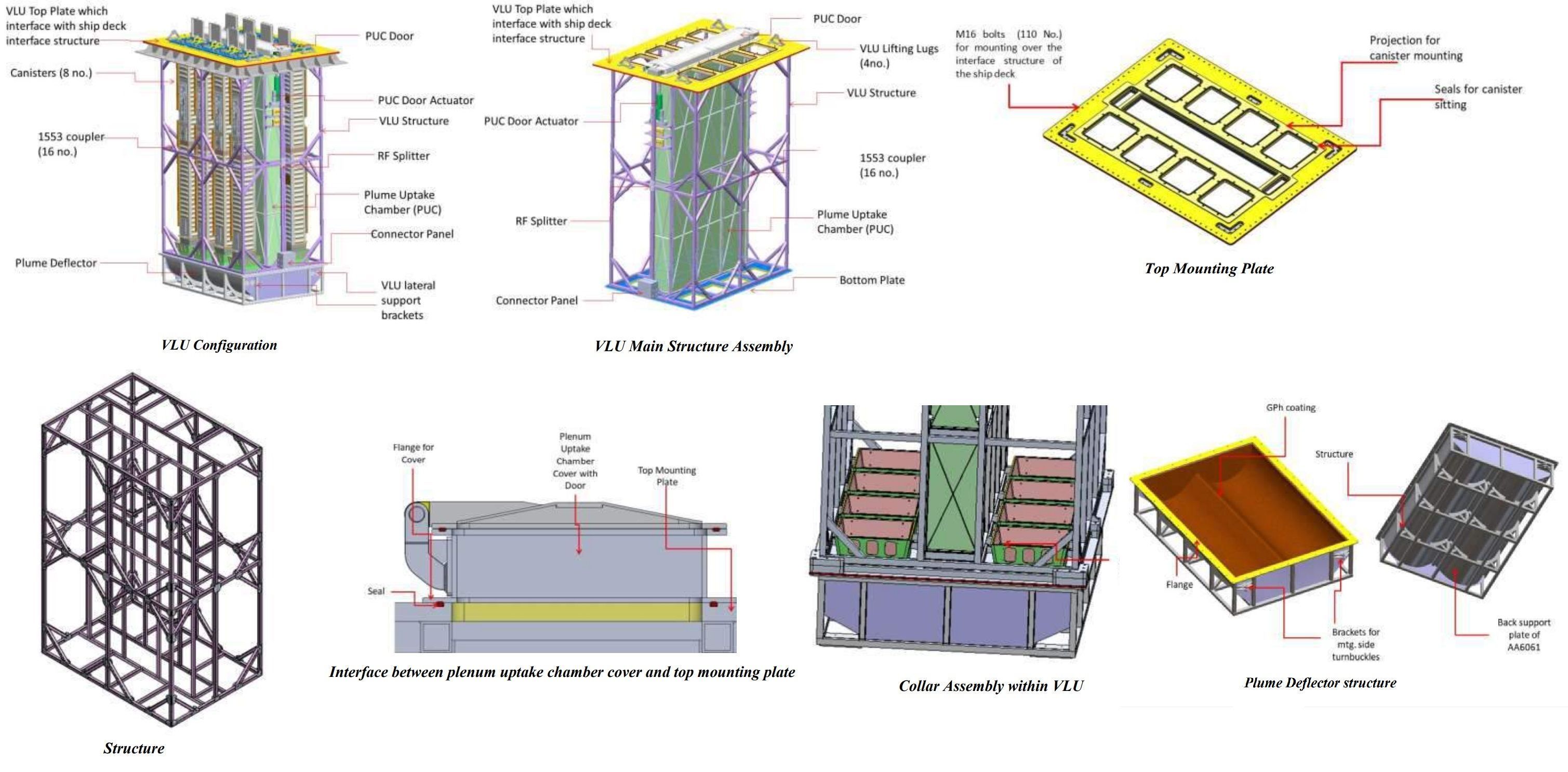

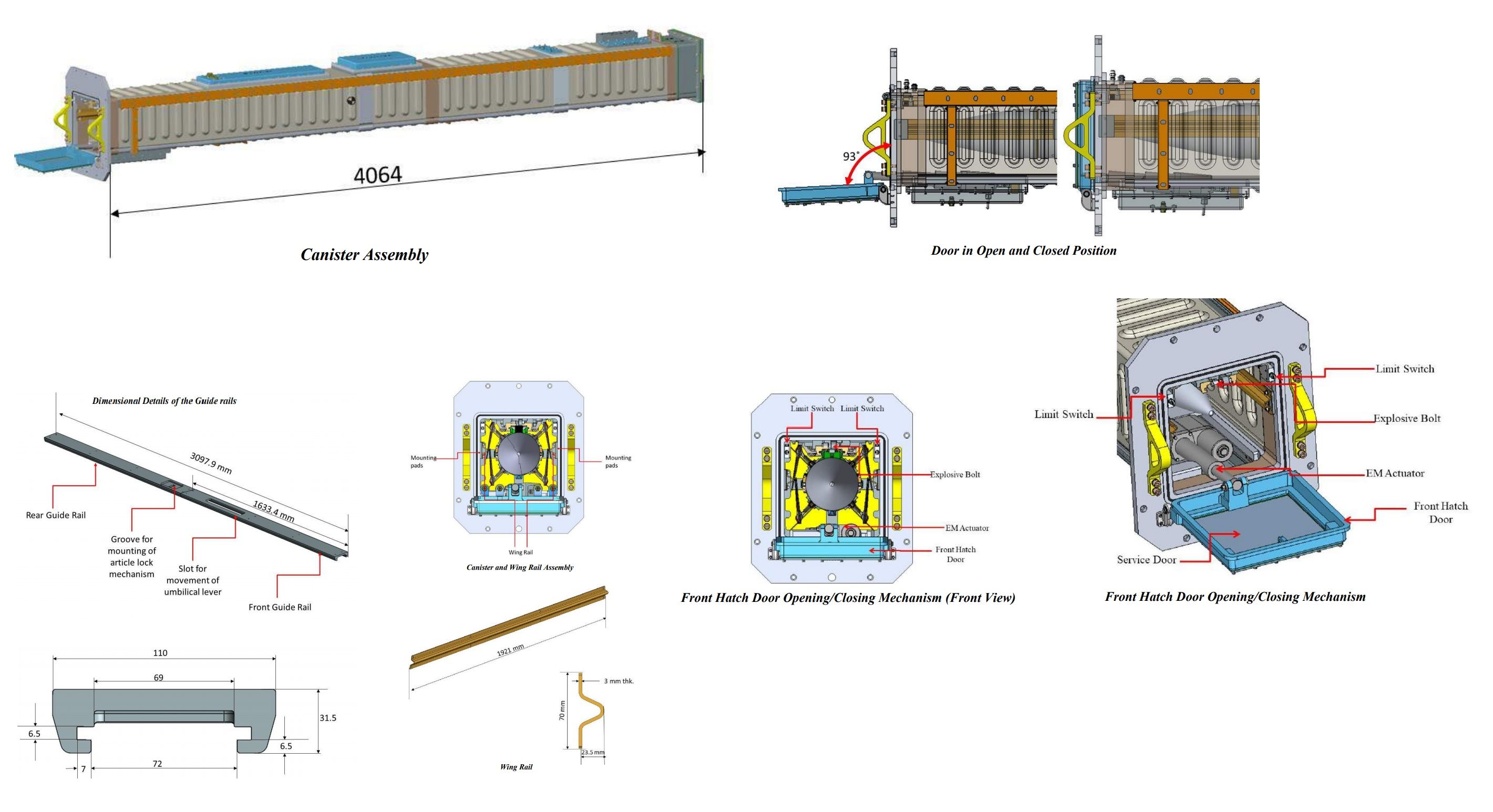

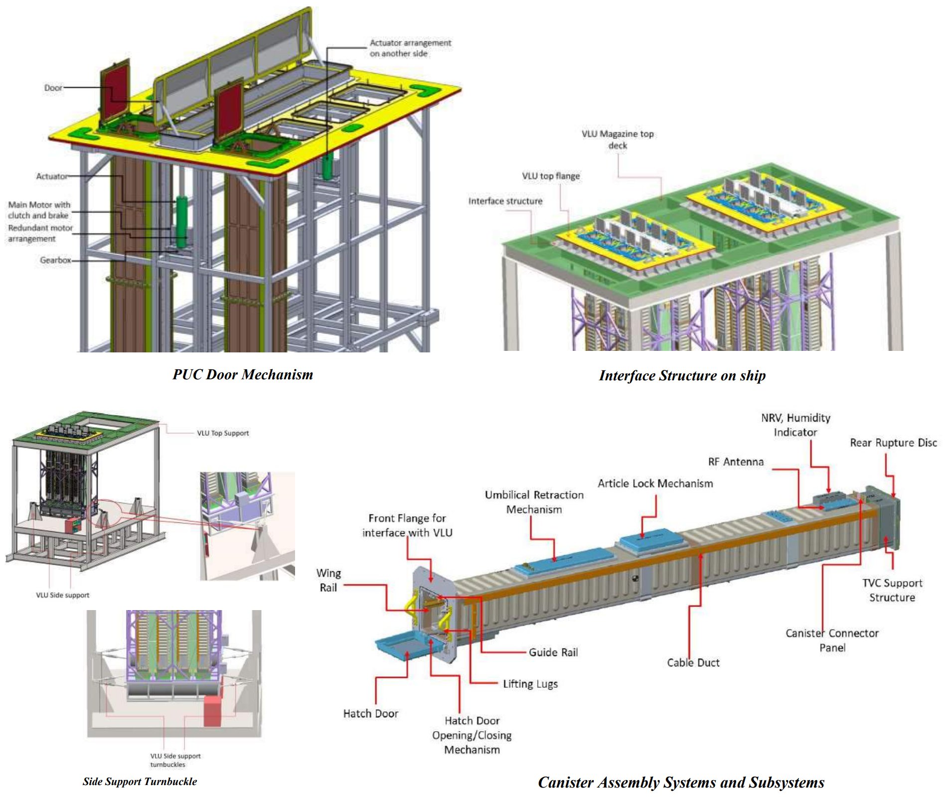

What's the significance of having 2 names for the same missile with same launch platform? Or is there some difference?
It is bit strange that DRDO went ahead with the test without a container or folded fins. QRSAM had both in the first test itself. I think it had TVC vanes as well, in the first test. So it is not like DRDO needs to test the TVC vanes.
Engine of VL Astra seems to be quite different from AAM version. Looks like some kind of vane like structure.
Found it:
Found it:
Maybe because a booster is added to the missile for VL applications.

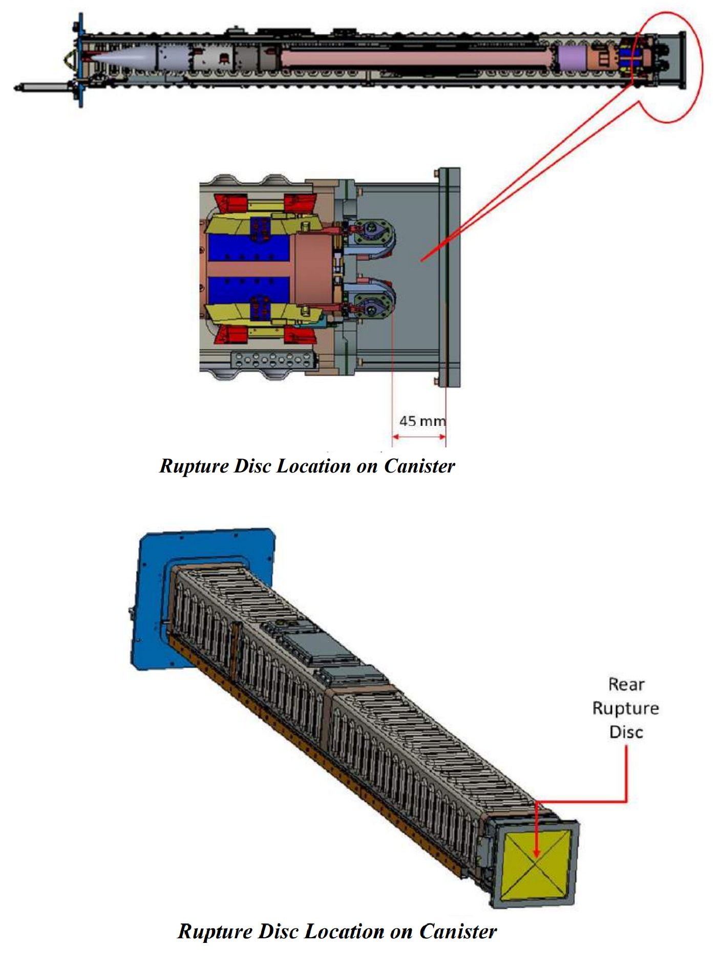

https://twitter.com/strategic_front/sta ... 97060?s=20 ---> VL-SRSAM's ship launch configuration shows a 16 cell VLU set up. Most current Indian Navy Frigates & Destroyers should be able to house one such VLU set up on their forward decks. The VL-SRSAM will fill the gap in AD capability between AK-630s & Barak-8 LRSAMs on Indian ships.

If VL-SRSAM has a confirmed range of 40KM, then it is dual pulsed. And this is Astra 2 land launch.
Unless we have some magic propellant, which the French have not discovered yet.
You cannot compare the two missiles this doesn't look like straight up Astra mk1 being converted for air defense similar to how mica was. So expect the range should be better than vl mica as it would be better optimized for that role.
John wrote:You cannot compare the two missiles this doesn't look like straight up Astra mk1 being converted for air defense similar to how mica was. So expect the range should be better than vl mica as it would be better optimized for that role.
It is not just Mica, even the Debry and Aim120 don't reach 40KM in their single pulse land fired mode. And they are not even vertically launched.
Given all the TVC disco VL-SRSAM is suppose to do, there is no way a standard Astra amount of propellant can give you a range of 40KM at such lower altitude.
It still retains the Astra's large central fins compared to Akash NG. So the drag has not been reduced either. Hence my personal view is that it is a dual pulse motor. aka Astra 2(or Astra IR with TC Vanes) They even did a rail launch, instead of using a container! No folded fins either. DRDO was in a hurry to test this missile.
