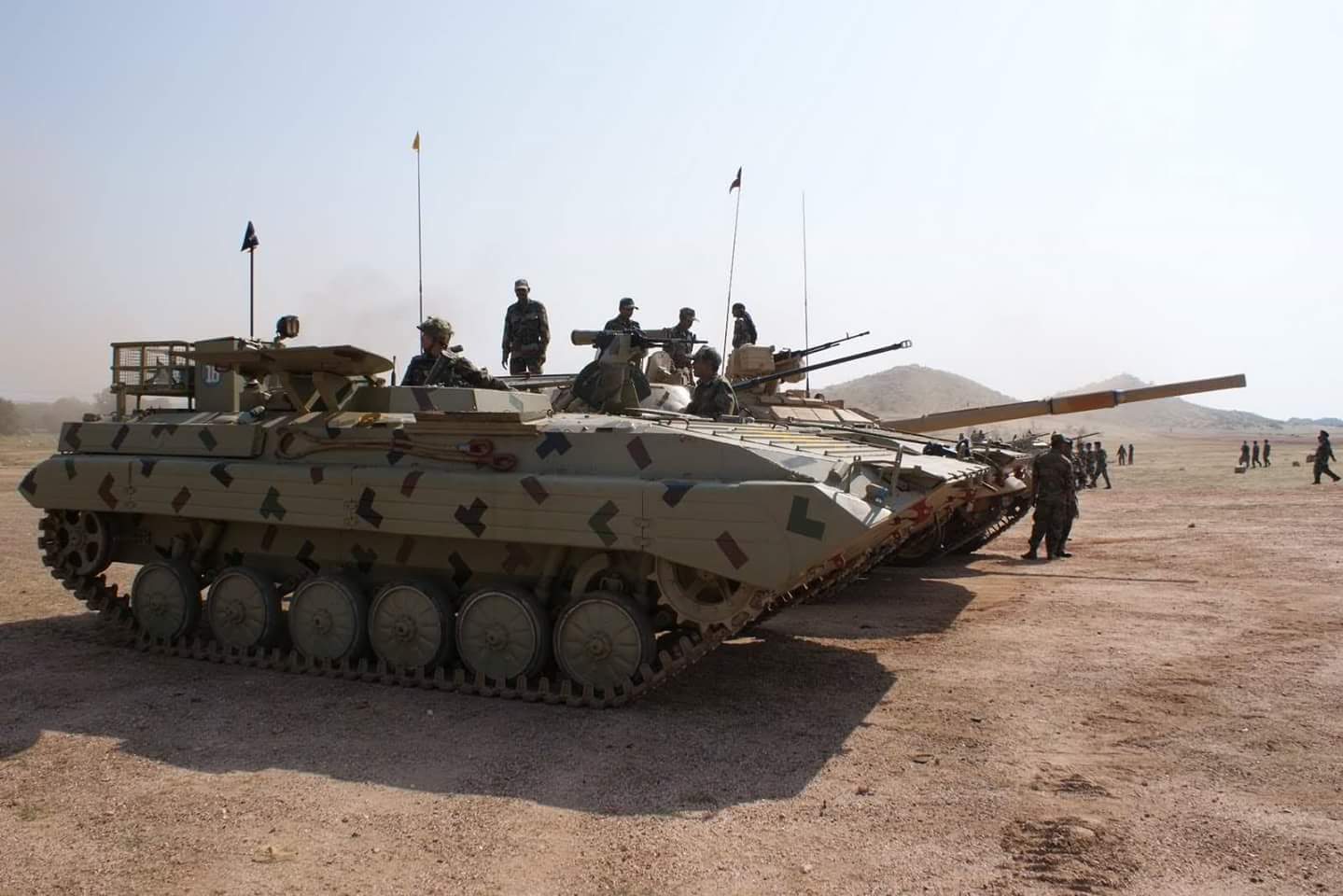

It's called Carrier mortar tracked, I think, where the 30 mm gun and turret is replaced by an 81 mm mortar.
I personally think that, while it is a good interim solution, they should have used the 120 mm mortar with auto load mechanism and a small turret to position it, like a desi Dragonfire.
Anyways, it gives our boys something to fire back with, across obstacles and over heights and overhangs, upto 6000m I believe.

Carrier mortar tracked weapon load out
81 mm mortar
Traverse: 240 either side of mean position
Elevation: 400 to 850
Ammunition: 108 rounds
84 mm RCL Gun (shoulder fired)
Ammunition: 12 rounds
7.62 mm M/C Gun in A/D role (for aerial targets)
Ammunition: 2350 rounds
81 mm mortar

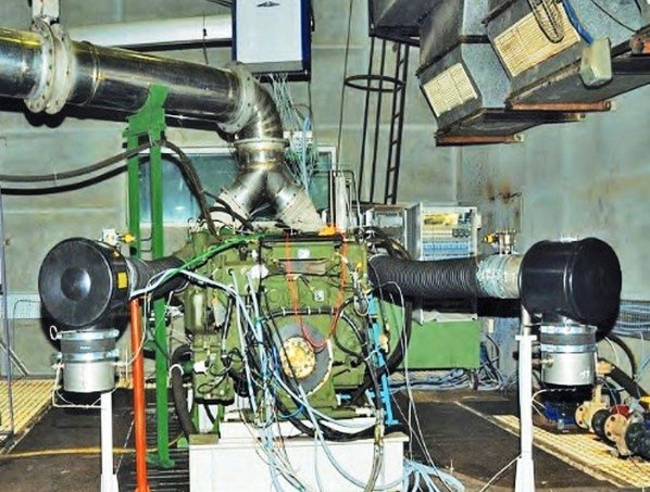

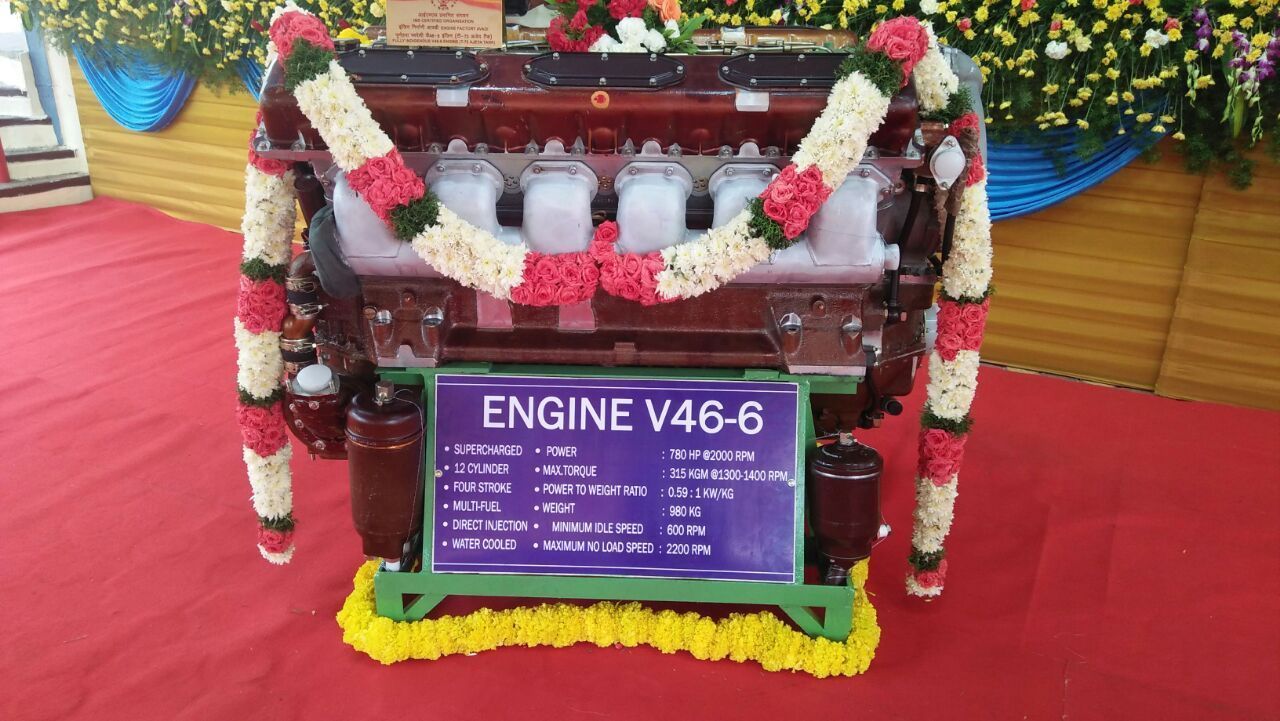

https://twitter.com/DefProdnIndia/statu ... 23424?s=20 ---> In next 10 years, Engine Factory Avadi will be supplying 100% indigenised 2550 numbers Engine V46-6 (Tank T-72) and 1716 numbers of Engine V92S2 (Tank T-90), saving to the tune of Rs. 800 Crores.
Don't understand why produce both the engines. All T-72's requiring an engine change or those being upgraded, should all be upgraded using the V92S2 engine of the T90 only. What is the use of producing the old T-72 engine with 780HP? Seems like a complete waste. If the transmission also needs to be changed, to match with the engine capacity, then so be it. Change it too.
In fact for the current scenario in Ladakh, T-72 tanks upgraded with the 1,000 HP V92S2 engine would prove to be ideal. In the high altitude areas, the engine de-rates, due to low oxygen levels. Having a more powerful engine, would also allow some additional armour protection and maybe some top protection for the turret to be added. The addition of ERA bricks have already increased the weight of the tank, from what it used to be, while the engine has remained the same.
Let’s see if these engine license production results in the capability to build indigenous ones (or even much improved variants). That’s when India will turn a corner.

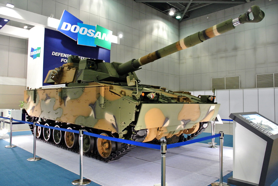

Saw a AV report today which says L&T is working on optimizing the K9 Vajra hull for Light Tank for the Indian Army. L&T wants to ensure the K9 assembly lines which will be utilized after the initial order for 110 K9's are completed at the end of this year.
L&T thinking out of the box. Nice! Thanks Vips. If you see a link to this, please do post.

A lighter K9 won't be K9 at all even if its base design is based on K9.prasan wrote:https://twitter.com/VinodDX9/status/1279082532076613633Interesting! Lt. Gen KJ Singh (Retd) in an article in The Tribune says to counter Chinese Type-15, DRDO has started developement work and there is a possibility to optimise hull of K-9 to develop a light tank. Result will be something like this in pic I believe.
aditp, in the past the DRDO mounted the Arjun's 120mm main-gun on a T-72 hull and realized that it had too much recoil (see DRDO Tank-EX).
If L&T has excess/unused capacity, it is better off producing K-10 reloader for the K-9 Vajra, and partnering with the Koreans for serial production of the recently selected K30 SPAAG. A light tank, as I have noted before, is an obsolete concept -- too weak to perform as an MBT and too niche to perform as an IFV, it is a one-trick-pony.
And if the DRDO has learned any lessons from the failed Tank-EX program and the Russians' lessons from the First Chechen War, it should develop an unmanned BMPT Terminator turret with wide-angle gun elevation/depression. It can cheaply and easily be mated on T-72 hulls already license-produced by Avadi.
