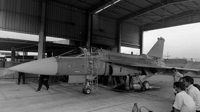

LCA Tejas Division of #HAL continues to inspire us amidst the #Corona scare. Here's #TejasSP22 undergoing the EGR. The first flight should be soon. And, let's not forget the lockdown in #Bangalore and the difficult situations. #FlyingBullets
https://twitter.com/writetake/status/12 ... 5477643264
Posts: 5872
Tejas looks better in primer and without the two tone dark grey and lighter grey colors. Would look a LOT better in a uniform light grey all over paint scheme.
Check out the build quality.Mashallah. Are the private sector parts now coming in? SP16 had the wings. I wonder if the fuselage is now available as well. It has been a year since Sp16.
Posts: 9199
Is it possible to apply the same dark grey color to the nose cone as well? Or does the material (quartz) of the radome restrict it to specific colors?
We can see this in the M2k and Su-30 fleet as well. The older models had a black radome. The M2k-I has a light grey radome as does the newer Su-30 builds (Mk-3 onwards perhaps). Was this because of a change in radome material?
Fabulous decision to go for composite, despite the brickbats ADA received for so many years for "aiming high".
