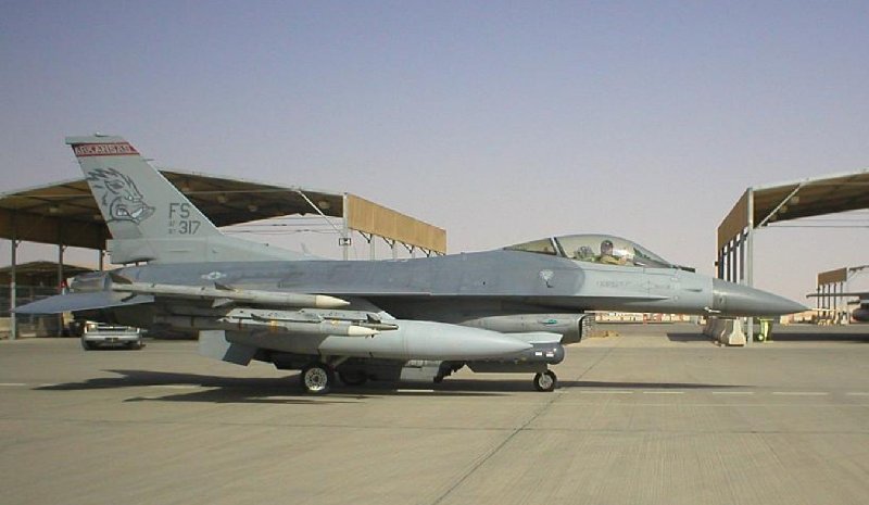

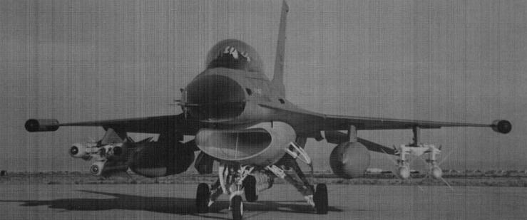

Or something like this? which was more typical of how the F-16's operated. That's 4 BVRAAM's, and 2 CCM's along with two fuel-tanks and a targeting pod. I think there is value in developing dual racks because of flexibility especially when the rest of the aircraft is capable of supporting the misison.
Posts: 5872
brar_w wrote:I don't think this is the right way to look at it. If one just went with what anyone has ever fired then we'd probably max out at a much smaller number. Yet, operators around the world require 6 and even 8 missile capacity on their fighters (and carry that amount) even though I doubt anyone has ever fired 6 or 8 missiles in one sortie.
The Tejas capacity of 6 missiles is pretty good. But Kartik does have a really good point about dual racks. While everyone focuses on the increase in the absolute number of missiles one can carry with dual racks, what is more important is the flexibility that it provides especially when it comes to additional types of weapons, sensors or fuel tanks.
Here's a test configuration on the F-16 that GD validated long time ago. It would allow for these type of configurations when you need both weapons and additional fuel and can't use other hard points because they are being occupied by other weapons, or sensors. Again not to pack a dozen or more missiles but to increase the flexibility.
The F-16 pretty much is the gold standard when it comes to flexibility of payload options. I don't think any other fighter offers as many variations in payload.
This kind of dual rack to carry 2 X Astra or 2 X i-Derby ER should be explored and if feasible, it is only a matter of fabricating a few of these pylons for each squadron. Use as and when required, depending on the mission that the Tejas is tasked with.

brar_w wrote:Or something like this? which was more typical of how the F-16's operated. That's 4 BVRAAM's, and 2 CCM's along with two fuel-tanks and a targeting pod. I think there is value in developing dual racks because of flexibility especially when the rest of the aircraft is capable of supporting the misison.
Exactly and that is the type of loadout the Tejas is perfectly capable of. If they just apply the same experience that they had with developing the dual rack pylon for the Mk1A to carry a CCM and a SPJ, only this time to carry 2 BVRAAMS on the mid-board hardpoint. Very doable, if they want to.
