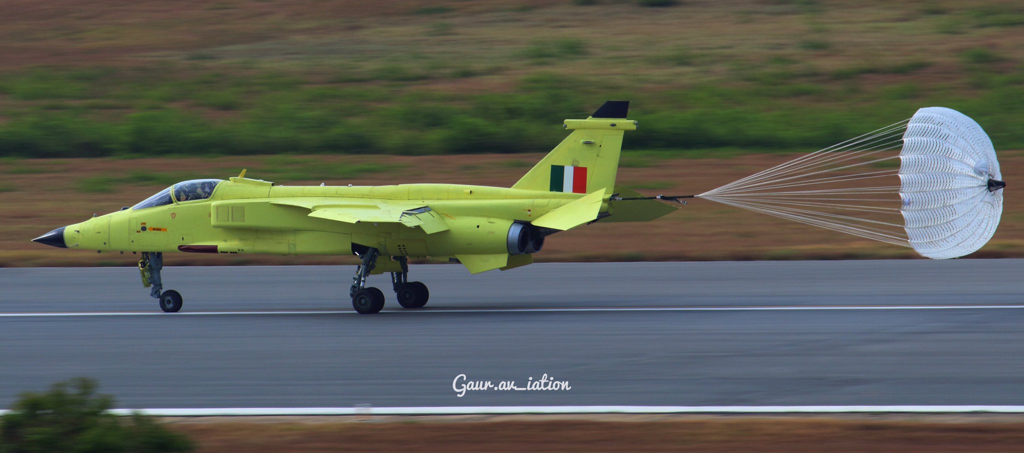

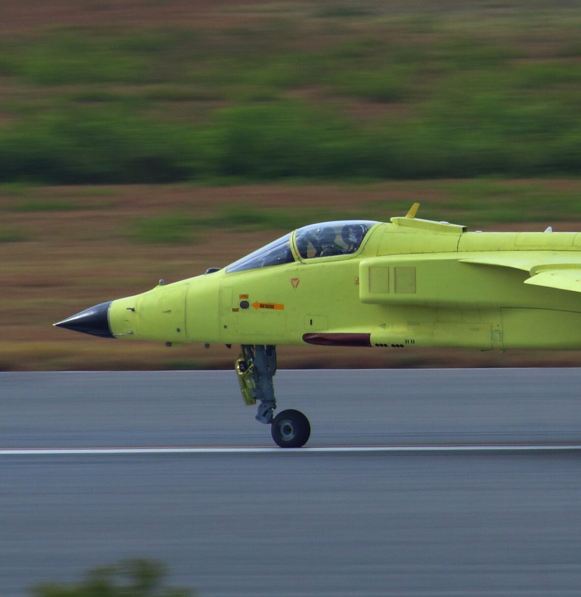

Postby Kartik » 31 Mar 2021 18:46
Beautiful newly upgraded Jaguar DARIN 3 in primer..one of the clearest shots of this elusive big cat.
[url=https://twitter.com/gaur_av_iation/status/1377198742151917569[/url]
