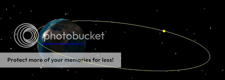

SSSalvi
Posts: 787
Joined: 23 Jan 2007 19:35
Location: Hyderabad
Re: Chandrayan-2 Mission
Post by SSSalvi »
Created 3 views of current orbit of Chandrayaan 2 .
Whole orbit around Earth for comparing the relative sizes of Earth and Orbit ellipse.
Orbit and also the Moon depicting the distance to be covered in the last maneuver to place Chandrayaan-2 complex around Moon.
Shows the Inclination of orbit wrt Equator
