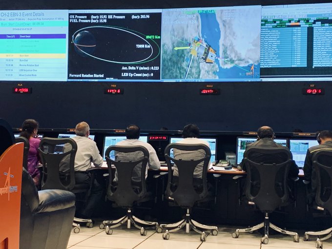

Re: Chandrayan-2 Mission
Chandrayaan2 update: Fourth earth bound maneuver
Fourth earth bound orbit raising maneuver for Chandryaan-2 spacecraft has been performed successfully today (August 2, 2019) at 1527 hrs (IST) as planned, using the onboard propulsion system for a firing duration of 646 seconds. The orbit achieved is 277 x 89472 km.
All spacecraft parameters are normal.
The next orbit raising maneuver is scheduled on August 6, 2019, between 1430 – 1530 hrs (IST).
Looks like a shortfall (0.84%) in the apogee : 277 x 89472 ( actual) vs 248 x 90229 ( planned ) - https://www.isro.gov.in/update/24-jul-2 ... spacecraft.Ashokk wrote:Chandrayaan2 update: Fourth earth bound maneuverFourth earth bound orbit raising maneuver for Chandryaan-2 spacecraft has been performed successfully today (August 2, 2019) at 1527 hrs (IST) as planned, using the onboard propulsion system for a firing duration of 646 seconds. The orbit achieved is 277 x 89472 km.
Anyway 2 more earth bound maneuvers (including TLI) to catch up , then we are on our way to the moon.
Don't think ISRO has published any plans / schedules for mid course correction maneuvers.
Nope it is bang on target based on the revised burn schedule which was 89743 Kms apogee which would have been further revised based on previous burnjuvva wrote:Looks like a shortfall (0.84%) in the apogee : 277 x 89472 ( actual) vs 248 x 90229 ( planned ) - https://www.isro.gov.in/update/24-jul-2 ... spacecraft.

https://www.isro.gov.in/update/06-aug-2 ... d-maneuver
Fifth earth bound orbit raising maneuver for Chandryaan-2 spacecraft has been performed successfully today (August 6, 2019) at 1504 hrs (IST) as planned, using the onboard propulsion system for a firing duration of 1041 seconds. The orbit achieved is 276 x 142975 km.
The next maneuver is Trans Lunar Insertion (TLI), which is scheduled on August 14, 2019, between 0300 – 0400 hrs (IST).
