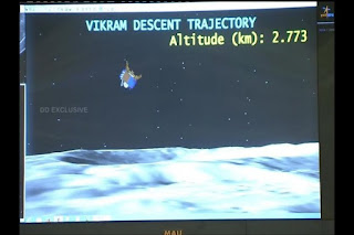

So how does this happen?
The control system expected the lander to be at higher speed for start of fine braking?

From TOI.
It appears that the reduction in velocity during the fine descent period was higher than the designed parameters. This might have thrown the software into tizzy and hence the crash landing.
My speculation, the lander has to go from point A to point B, but the braking is higher and the software realizes that it can only go to say A.5. Now it cannot add thrust! But it is designed to go to point B. And the software goes into an irrecoverable loop where all it has control on is varying braking thrust when it actually needs a 'boosting' thrust!

disha wrote:It appears that the reduction in velocity during the fine descent period was higher than the designed parameters. This might have thrown the software into tizzy and hence the crash landing.
Yes, S. Somanath had hinted at this in the podcast I had linked before. It was not a bug or glitch. The parameters of the craft were outside the design parameters of the software. He had said that the spacecraft is designed for tolerances around ideal values. Tolerances can be increased, but that comes at the price of added fuel.
He had said that there is no reason to not make the whole report public as soon as it is ready. Let's see.

Indranil wrote:Yes, S. Somanath had hinted at this in the podcast I had linked before. It was not a bug or glitch. The parameters of the craft were outside the design parameters of the software. He had said that the spacecraft is designed for tolerances around ideal values. Tolerances can be increased, but that comes at the price of added fuel.
I do not think I ever said it as a software bug or a glitch. My first post on this subject did say that the control software might have been presented parameters out of its design bounds. My thinking at that time was Vikram could not get a lock on the safe spot to land and that might have presented unbound parameters.
Now we know that the more than anticipated reduction in fine descent created this situation. And throwing software in tizzy is what I mean by control laws not able to gain control over the situation due to out-of-control events. :)
IMPORTANT: What Vikram attempted was far far far more complex than landing a craft in a region which is as smooth as a baby's bottom (comparatively and figuratively).
I am also *not* in favor of revealing the whole report in public. First of all the DDMs will not understand a difference between control and law and go into #Blow2ISRO mode. Second it will reveal the antecedents of the software. Since what is the difference between landing Vikram on a remote spot and a 'dharmo' on another remote spot? Other than former being more complicated.

somdev wrote:The control software is most probably written in ADA. In ADA operations may be implemented as subprograms using conventional sequential control structures. Unless there was something fundamentally wrong in logic the Ada execution is mostly flawless.
It has nothing to do with Ada or even anything fundamentally wrong.
Think of it as this way, the control law needs to supply more fuel to the thrusters so that it can add more thrust to reach point B instead of point A.5. However there is not enough fuel in the craft! So what can it more do? And this is just one of the parameter we are speculating on. In reality, Vikram had to deal with 100s of parameters in realtime.

Finally, an official response on how #Chandrayaan2 lander #Vikram lost control. See attachments: Left: My story that "extra brakes may have sent it out of control", Right: Govt reply in Lok Sabha saying the same.
Read Full Report Here:
Extra braking caused Vikram to deviate: Govt in LS

BENGALURU: The changes the Indian Space Research Organisation (Isro) is making in the proposed Chandrayaan-3 mission are indicative of the things that may have gone wrong with Chandrayaan-2 that failed to soft-land a probe on Moon in September 2019.
From a new guidance algorithm to improved communication systems on the lander, the overview committee that met last Tuesday (November 12) has pointed to multiple recommendations made by the failure analysis committee (FAC) looking into Chandrayaan-2 failure.
As part of the final discussions at the meeting the committee accepted the “Propulsion+Landing Module” configuration for Chandrayaan-3, and said: “Guidance algorithm to be finalised considering all recommendations of FAC and also after detailed simulations.”
The TOI was the first to report that Chandrayaan-3 mission is likely to have this — lander & rover (landing module) and propulsion module— configuration on November 14.
Software & Algorithm Glitch?
Sources indicated that one of the main reasons that the FAC found for Chandrayaan-2’s failure in soft-landing Vikram (the lander) was a glitch in the software and the algorithm that saw the lander lose orientation just metres away from the lunar surface. They said that the velocity of the lander was higher than expected and that it may have had attitude errors.
The overview committee, last week noted: “...Also, after detailed simulations LDV (laser doppler velocity) sensor for the direct measurement of velocities (all three axes) must be incorporated.
“The LDV sensor was developed even for Chandrayaan-2, but since it did not perform well in ground tests, it was not included,” a source said.
LDV sensors will be useful as they will help directly measure the velocity from the height of about 20km, sources added and said Bengaluru-based LEOS lab under Isro has developed the sensor.
Direct Velocity Measurement
