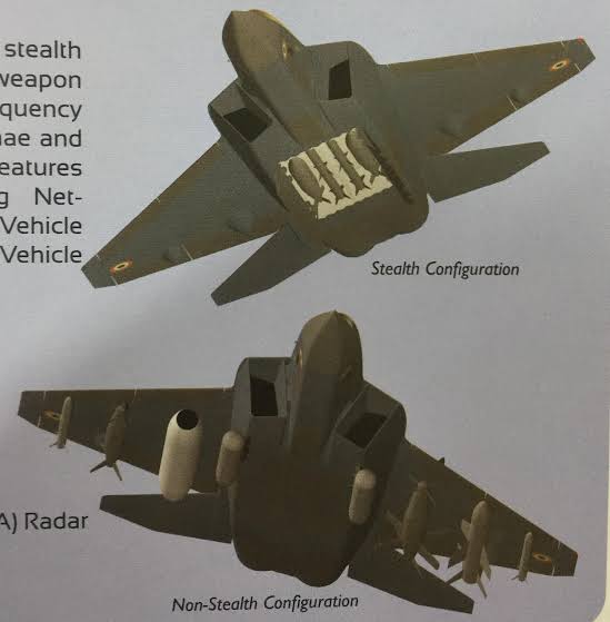

Only worry is the small internal weapons bay, limited weaponry unlike non- stealthy current birds who carry a heavier payload. There are also no underwing bays for WVR missiles shown in the models unlike in some other stealth birds.The twin tails also look extra large and would certainly increase its signature unless canted outwards even more.
Not having arrived as yet BMos- NG, smaller and lighter should be carried by the AMCA internally.Would it fit into the internal bay?
Posts: 14763
Re: Advanced Medium Combat Aircraft: News & Discussion - 30 August 2019
Philip, there 2 seperate compartments in the design at the side of Engine inlet for CCM's like F-22

Aditya_V wrote:Philip, there 2 seperate compartments in the design at the side of Engine inlet for CCM's like F-22
I really doubt this, they have always only shown the single compartment (bomb bay).

8 weapon points ( but pics show 12?)

My estimate
Empty weigth 12T
Internal fuel 6T
Internal payload 1.5T
Clean MTOW 20T(Stealth)
External payload 5T
MTOW 25T
So that it has same range capability to replace Su 30 mki in stealth mode as same fuel fraction.
The above estimate is based on infoboard at a recent exibition where only internal fuel and internal payload was not specified.
The internal payload of 1.5T is estimated as the photographs show estimated 2*500kg JDAMs and 2* 250 kg class AAM and also in many infoboard the internal payload given as 1.5 T.
