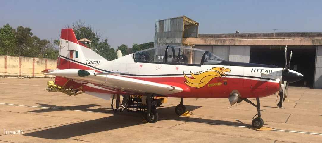

HTT-40 BTA @ Aero India 2017
Photograph below is courtesy of ---> https://twitter.com/akananth?lang=en
