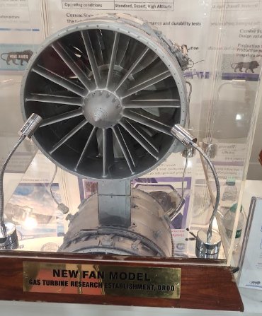

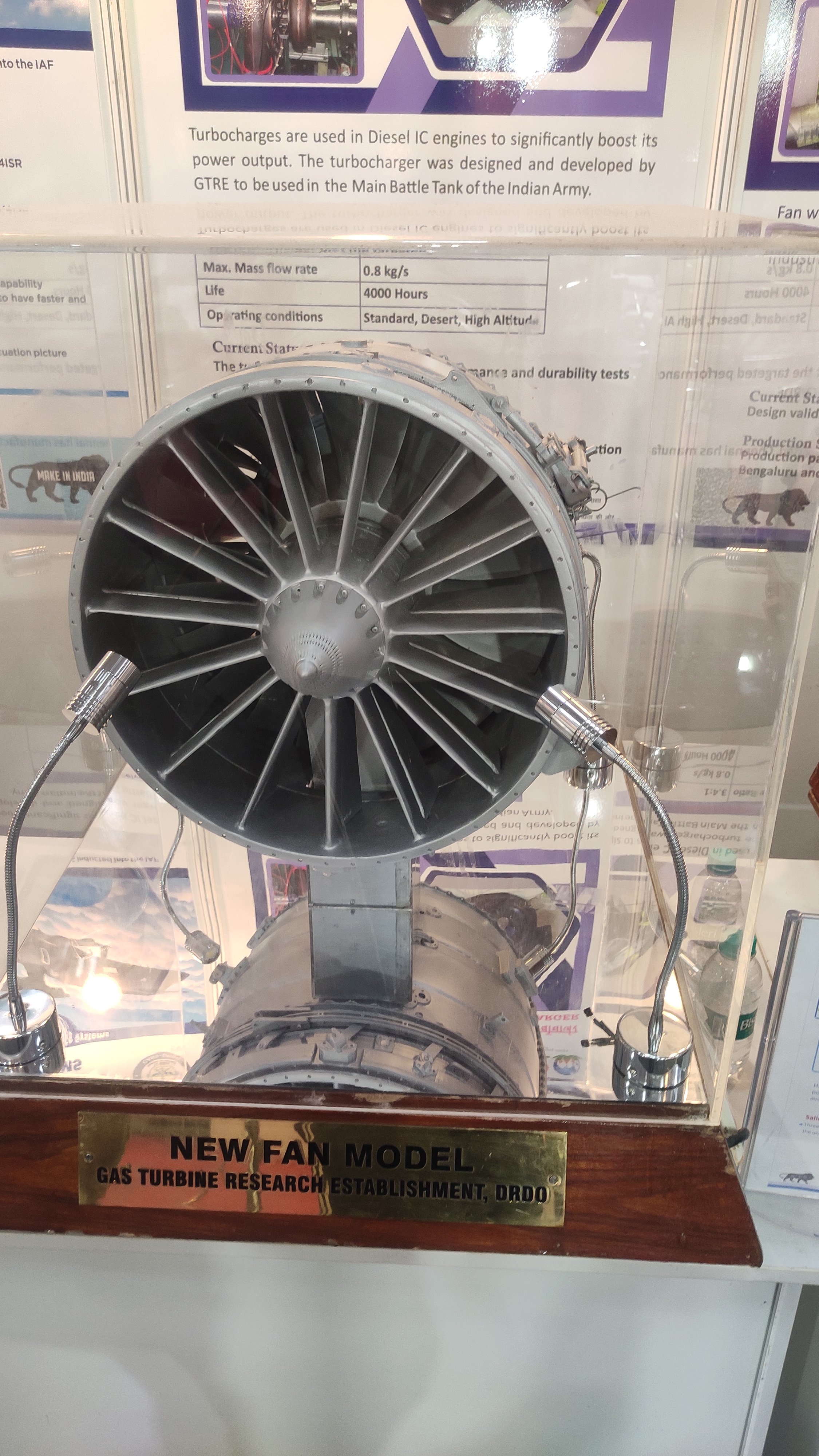

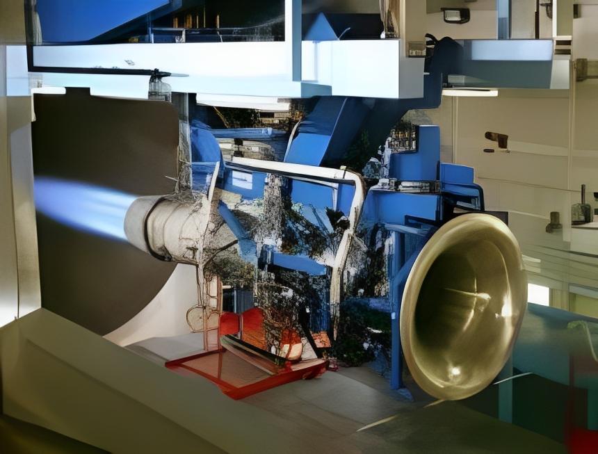

https://twitter.com/Varun55484761/statu ... 16929?s=20 ---> Dry Kaveri's new fan. Two prototypes of dry Kaveri were fabricated. One engine sent for high altitude testing at Russia & other engine is under testing at GTRE. Initial flight release certification is around 2024. After IFR certification, limited flight test starting possibly on Tejas.
https://twitter.com/Varun55484761/statu ... 18713?s=20 ---> Eight more dry Kaveri under manufacturing. Dry Kaveri may get a new afterburner. Currently no takers for such an engine. Hope it will also happen. Picture owner @RETHIK5706.

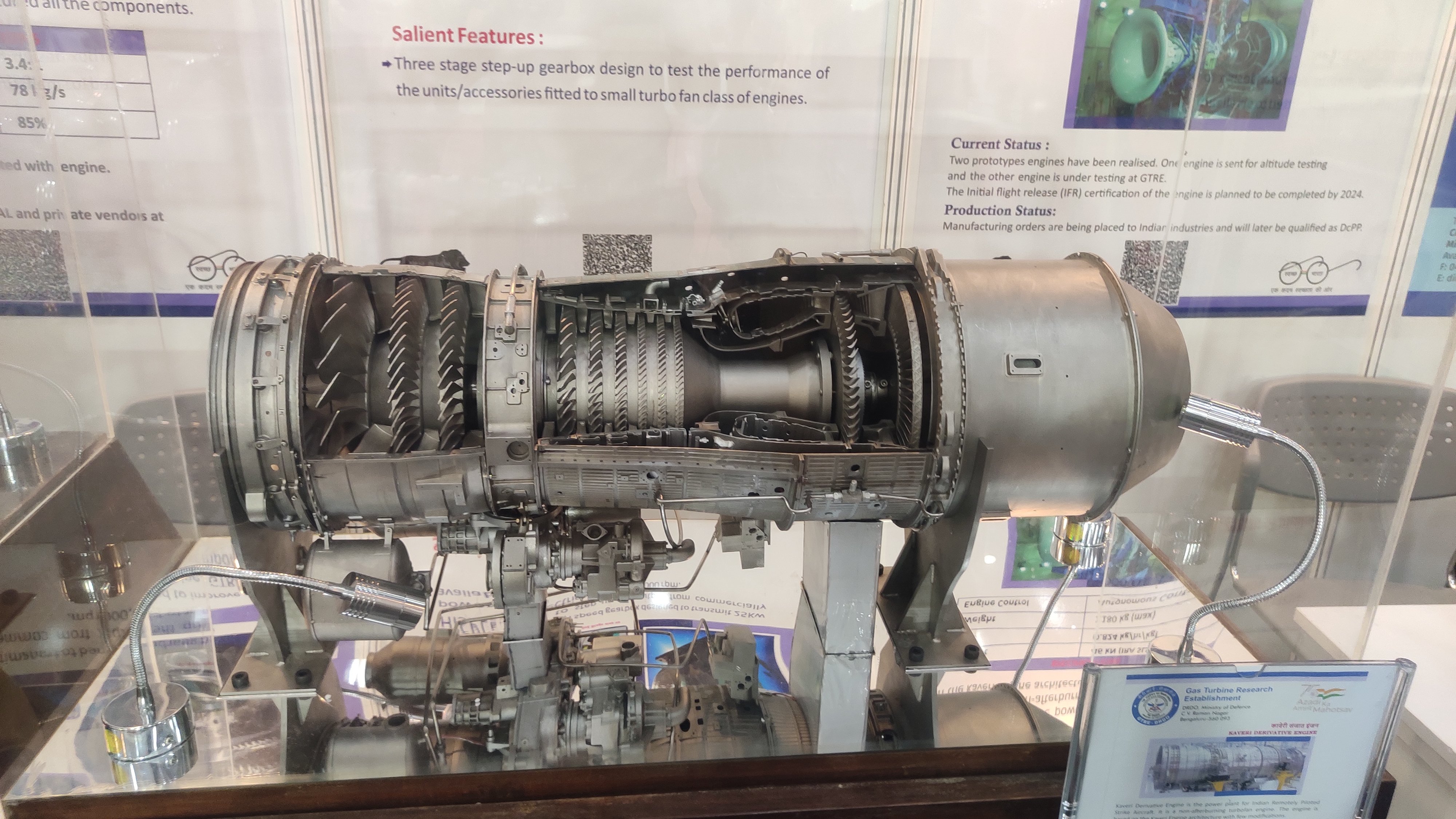

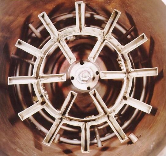

* V-Gutter of GTRE Kaveri Engine. The V-Gutter is for stabilisation of the flame during reheat.
AFAIK, DRDO studying methods to cool V-Gutter to improve creep life. This is for a fifth generation aero engine.

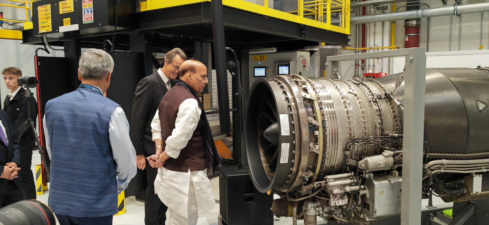

Interesting news - this Ginnevilliers site is where Safran recently (2019-20) opened a turbine blade research center ... Safran dedicates new facility to turbine blade research
<snip>
The manufacturer says that the facility is capable of carrying out "all development work necessary for next-generation very-high-performance turbine blades" for military and commercial engines on fixed- and rotary-wing aircraft.
... multi-disciplinary design, single-crystal casting, 3D-printed ceramic blade cores, thermal coatings, cooling circuits, digitised processes, self-adapting micro-drilling, and non-destructive testing based on artificial intelligence, Safran says ...
One project is to develop enhanced blades for the Snecma M88 engines that power Dassault Rafale fighters ...
Hmmm, something's cooking - didn't the DRDO chief recently visited this same site recently?

@ maitya-ji, is that a scale model of a turbine blade in the Raksha Mantri's hands? ---> https://grabcad.com/library/aube-reacto ... ne-blade-1
https://x.com/SafranEngines/status/1712 ... 16611?s=20 ---> Honored to welcome today @rajnathsingh, Defence Minister of India at our Gennevilliers site where key parts of the M88 are produced. We recalled on our strong cooperation with Indian Defense industry and reaffirmed our commitment to co-develop a new fighter engine to power the AMCA.

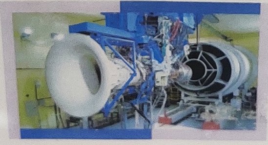

Posts: 21211

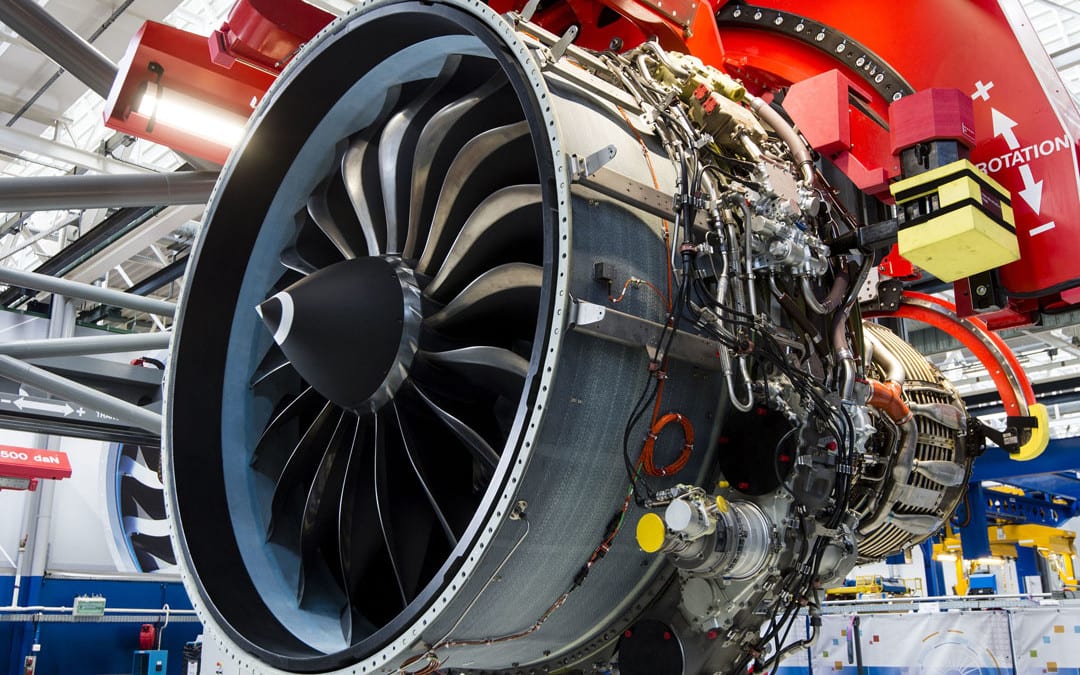

https://x.com/Defencematrix1/status/171 ... 23835?s=20 ---> GE F414 on a test stand in India, at the HAL Tarmac for ADA. In the background, the Mobile Engine Test Facility for the LCA is visible. These systems (and this image) are by @AIPL_INDIA
