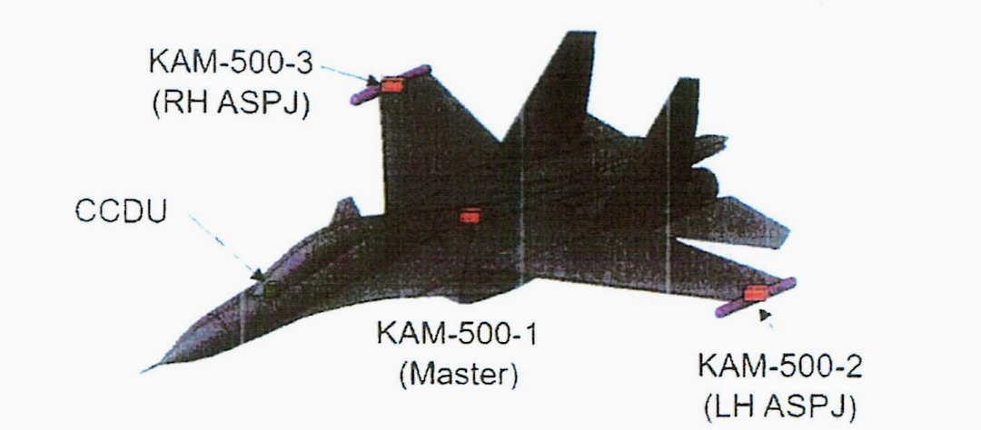

https://x.com/alpha_defense/status/1734 ... 91175?s=20 ---> UPDATE:
+ CASDIC (Combat Aircraft Systems Development & Integration Center) had proposed an indigenous EW suite consisting of internal RWR and a podded jammer system in the form of LH & RH ASPJ pods. HAL Nashik has carried out the detailed feasibility study for integration of the EW suite on the Su-30MKI. This activity has been completed on 30 June 2023.
+ CASDIC has submitted the proposal for the EW suite on the Su-30MKI to Air HQ. The process of initiation of AON (Acceptance of Necessity) for the sanction of a project for the same has been initiated by Air HQ.
+ It is proposed to take up the detail design activities for installation of an EW suite on the Su-30MKI based on the feasibility study report.

https://x.com/alpha_defense/status/1744 ... 24143?s=20 --->
- Integrated EW Suite "Navachakshu".
- Rudram-2 (a&b), Astra Mk-1&2, Rudram-3 missiles.
- GaN based AESA radar.
- New Cockpit and Mission Computer
And much more :)
https://x.com/tttt7716/status/1744987380187308396?s=20 ---> What is Rudram-2 a&b?
https://x.com/alpha_defense/status/1745 ... 73369?s=20 ---> One with Anti Radar and other with EO*
*EO (electro-optical)
https://x.com/iam_udit_t/status/1744961 ... 90320?s=20 ---> DR118 Dhruti RWR?
https://x.com/alpha_defense/status/1745 ... 99816?s=20 ---> Next Generation RWR
