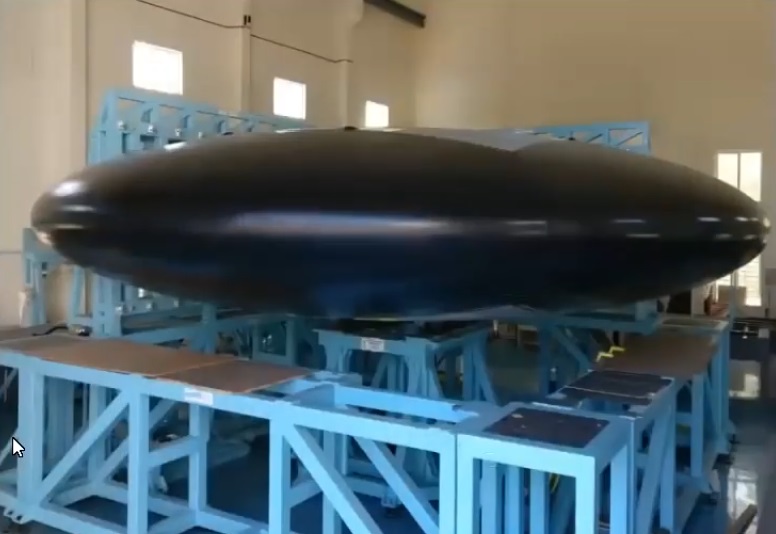

https://twitter.com/DefenceDecode/statu ... 65760?s=20 ---> India is going to make 6 new Airborne Early Warning and Control planes, to be developed by DRDO on aircraft from Air India. Under a ₹10,500 crore project, six AEW&C Block 2 aircraft would be acquired from Air India and modified to fly with a 360-degree panel radar.
https://twitter.com/DefenceDecode/statu ... 86275?s=20 ---> The six AEW&C Block 2 planes would be highly capable than NETRA plane and provide 360-degree coverage deep inside the enemy territory during missions. The government is expected to clear the project soon.
https://twitter.com/Amitraaz/status/133 ... 69733?s=20 ---> Dome structure of CABS 360 degree AWACS radar panel.
