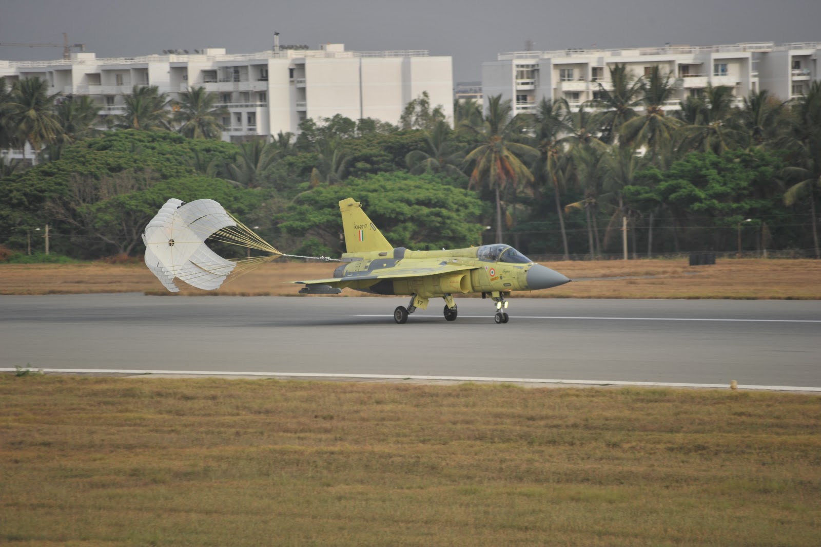

krishnan wrote:http://ians.in/stories/2013/Dec/19/DEB_4172.JPG
Hi.Res close up photo of LCA
What is/was under the starboard intake?

That's under the port intake. The orange thing under the starboard one is probably a camera.
Posts: 19237
Re: LCA News and Discussions, 22-Oct-2013
yes, you are right, a camera bracket - with no camera in it.

ArmenT wrote: That aux intake/depressurization cock panel seems to have taken a beating -- it has a crumpled look to it. Any ideas what could have caused it?
There also seem to be some paint chips missing in the other pictures (you can see the yellow primer underneath), but that is to be expected from an airframe that is regularly flying.
That particular panel is an ideal candidate for switching to composite. It appears to be fairing out the aux intake and not have a structural role. Maybe have a titanium or CFRP leading edge around the intake to account for bird strike with the rest being GFRP.
Just guessing here, but the panel looks like fabricated hastily and might be something for which an alternate design is planned downstream.
That intake has already been replaced with a new design. Check LSP-7 and LSP-8.

The crumpled intake was LSP-5

perhaps the learning should feed back into future mk-2 models where they can avoid even the bulge and make it more blended.
