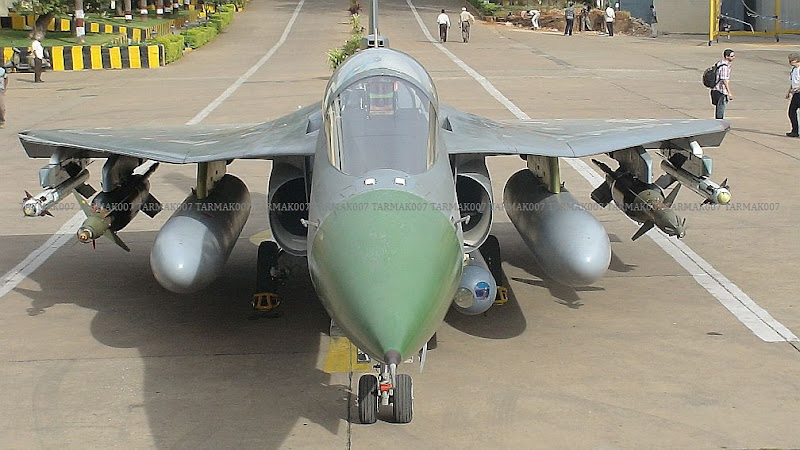

I believe that pic is old.. not the current IFR probe bolted one..

srai wrote:^^^
Since you asked ... reposting my old post on various load configurations:
Combat Air Support (CAS)
CAS (w/ two 800L tanks & 1,000lb bombs) (mostly seen in this config)
  • 2 x CCM (231lb x 2)
  • 2 x 1,000lb bomb (LGB/PGM/Dumb) (1,000lb x 2)
  • 2 x 800L external fuel tank (211gallon x 8.35lb x 2)
  • 1 x Liten Pod (440lb x 1)
Total Payload Weight (external): 6,425.7lb (2,914.7kg)
CAS (w/ two 800L tanks & two lighter bombs)
  • 2 x 250kg bomb (LGB/PGM/Dumb) (500lb x 2)
Total Weight (external): 5,425.7lb (2,461.05kg)
CAS (w/ two 800L tanks and one bomb)
  • 1 x 1,000lb bomb (LGB/PGM/Dumb) centerline (1,000lb x 1) (could carry a heavier weapon like ASM)
Total Payload Weight (external): 5,425.7lb (2,461.05kg)
CAS (w/ two 1200L tanks and one bomb for max range strike)
  • 2 x 1,200L external fuel tank (317gallon x 8.35lb x 2)
Total Payload Weight (external): 7,195.9lb (3,264kg)
CAS (w/ two 1200L tanks and two light bombs for range)
Total Weight (external): 7,195.9lb (3,264kg)
CAS (w/ one 725L centerline and four 1,000lb bombs)
  • 4 x 1,000lb bomb (Dumb) (1,000lb x 4)
  • 1 x 725L external fuel tank (192gallon x 8.35lb x 1)
Total Payload Weight (external): 6,065.2lb (2,751.1kg)
CAS (w/ one 725L centerline + Liten Pod)
Total Payload Weight (external): 6,505.2lb (2,950.7kg)
CAS (w/ no external tanks and two 1,000lb bombs for short range strike)
Total Payload Weight (external): 2,902lb (1,316.32kg)
CAS (w/ no external tanks and four 1,000lb bombs for short range strike)
  • 4 x 1,000lb bomb (LGB/PGM/Dumb) (1,000lb x 4)
Total Payload Weight (external): 4,902lb (2,223.51kg)
CAS (w/ no external tanks and max bomb load of five 1,000lb bombs)
  • 5 x 1,000lb bomb (LGB/PGM/Dumb) (1,000lb x 5)
Total Payload Weight (external): 5,902lb (2,677.10kg)
CAS (w/ two 800L tanks, 725L centerline & 1,000lb bombs)
Total Payload Weight (external): 8,028.9lb (3,641.85kg) [if fuel tanks filled to maximum]
Others to consider:
* Other load configurations would be 250kg bombs carried in multi-racks for carpet bombing.
* Heavier PGMs
Combat Air Patrol (CAP)
CAP (w/ no external tanks and 4 AAMs)
  • 2 x BVR (Derby/Astra) (441lb x 2)
Total Payload Weight (external): 1,344lb (609.62kg)
CAP (w/ no external tanks and 6 AAMs)
  • 4 x BVR (Derby/Astra) (441lb x 4)
Total Payload Weight (external): 2,226lb (1,009.69kg)
CAP (w/725L centerline and 6 AAMs)
Total Payload Weight (external): 3,829.2lb (1,736.9kg)
CAP (w/ two 800L tanks and 4 AAMs)
Total Payload Weight (external): 7,195.9lb (2,207.95kg)
CAP (w/ two 1200L for long-range)
  • 2 x BVR (Derby/Astra/R-77) (441lb x 2)
Total Payload Weight (external): 6,637.9lb (3,010.9kg)
In one of the MoD reports, max combat radius was stated as around 500km. But that would mean shorter time-on-station at those max ranges. Probably 350km is more of an ideal range with sufficient time-on-station.
Oh yeah ... add the AAR capability too ;)
Thanks. Very impressive. My question was actually much simpler: 3 fuel tanks--what is the range with the maximum armament payload? 250 miles/500miles etc?
member_22539
Posts: 2022
Re: LCA Tejas: News and Discussions
Post by member_22539 »
ramana wrote:RamaY is pointing that out.
I knew what he was pointing out (sorry if it seemed like I was misunderstanding him). I was just pointing out that the capabilities are similar, so why should we opt for the foreign bird as opposed to one of our own.
Cosmo_R wrote:... My question was actually much simpler: 3 fuel tanks--what is the range with the maximum armament payload? 250 miles/500miles etc?
Vivek's performance graph plots paylod-to-range with various internal/external fuel combo:
So if we were to take one of the typical config that we have seen, this is what it looks to be:
CAS (w/ two 800L tanks & 1,000lb bombs) (typical "max" config)
At sea-level, one-way range would be roughly 900km (in Vivek's graph it would be between yellow and green lines and around 1000kg weapon payload). So combat-radius (~40% of the range) would be close to 360km.
At 20,000ft above-sea-level (ASL), one-way range would be roughly 1100km (it would be between yellow and green lines and around 1000kg weapon payload). So combat-radius (~40% of the range) would be close to 440km.
Let's look at one of the air-to-air configs:
At sea-level, one-way range would be roughly 1000km (in Vivek's graph it would be between yellow and green lines and around 600kg weapon payload). So combat-radius (~40% of the range) would be close to 400km.
At 20,000ft above-sea-level (ASL), one-way range would be roughly 1200km (it would be between yellow and green lines and around 600kg weapon payload). So combat-radius (~40% of the range) would be close to 480km.
Now to your question with 3 fuel tanks:
Total Payload Weight (external): 8,028.9lb (3,641.85kg) [if fuel tanks filled to maximum; exceeds 3500kg payload capacity so let's assume some external tanks not filled to maximum capacity. Or let's assume instead of 1,000lb bombs it is 500lb bombs.]
At sea-level, one-way range would be roughly 1100km (it would be between yellow and green lines and around 1000kg weapon payload). So combat-radius (~40% of the range) would be close to 440km.
At 20,000ft above-sea-level (ASL), one-way range would be roughly 1300km (it would be between yellow and green lines and around 500kg-1000kg weapon payload). So combat-radius (~40% of the range) would be close to 520km.
So let's look at what does that 300km-to-500km range of LCA mean in terms of reach, which would be similar to that of Prithvi-2 SSM:
