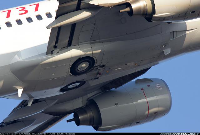

This layout also removes the option of the wheel with a hubcap forming the conforming surface (like in the 737s or the Grob G120) and its accompanying weight savings.
But then, the Kirans seem to have done fine with this layout and no covers for the wheel well at all.
On the 737, the hub cap forming the wheel door is only because it is absolutely flush with the rest of the wing. Otherwise, this is a definite drag riser. On the Kiran I was initially surprised that they haven't bothered to put a hinged wheel well cover door to completely close the gap. Negligible weight increase but a definite drag reduction is what I thought, till I found another pic of the Kiran that shows that the wheel well into which the tyre fits upon retraction, is very shallow.
The strut itself is covered by a panel that is attached to it and covers it upon retraction.

A post from much earlier:
Kartik wrote:
indranilroy wrote:The placement of the exhaust has nothing to do with the airplane designers, but everything to do with the design of the engine fitted into the plane. When the mockup was shown in AeroIndia11, they had planned to go with a PT6A which has the exhaust on the sides. However, during the course of the final design, they chose the TPE331-12B engine which has its exhaust at the bottom. I leave it to interested members to learn why the TPE331-12 series,14 series etc. have the exhaust at the bottom.
And no, the exhaust warming up the tyres is a non-issue. I have never come across this.
well, I've come up against an issue with ECS pack causing overheating of panels, which was only noticed during a very late phase of the design. led to a heck of a lot of rework. So, these things can happen. But seeing the Shorts Tucano as per your last post did make it appear that this particular exhaust placement may probably be a non-issue. Which would be good, since any re-design would lead to added time to the schedule.
Shiv saab, tyres can burst due to excessive heat. But maybe the wash from the propeller diffuses the heat, so it may not be an issue at all in service.
Anyways, I have said what I needed to say. I will see myself out of this discussion.
