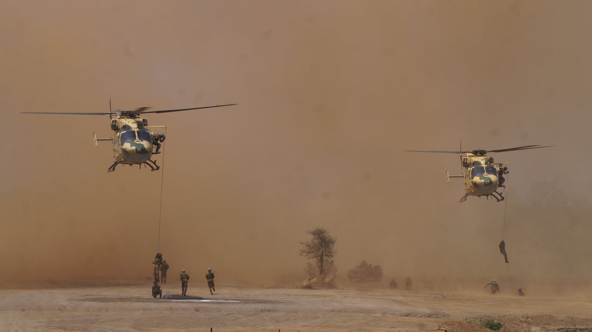

Just to confirm Indranil's chaiwalla account - 2 pers at a time, 300kg, indeed the limit for ALH.
Army knows what went wrong from their side (might not have stopped failure of that component IMO but definitely would have stopped the fall of Soldiers). I expect hole would be plugged soon enough from their side. We can expect the same from HAL once the loopholes on their side are zeroed upon.

One thing is perplexing from IA side, is why earlier the rope would be attached to multiple points while now it was not..? Was it lapse in SOP..? Was the SOP changed...? One can never go wrong with a backup. Or was it there, but even second attachment point also failed..? very unlikely.
There is one more thing - in some pics I can see a thin thing attached to the boom somewhere in between and going back attaching the heli frame somewhere (see in image posted by hnair, next to head of the soldier standing in the door). While other pics do not show that. What is that thing..?
PS: This image shows some more details. The rope is bound around boom and goes on to attach to Heli floor from the back of the boom. Also that thin link at the bottom of the boom attaching to the heli roof. (open image separately and zoom))
In the accident video, it doesn’t seem like the rope was attached to the cabin. If it was, one would expect to see a break in the fall (even if that cabin rope attachment failed). But in the video, there is no such “break” moment from what I can tell.
Two outcomes from this would be SOP to make sure that safety rope is securely tied to the cabin (if it hadn’t been attached that is) and to strengthen the cabin attachment point (if it had been attached but it also failed easily).
