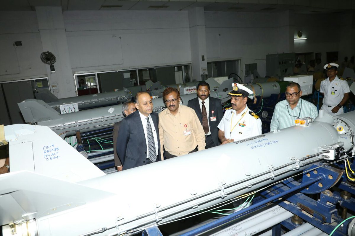

Are those navy guys milling around the missile in white? Navy interested in Akash?
Re: Indian Missiles News and Discussions - May 2017
Interesting indeed. especially now that the Akash NG is going to be canisterized. Slim chances though. I would expect them to be really interested in QRSAM.

^^^^ The above picture of Akash SAM is part of this series below...
https://twitter.com/VUBhaskarCMDbdl/sta ... 3142706176 --> Dr Ajay Kumar, Secretary (Defence Production) inaugurated additional integration facility for production of Long Range Surface to Air Missiles (LRSAM) at BDL, Kanchanbagh Unit, Hyderabad

That doesn't look like akash to me.. I could be wrong..

Cybaru wrote:That doesn't look like akash to me.. I could be wrong..
As Rakesh noted it's lr sam.

Rakesh wrote:https://twitter.com/strategic_front/sta ... 0721549312 ---> Akash SR-SAM assembly at BDL
Looks like MRSAM/Barak8. Might explain men in whites. But confusing fin tips. MRSAM has pointier tips, IIRC. So it might be Akash without the air intakes assembled.
There is no question that it is Akash.

^^ It's Akasha. Those steel pipes are actuators for tail fin. MRSAM has folding, all moving fins.

Indranil wrote:There is no question that it is Akash.
Intakes are missing which is rather strange I would assume it is assembled with the missile.
I like the fact that they made sure nothing else in the facility is shown other than what's in the focus. Have they switched the lights off or is it just the camera flash effect?
Looking at the mijjile.
1. I see what appears as control rods (actuator on right side) to drive the c0ntrol fins. Appears aerodynamically unprotected suggesting it will receive a shroud.
2. Near stage coupling, looks like jet exhaust ports. For post launch reorientation?
3. The main stage can be seen in background above the heads.
Rakesh wrote: Image
Haridas wrote:Looking at the mijjile.
Yes they are indeed control rods. On the actual missile they are protected under a fairing. It will be interesting to see if they retain this in the Akash NG. NG will be canisterized, so may be they will move to smaller folding all-moving wings. Also now they have now developed various compact rotary fin actuation systems. So it will be interesting to see if they retain this method of actuation using push-pull control rods.
Haridas wrote: 2. Near stage coupling, looks like jet exhaust ports. For post launch reorientation?
No sir, there is no motor ahead of that part.

Indranil wrote:
Rakesh wrote: Image
OK it is indeed Akash, I was thinking it is some other missile. I had taken so many close up pics of Akash many many yrs ago, and now didn't recognise what it looked under its clothings !
well those things are ram air plumbing in to the chamber, at 90 degrees x4, intake nested between front fins.
Indranil wrote:
Haridas wrote:3. The main stage can be seen in background above the heads.
Could not follow this part. Akash uses an integral ramjet. After the solid-fueled booster grains have burnt out, the cavity left behind forms the combustion chamber for the ramjet engine. In front of the "joint" is the sustainer fuel, control system, warhead and guidance mechanism.
Yaakwaala can confirm but I believe that section has the solid fuel for ram jet. I am told a marvellous design, where controlled amount of partially oxidixed fuel is burnt and fed into jet engine chamber.
