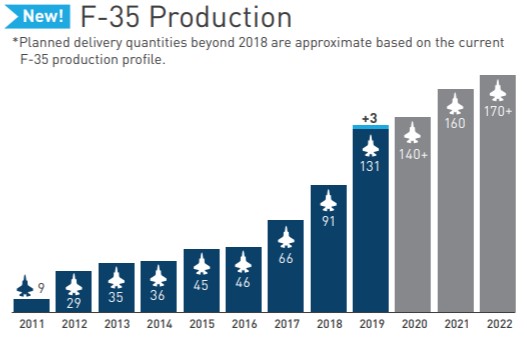

The plant 4 upgrades for the F-35 have enough space, and infrastructure/capacity slack to build 17 aircraft a month. Current program-of-record and future estimates dont really go beyond 177 aircraft a year (Italy and US facilities though that'll change now that Japan is extending production for an additional 100 or so aircraft) so around 150-160 aircraft from plant 4. So there is plenty of flexibility as long as there is a 2 year lead time to build capacity, order equipment and hire workers. They've been doing just that for the last few years with steap production increases every other year. Big production increases (YOY) are now done. From here on it will be small increments of 10-20 aircraft increases per year.ramana wrote:kit thanks.
supratik had found another article that breaks down the mfg plant for F35.
Back in 2015, they were expecting to make 200 in 2019.
16 "mate stations" to bring the major parts of the aircraft body together (forward, center and aft fuselages and aircraft wings
12 positions for final assembly
10 positions for spray paint preparation
https://www.defensedaily.com/lockheed-m ... navy-usmc/

I am interested in seeing how 17 F35/month are being built while HAL barely makes 16 a year.

The F-35 Final Assembly Line Ramps Up
https://sldinfo.com/2017/11/the-f-35-fi ... ing-curve/

ramana guru,ramana wrote:I am interested in seeing how 17 F35/month are being built while HAL barely makes 16 a year.

may be i dont understand your full question, but wont the first step in making such high no. of planes is ordering planes, without orders how can one make planes. The next logical step would be to set up manufacturing facilities. US has done this thing for years from scratch and has at least 2 world beating companies (if i only consider Boeing and Lockheed).
I dont think we can't do it. I am sure there would be desi talent that would be happy to come back to india too for right price if money is paid and is not part of any alphabet soup treaty and can still add values or even desi talent who can do things if given right freedom. heck even china has mass manufactured. Needless to say, you are absolutely right in saying "Something is not right in how MoD, IAF and HAL". I took the tejas program part as it is a systematic problem. We still can get this right if we learn from mistakes of tejas and dont repeat for Mk1A, MWF, AMCA, NLCA, TEDBF, ORCA or whatever we do next..
US is in highest level of robotics in manufacturing, and we can't vouch the same at HAL. Concurrent Engineering practices, and assembly lines are all that matters once a process is established. The right dependency means, enough buffer stocks are available for each LRUs, and rest is pure math.
Also, we need to move away from this advanced jugaad engineering to advanced engineering in productions.

The F-35 article posted by brar_w shows there are non automation measures that reduce the time of production.
Can't go on saying its lack of orders.
maybe they need plant equipment also.
What is HAL doing with in its sphere of influence to speed the production?
They may be burning mid night oil.
I want to know that.

The minute I posted the F-35 article SaiK jumped in with Robotics advantage which turned out to be bokwas.
Kartik visit to Boeing plant attests to that.
