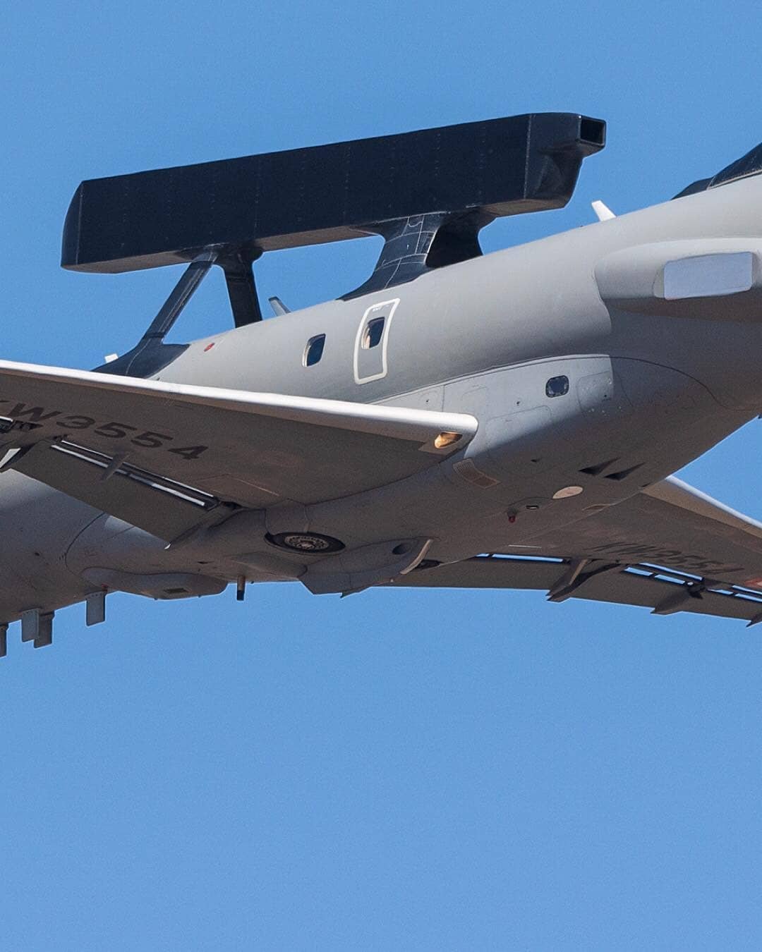

https://twitter.com/Kuntal__biswas/stat ... 88992?s=20 ---> We must admire the beauty that DRDO has produced. The Balakot hero Netra AEW&CS.
Re: Airborne Early Warning & Control: News & Discussion

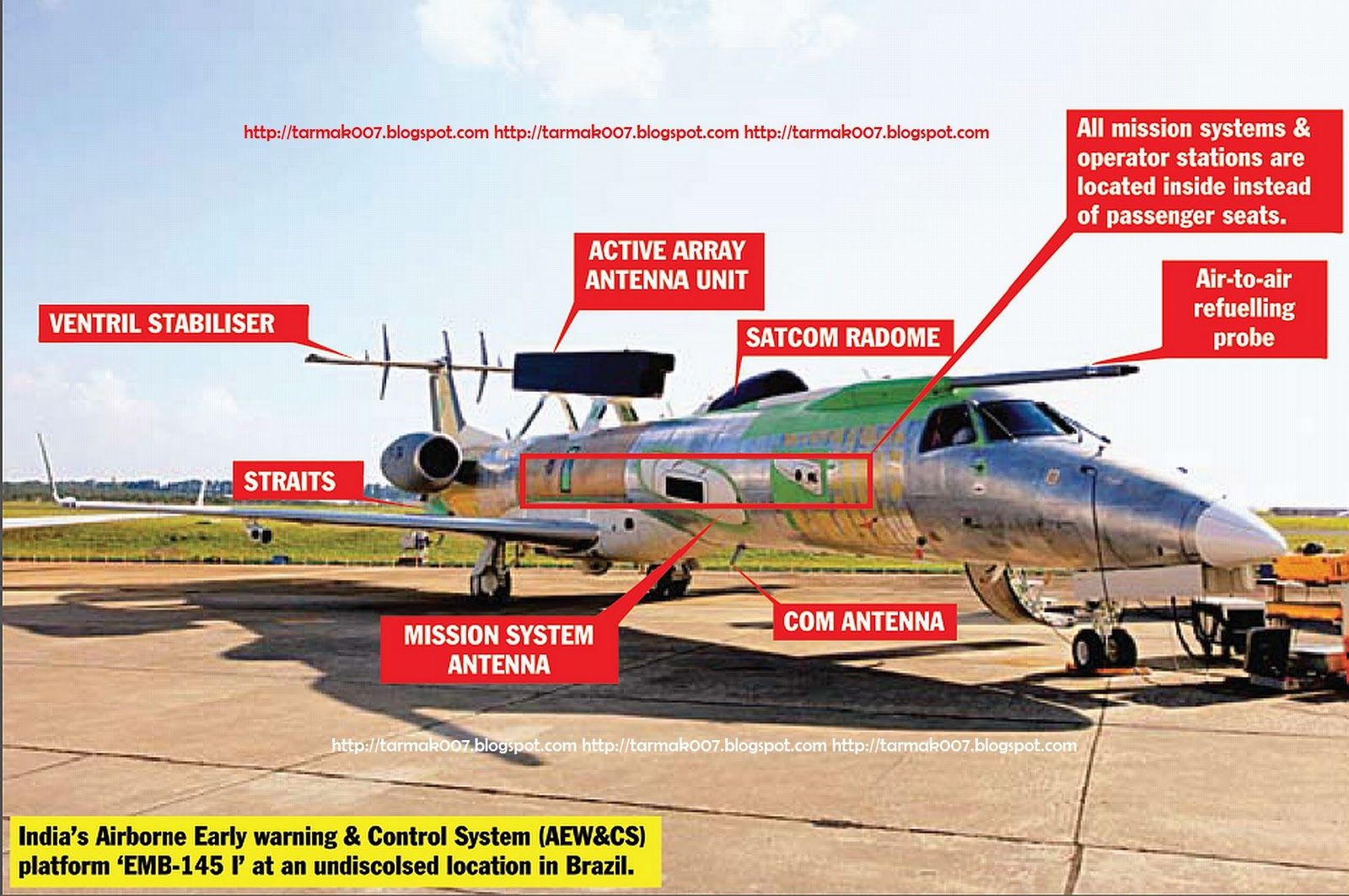

https://twitter.com/strategic_front/sta ... 09984?s=20 ---> The DRDO AEW&CS has a 360 degree self protection suite of MAWS, RWR & countermeasures. It can pick up targets ~500 km away. There is SATCOM & datalinks to pass on ESM, CSM, Radar data to ground stations & fighters. 40+ aircraft can be linked by DRDO AEW&CS NETRA. (Credit on pic).
Is there an aerodynamic reason for the main antenna to be tilted forward instead of being perfectly horizontal?
- Posts: 10369
- Joined: 31 May 2004 11:31
It may have to do with beam forming of the phased array panels. I don't think it will ever be public knowledge about the beam pattern and geometry. The question about a smaller platform is how tight can they form the beam and get adequate clutter rejection.nachiket wrote:Is there an aerodynamic reason for the main antenna to be tilted forward instead of being perfectly horizontal?
The Saab Erieye too has a similar forward tilt to the antenna unit although less pronounced.
