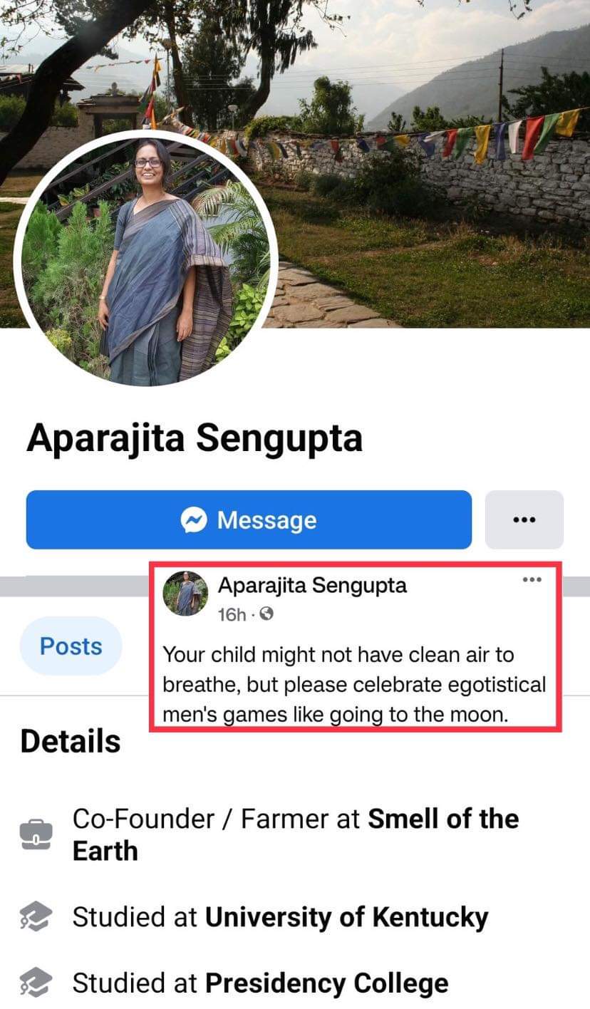

For this commie bimbo 'farmer' at Smell of the Earth, let her go celebrate her egotistical self by constantly sniffing manure laden soil and methane farts from bovines. Hey you never know, the sh*t that she has been constantly inhaling has probably found its way to her brain.
