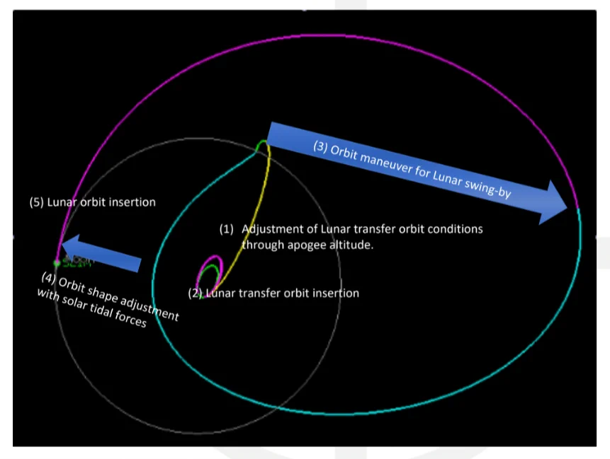

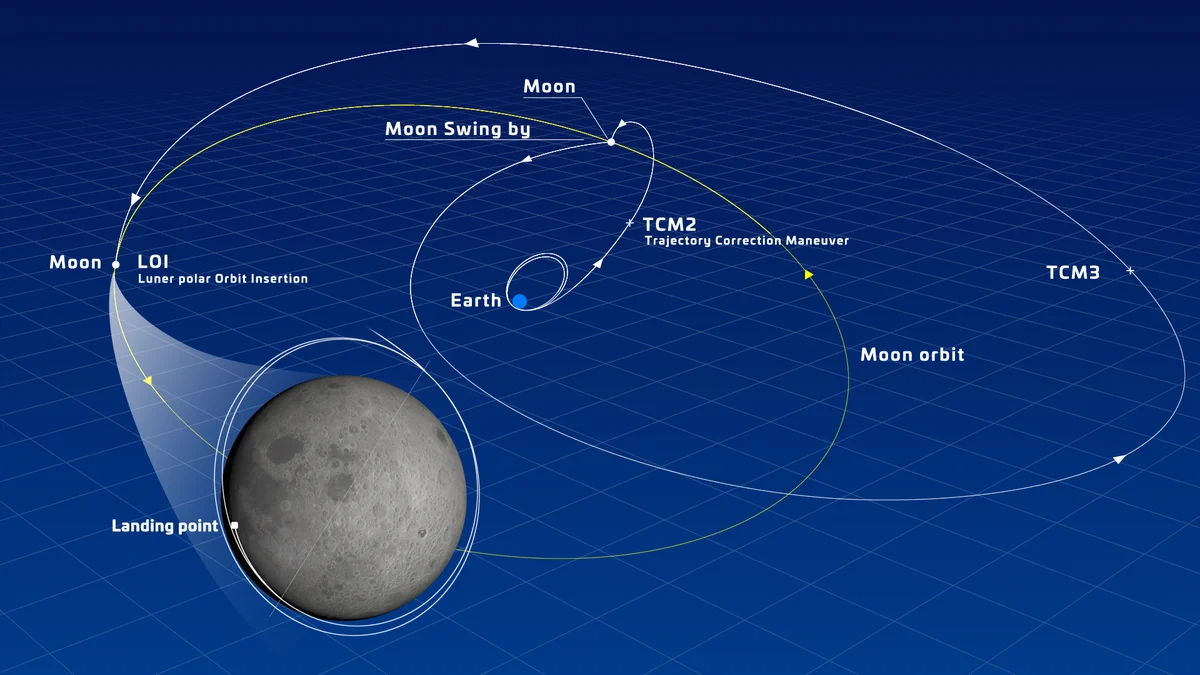

Amber G. wrote: 27 Aug 2023 20:15 Meanwhile:
Japan's lunar lander which will be launching tomorrow (28 August) at 5:56am (IST).
The lander named SLIM(Smart Lander for Investigating Moon) will demonstrate high precision pinpoint landing for future missions like 🇮🇳🇯🇵LUPEX.
Just few hours wait..
SLIM also has a very efficient transfer trajectory to moon. It will be launched onboard a Mitsubishi H2A rocket as a rideshare along with the X-ray telescope XRISM.
(See figures below -- after first swing by to the moon, it will go much farther than moon's orbit and at the return perigee will be captured by the moon - Look the orbits carefully)...the paths are quite different than CY3) Longer path takes longer time but more fuel efficient...
SLIM will take few months to reach and then spend 1 month in lunar orbit before landing (~6 months total).
(will be happy to answer if there are questions about orbits )
SLIM is also carrying 2 LEVs(Lunar Excursion Vehicles). One is a hopper(LEV-1) and the other is a rover(LEV-2), both very compact and light weight.
Both will be ejected onto the surface when SLIM is few meters above the surface before touchdown.
LEV-1 is 2.1kg with dimensions of 26*40*30cm.
LEV-2 is manufactured by toy maker and is 250grams with a spherical shape of 80mm diameter.
Sources: https://www.isas.jaxa.jp/home/slim/SLIM/index.html
https://cosmos.isas.jaxa.jp/20-minutes- ... r-surface/
Good luck to them..

Good news in the days of fast computers and better understanding of planets gravitational fields, they don't have to wait for months or years for the next launch window... (For perspective, in Apollo 11 case, if the launch window would have been missed the next window would not have arrived for several months/year -- they would have used Apollo 12's window... These orbit calculations are pretty complex .. used to take months of computer time in 60's)
One thing fascinates me - see the orbit/path .. (I posted here )... see how SLIM goes around moon for the first time - slingshots to 2-3 times far away from the moon and catches it back near the perigee ... slow and study --- 4-5 months to reach the target and travels a long distance but saves the fuel..

Re: JAXA mission SLIM/XRISM launch aborted
Amber G. wrote: 28 Aug 2023 21:19 Good news in the days of fast computers and better understanding of planets gravitational fields, they don't have to wait for months or years for the next launch window... (For perspective, in Apollo 11 case, if the launch window would have been missed the next window would not have arrived for several months/year -- they would have used Apollo 12's window... These orbit calculations are pretty complex .. used to take months of computer time in 60's)
So I wonder how much more they're paying for the additional operations time, just to save on some small amount of fuel.
I thought Japan has plenty of lift capacity to spare with its H-2A and now even H-3 rockets.
Japan doesn't optimize for costs, it seems. Their rockets are very mass-efficient, with the highest amount of composites. But they're expensive as well.
I look forward to India's next Moon mission, which will be done as a collaboration with Japan. India is only providing the land, while Japan is providing the launch vehicle and the rover that will roll around on the Moon. That mission is being called LUPEX (Lunar Polar Exploration), and will also look for lunar water.
Amber G. wrote: 29 Aug 2023 04:06 Make no mistake it is BIG, VERY BIG deal..it is not just "small amount of fuel" .. it is about the ability of sending a space probe of desired payload (mass) to a destination which would not be possible otherwise -- even with a much bigger rocket.!!
WIkipedia says the mass of the Japanese spacecraft is 590kg. https://en.wikipedia.org/wiki/Smart_Lan ... ating_Moon
Meanwhile Chandrayaan-3 had total weight of 3900kg.
SLIM's overall development cost is estimated at roughly 15 billion yen ($102 million). So pretty cheap by Japanese standards.
For perspective, let me just give a small example: All probes to outer planets like Pioneer, Voyager 1, Voyager 2 etc had very complicated trajectories... many even went to Venus (for gravity assist), took help from Jupiter on their way to Saturn etc...
Voyager 2 used Venus for gravity assists. TWICE!! It conducted two separate Venus gravity assists in 1979 to set up its trajectory for encounters with Jupiter and Saturn!
And timing was such, the planners, requested to hurry up and passing of the budget and approval of the plan , because if they missed the window, next such alignment will not happen at least for the next 10 years!
That was with SATURN rockets -- very powerful ones. (Even the most powerful rockets on the earth would not be sufficient for such a mission without such a long/ calculated planned trajectories if one is sending even a small payload to outer planets.
For this reason, I'm a fan of NASA's Deep Space 1 mission, which used xenon ion-thruster propulsion, which greatly reduced the propellant mass.
The NASA people said Deep Space 1 with its ion propulsion handled "like a dream".
For Moon mission, if we are lucky to get more powerful rockets, we can cut the elapse time... we can also increase pay load significantly by using smart fuel efficient trajectories. Spending extra few months may not be that important...
This is why many of us are very impressed with ISRO's magic in planning the trajectory . and near perfect execution ....no small feet. (Same with SLIM's trajectory -- would be intersting to see the execution)
ESA's Smart-1 mission also flew to the Moon using ion thrust propulsion. I wonder if ISRO might see benefit in using ion thrust to get to the Moon?
