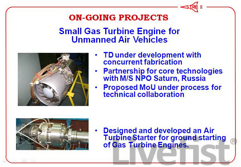

rajsunder
Posts: 877
Joined: 01 Jul 2006 02:38
Location: MASA Land
Re: Kaveri & aero-engine discussion
Post by rajsunder »
nukavarapu wrote:Finally the speculation ends. Aroor confirms with a slide:
http://3.bp.blogspot.com/_o_no4M2xEPY/T ... 0/GTRE.JPG
Notable Points:
-TD under development with concurrent fabrication
-Partnership for core technologies with NPO saturn
-Proposed MoU under process for technical collaboration
From the above link it also says that they have developed a Air turbine starter for ground staring engines, does this mean that if they have to restart engines in the middle of flight that it cannot be done???
