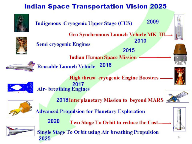

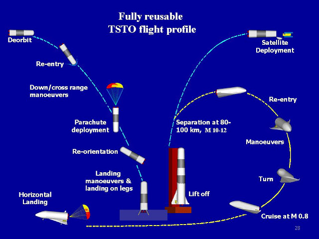

Indian Space Transportation System - Present Scenario and Future Directions
<embed type="application/x-shockwave-flash" src="http://picasaweb.google.com/s/c/bin/slideshow.swf" width="600" height="400" flashvars="host=picasaweb.google.com&hl=en_US&feat=flashalbum&RGB=0x000000&feed=http%3A%2F%2Fpicasaweb.google.com%2Fdata%2Ffeed%2Fapi%2Fuser%2Fcrgkc.r%2Falbumid%2F5491569930285357681%3Falt%3Drss%26kind%3Dphoto%26hl%3Den_US" pluginspage="http://www.macromedia.com/go/getflashplayer"></embed>
Re: Indian Space Program Discussion
Thanks for that!
http://picasaweb.google.com/crgkc.r/Ind ... 5340941554
I found Slides 28 and 34 to be the most informative to me. I'd read about the TSTO before, but I wasn't sure exactly what the flight profile was, and whether TSTO was exactly the same as AVATAR (it's not - it's the precursor - a flyback booster). So based on Slide 34, then AVATAR will be an air-breathing SSTO derivative of the TSTO. The flight profile shown on Slide 28 also shows how the upper stage could be fully reusable as well, making a rocket-powered landing. That would be useful for a mission to the Moon, Mars, Venus, or even Titan or Europa.

nukavarapu wrote:^^^ There is something drastically wrong here. All this time following the news reports etc. etc. the media got me convinced that Avatar/RLV was the upper stage and the reusable booster was the lower stage. These slides have completely confused me now. The articles that showed up in media where all pointing to the Avatar/RLV is the one that will carry the payload, riding on a booster rocket. To make it fully re-usable they were saying about making the booster air-breathing too and the recovery by parachutes and plunging into sea. Now I am really confused!
Well, we can see from Slide 27, that the TSTO has a cryo or semi-cryo rocket engine, and not a scramjet engine, which is what AVATAR is supposed to have ("aerobic")
Then we see in slide 28 that the TSTO lower stage boosts the entire vehicle vertically as a rocket, and simply glides back to Earth, so it's a flyback booster. The upper stage delivers the payload to orbit and then re-enters, parachutes and possibly lands under power like a DC-X, which I find particularly impressive:
Then we see from slide 34 that after the TSTO comes the air-breathing SSTO, which then obviously has to be AVATAR:
So all in all, that's cleared up a lot for me, since I was confusing TSTO with AVATAR, and they are quite different. TSTO is not airbreathing at all, but is simply a reusable flyback booster with a reusable DC-X type of upper stage.

The TSTO concept is quite interesting , I thought ISRO abandoned it for Avtar
Has any country in the world ever operationalized TSTO ?Looks quite unique to me.
From what I see, TSTO is a necessary precursor to the AVATAR SSTO, since TSTO will use conventional rocket engines and not scramjet engines, and it's much more feasible to reach orbit in 2 stages as compared to just 1.
Falcon-1 and Falcon-9 are the newest examples of TSTOs. It's just that they have no flyback booster, and are instead counting on parachuting the lower-stage booster back.
The USAF is going for a flyback booster, as I recently posted in another thread.
What surprised me about ISRO's TSTO was that even the upper stage will be retrieved/reused, landing DC-X or Soyuz style.

Yes TSTO is a nice concept and perhaps a cheaper and technologically less challenging then a SSTO scramjet.Sanjay M wrote:From what I see, TSTO is a necessary precursor to the AVATAR SSTO, since TSTO will use conventional rocket engines and not scramjet engines, and it's much more feasible to reach orbit in 2 stages as compared to just 1.
The Russians too have a similar concept in Biklal booster for Angara SLV the only difference seems to be the glide vehical has a small engine hence it will be a powered flight rather then a glide with just one chance to land. Bikal Booster
