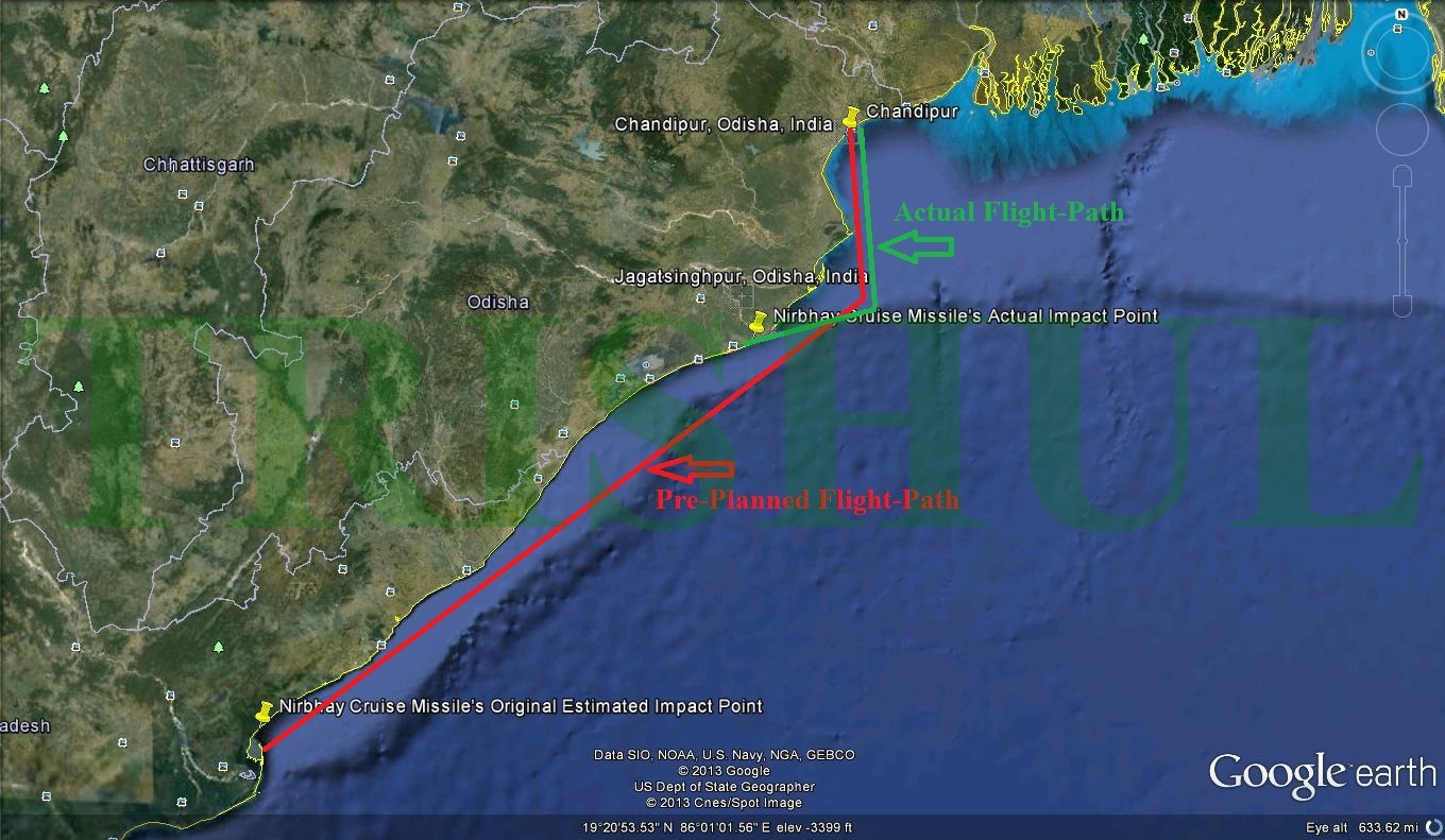

so something happened when it took the turn , it didnt correct itself and kept turning maybe, and they switched off the engine, it kep going and hit the coasts

I am still convinced that flight path not being the usual or calibration was not the problem
One or more transducers failed or it could be one of the linear actuators failed.

some claim the waypoints were not programmed properly. hard to believe but known to happen. planetary landers have crashed because of issues like imperial & metric units used in different parts of the code.

best place for controlled termination would be then on the beach sands/shore lines very close to water.

Prasun Sengupta has made the impact point in the middle of Kakinada port.

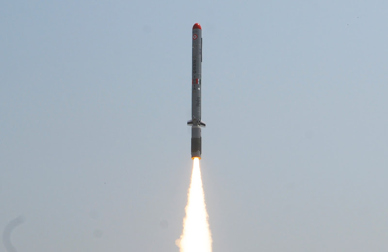

Nirbhay's scorecard:
Ejection from canister: Pass
High-G turns into horizontal flight: Pass
Wing deployment after booster separation and subsequent stabilization: Pass
Philip sir's Russian-rivet test: Fail

Launch video (with a lot of rona-dhona):
[youtube]rvthkQxpJbk&[/youtube]

I believe the missile was crash landed to stick to MTCR regime of less than 300 KM
Re: Indian Missiles and Munitions Discussion
wouldnt the missile navigation unit calculate the most optimal route to destination? Why would waypoints need to be programmed in place like they do for fighter/bomber missions?
Waypoints need to be programmed to take routes that avoid known enemy sam or fighter activity.

why MTCR? does it use a Russian engine or any significant component being imported? the range demonstration in the next test would reveal
btw, the report of next test after 8 months suggests that they have taken current 'mixed bag' test in their stride and sticking to the original test schedule aligning with the viewpoint that this failure was planned or it was not too serious
The coast hugging flight path by the unmentionable forum takes it close to Vizag with a probable end-point at Suryalanka test site? and from the same forum the DSMAC or SAR based navigation sensor isn't integrated yet which means this test was based on INS+GPS? and Uncle can switch off GPS at the right moment like over Vizag. That risk will not be taken even remotely again suggesting a planned 'failure'

Additional details (source:PTI)
'Nirbhay' sub-sonic cruise missile destroyed in flight by India
Even when it quotes DRDO certain portions seem to be the understanding of the reporter and may be inaccurate.The missile, which failed to hit the intended target in the sea, was terminated over the Bay of Bengal after it was airborne for about 25 minutes but crashed on land at some distance from a village near Kendrapara in Odisha, DRDO spokesman Ravi Gupta said. It is unusual for aborted missiles to fall on land.{It was flown over the sea so as to avoid mishaps from falling derbies and was never intended to be recovered on land, either in success or faliure}
There was no loss of life or property, Gupta said, as TV footage showed wreckage of the missile launched from here.
The DRDO while making the announcement, however, said the sub-sonic missile 'Nirbhay' (fearless) with a strike range of around 1,000 km was "successfully" launched and met the basic mission objectives and performed some of the manouveres satisfactorily.
"Nirbhay was successfully launched today at 1150 hrs from launch complex, Chandipur, Odisha, meeting the basic mission objectives successfully.
"After travelling approximately mid-way, deviations were observed from its intended course. Further, flight was terminated to ensure coastal safety," DRDO spokesman Ravi Gupta said in a statement.
The missile blasted off from a mobile launcher positioned in the launch pad¿3 of the Integrated Test Range at Chandipur, about 15 km from here.
The surface-to-surface sub-sonic cruise missile has the capability of being launched from land, sea and air, they said, adding Nirbhay has good loitering capability, good control and guidance, high degree of accuracy in terms of impact and very good stealth features.
Nirbhay was developed by Aeronautical Development Establishment (ADE), a Defence Research and Development Organisation (DRDO) laboratory based in Bangalore is stated to have a strike-range of around 1,000 km.

I know it sounds heretical but DRDO should declare this one as a fail and go back to the drawing board.
But for the grace of God, its deviant flight path and flight termination could have led to population losses.
Shutting down engine is hardly the right flight termination system.
And how does 25 min or 250 km equal half the range when it is stated to be 1000Km.
They should have said we had a flight anomaly during the first test flight and are investigating it.
OK here is my theory.
There are no landing stations on the coast except the missile test range along the chandipur test range coast. I don't know if DRDO actually had an impact point close to Kakinada as mentioned by Prasun Sengupta (who we all know is >95% bakwaas info).
It is possible that the waypoints were planned in a way that after launch from ITR, the missile will fly along the coast, and then make a 180 degree turn and impact back close to ITR Chandipur.
So the DDM's story about the missile returning may be true.
Now if Nirbhay uses terracom guidance also, then there is not much use flying this thing over water right? It needs land and will correlate features with its maps and its waypoints in a 3 dimensional plane.
